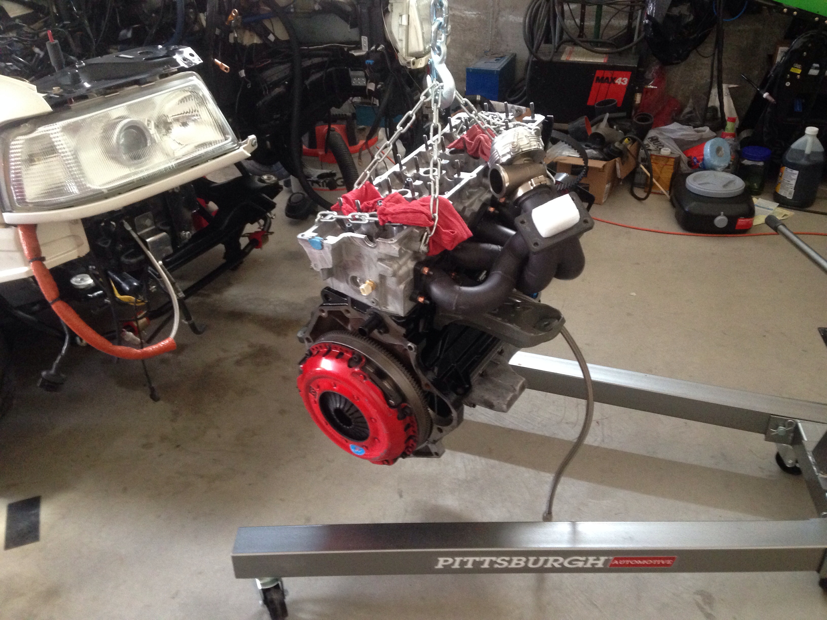

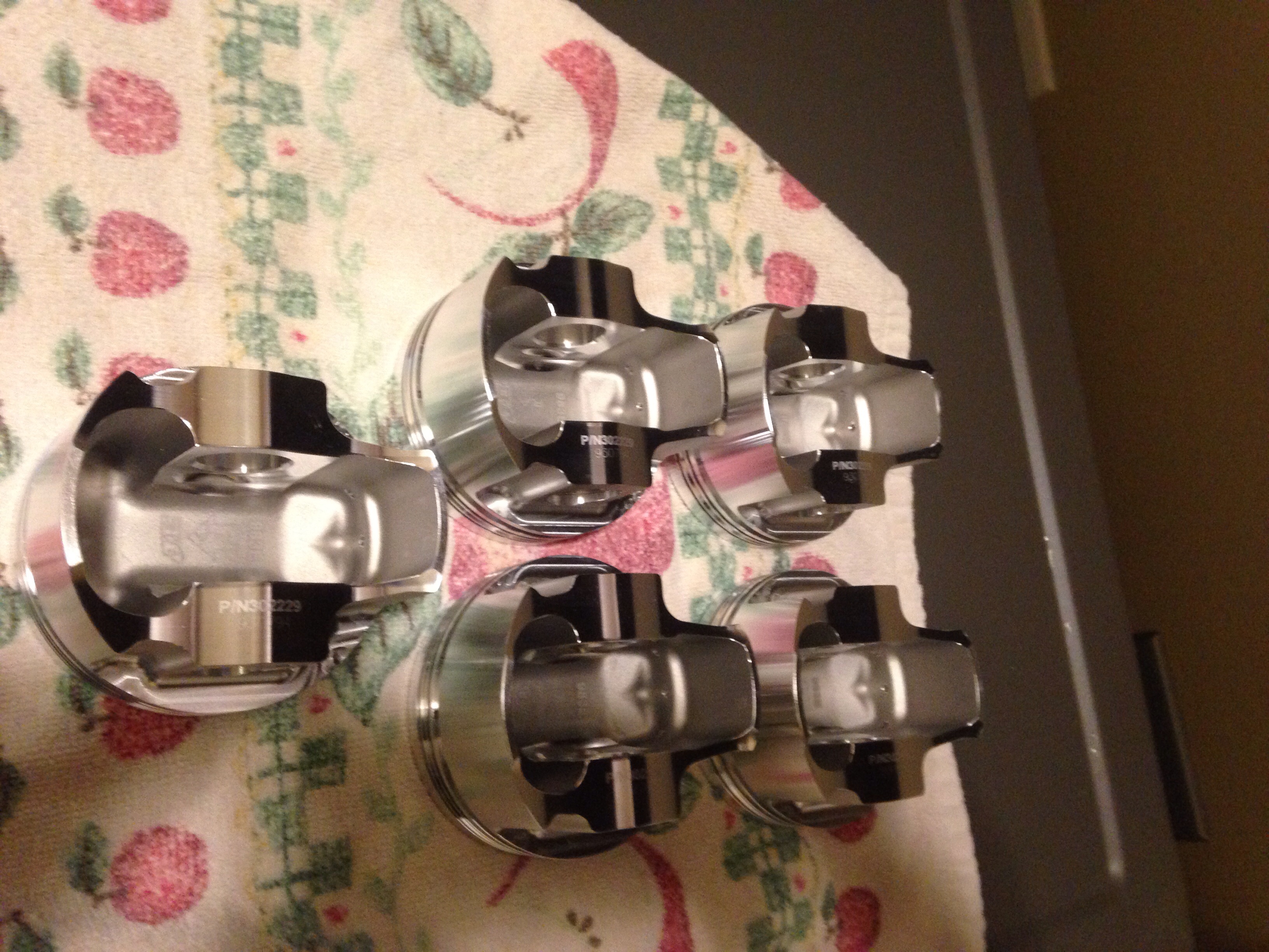

Ok it has been too long since my last post. Long story short I got sand in my intake manifold from sand blasting which got into my ring landings and seized my rings to the pistons. I did a full rebuild with new je pistons and stronger wrist pins. I didn't have the energy to build and post but now that it's done I decided to update my post.

New JE pistons again

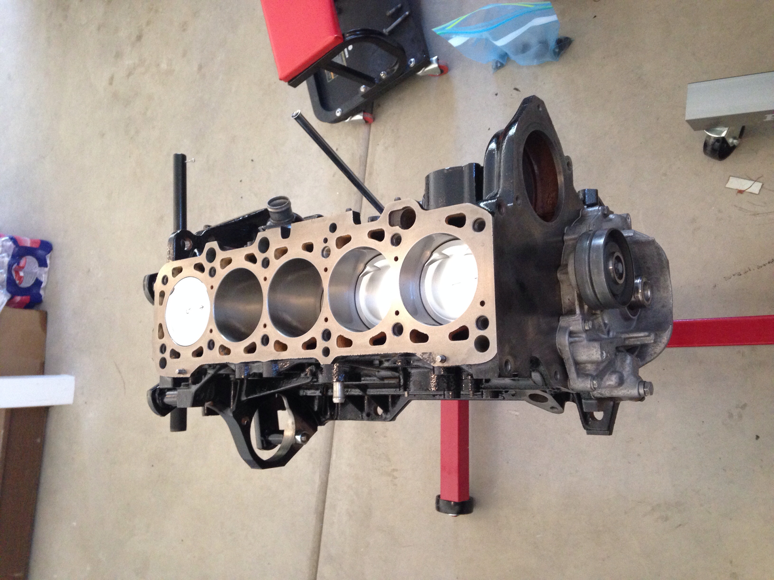

Rehoned and tanked block with new JE pistons
Engine completely reassembled and ready to go back in

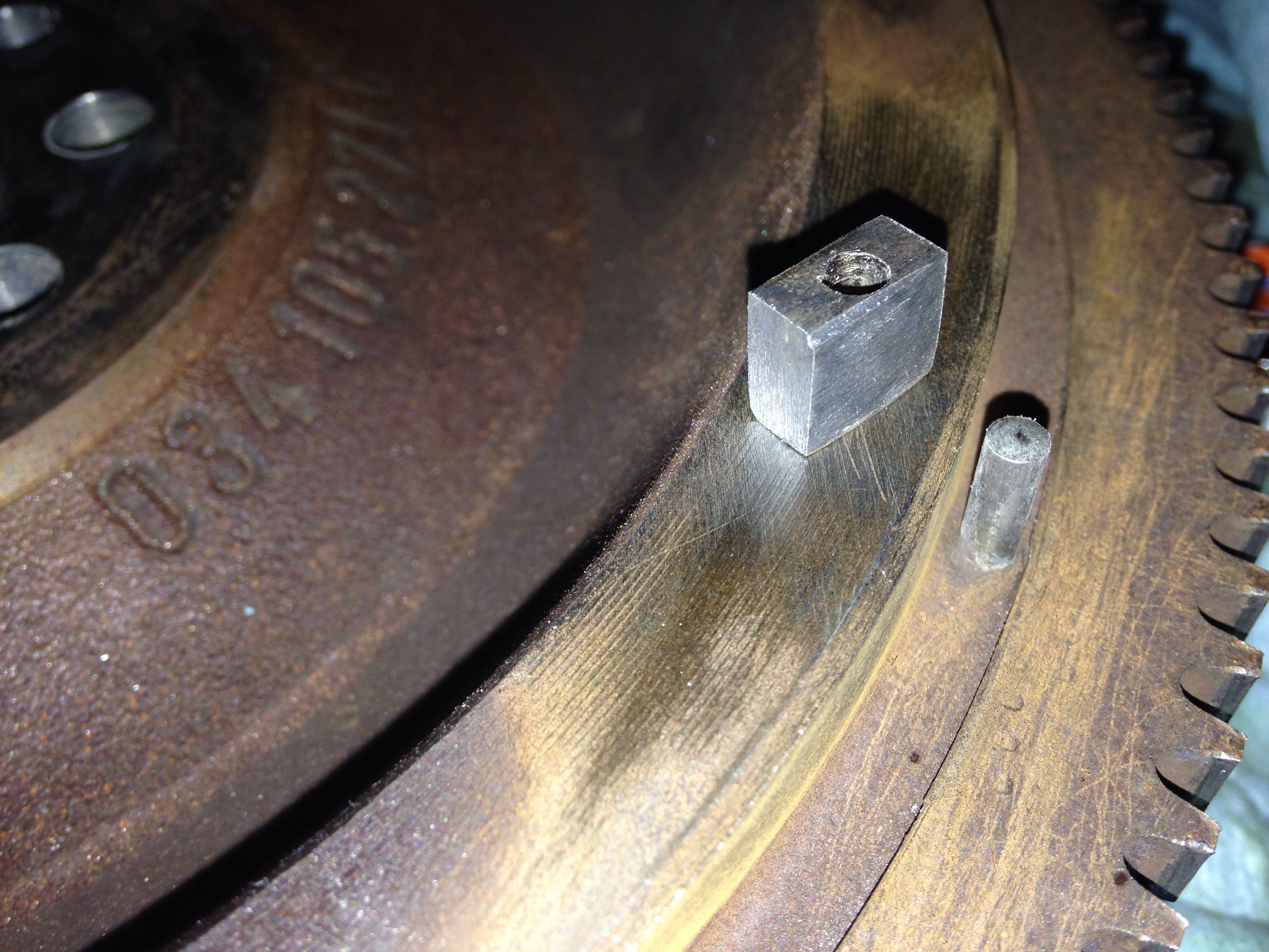

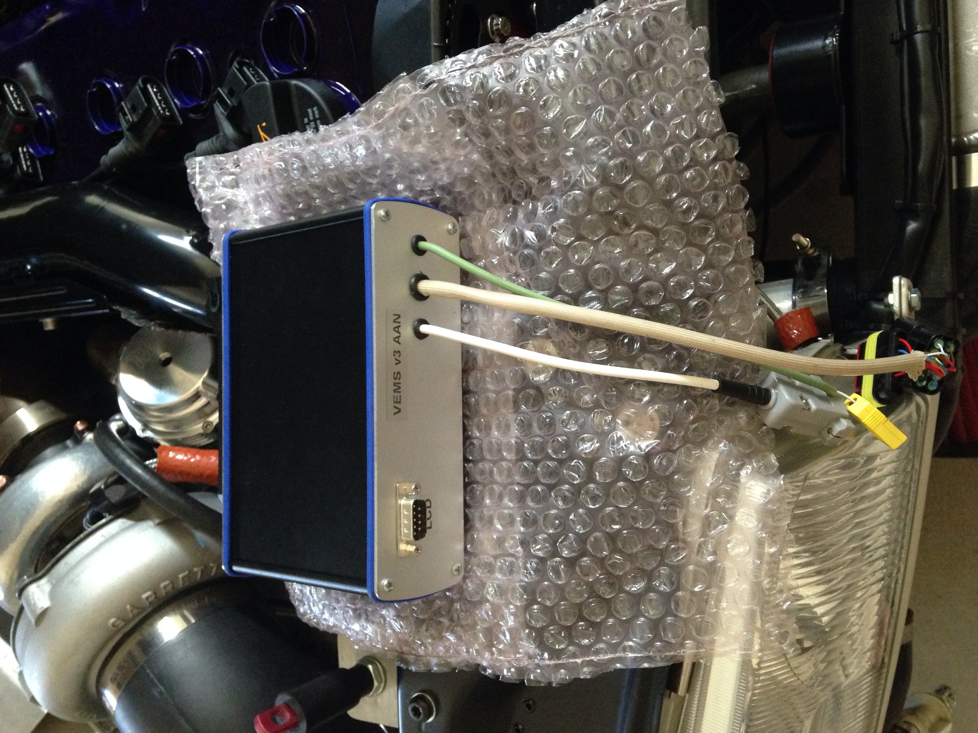

Here are a few shots of the interior after getting everything installed. Also forgot to mention I replaced the rack and pinion with a brand new unit. The old one was rebuilt by the previous owner but it was leaking. I also installed an adjustable cam gear and phenolic spacer from 034 Motorsports. The valve cover and intake manifold were sand blasted and powder coated, hense the damaged pistons. I also ditched the AAN ecu and bought the plug and play VEMS unit from Marc. I had to weld a bigger bung on the flywheel for the VEMS.
The entire engine was hot tanked, head, I/M, fuel rail etc. just to be absolutely sure that all contamination was removed! I also pulled apart and thoroughly cleaned anything that had to do with air or oil. I also had the crank, harmonic balancer and flywheel balanced at the machine shop. So all said and done about 4k in a full rebuild and associated parts, absolutely rediculous how much money and time spent, I have to believe that it's worth it. To be honest I have learned so much so this is, in a way tuition, albeit very expensive.

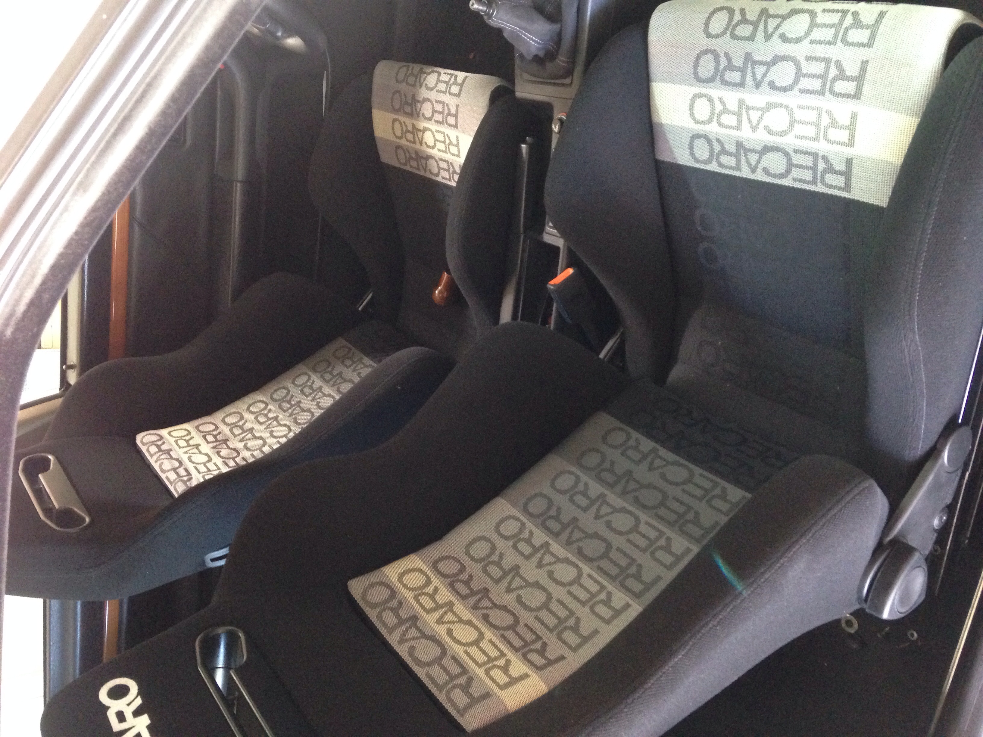

Here are the seats and the VEMS
Seats
Seats
Vems
Vems

Pickup for the VEMS

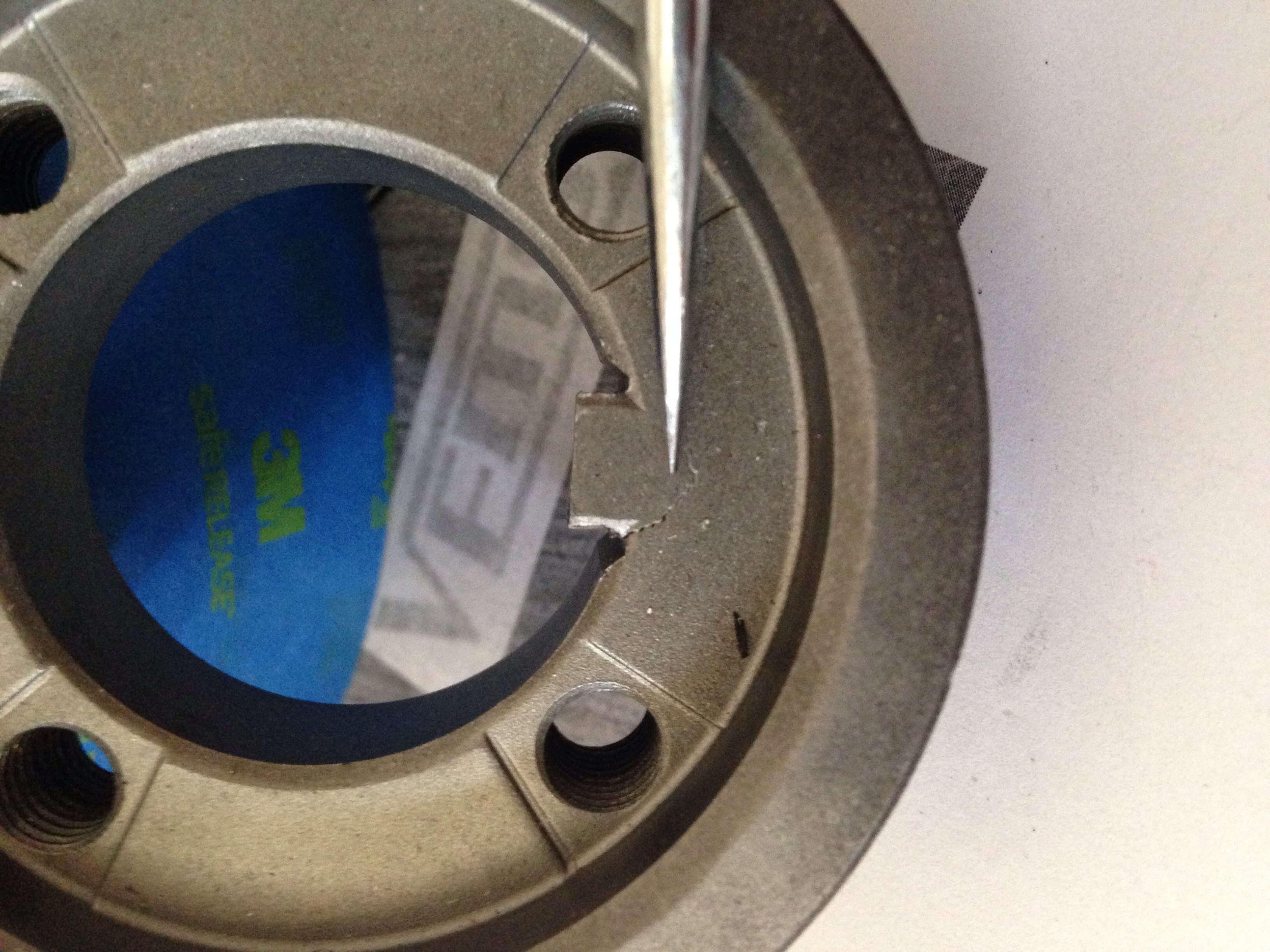

Like I said its been a while so I keep remembering things that I have done. I was about to put on a new timing belt after the rebuild and noticed a crack in the super torque cog from 034. Less than 1500 miles on this part I used the correct tool for removal and installation and I torqued it to correct specifications but it still cracked.
I don't know if its visible but you can see a crack around the key. I since updated this with a machined piece from EFI express for peace of mind. You have to pay close attention when you build a motor to find little things like this that could possibly result in a full rebuild. BTDT don't want to go down that yellow brick road again!

Omg those seats.
Crazy about the rebuild! Sucks, but you did it right. Fwiw I had my whole engine hot tanked and then I cleaned it afterwards and still a small piece of steel or aluminum got into my turbo and killed the bearings. I haven't yet, buy I SHOULD be running a little filter on the oil inlet. I think forced performance has and sells one and Hank recommended it.
What are those seats worth?

Ok good to know about the oil filter I will definitely be getting one of those. I don't want anything else to keep this motor from running. The seats were a little over 2k when all was said and done
