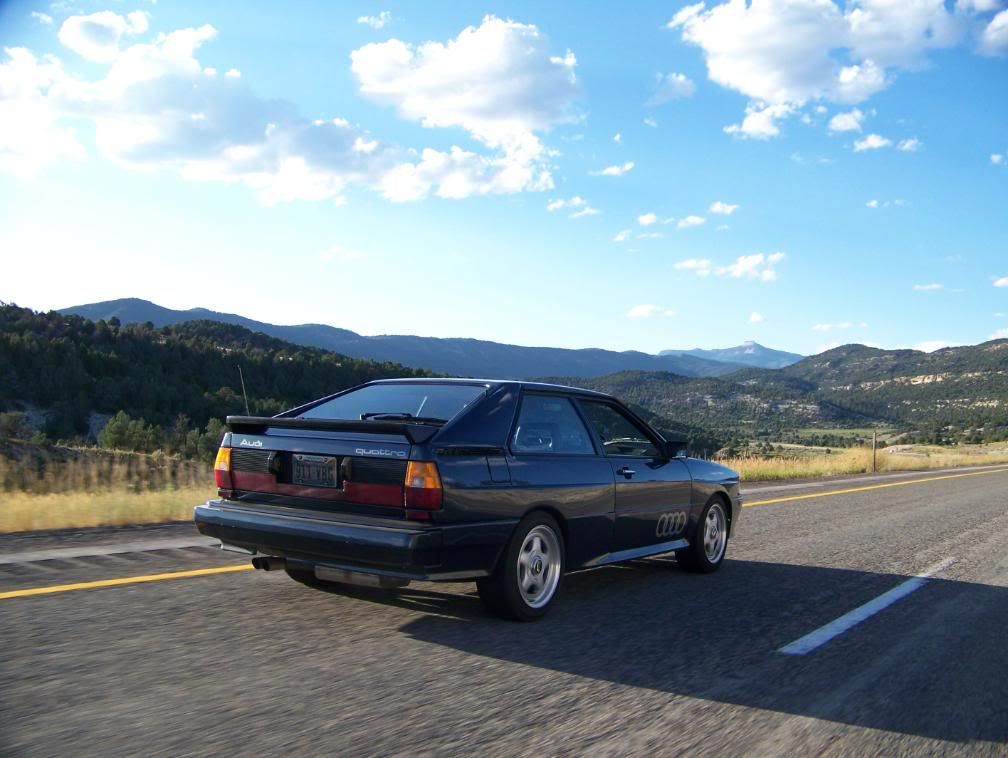

Just a note to thank everyone that helped along the way, both physically with me on the car and emotionally here on MG. It was just the kick in the pants I needed to keep moving forward when all was looking pretty gloomy. There is no such thing as a 'done' UrQuattro, but Im well enough along now that I can enjoy the car again.
All three UrQ's from Vegas made a successful journey to Colorado, albeit we didn't drive together for reasons I will let someone else expand on *ahem* Here I thought I'd be the last one done ;o) But thanks John for not giving up and busting your butt this morning when the average guy would have accepted defeat. I was SO glad to hear that you made it work and got on the road - shame you couldn't catch me lol
My GPS told me that I had driving average of 74mph for the trip. I stopped twice for a total of 21 minutes over a 7:04 trip. I didn't even pee til I hit Green River UT - which I think they will have to rename Yellow...
Man, there is some serious hardware here... Pics will follow.
Yeah, huge thanks to my Dad for getting the car to Colorado.. He had a scare when the FPR snapped off fuel rail backing out of the driveway.. He rewelded some stuff, and nearly caught Sean after a 3 hour headstart!!!! I knew that he had left and was behind, so I was calling up sean to scout out his position.. My Dad says he was pretty much ripping at a solid 95 100 and really wanted to catch the caravan and rip past at 150 or so, but it just didnt go down like that.. they arrived 30 minutes or so before my Dad could catch!! Oh well.. Why couldnt you stop a little bit more sean!!

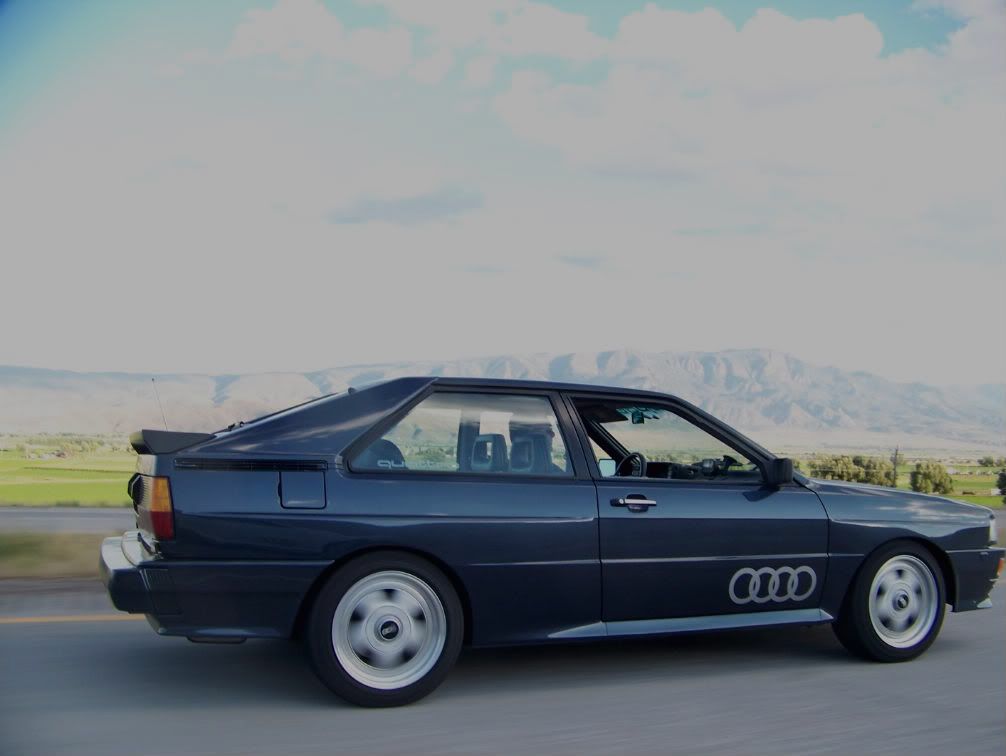

Sean in action: Your car not only looks good, but I can attest to the fact that it runs too. You were outpulling Hank's car at 80mph up hill roll-ons.
100mph's were a little different story, but I saw the tail lights quite often on the way home.
quattro v1.0
Post by quattro v1.0 »
HAA Those turned out pretty good.
I bet you didn't notice this 8)
Man, either you need to lose a couple of pounds dad, or I need to mess with those coilovers!!! Either that or you really ripped over to that left lane!!

Sean, are you going to be able to make it over for a bite to eat and some tire kicking? I like the pic even though Hank thinks I'm leaning it a bit. :slap: It looks like it is a UK Euro Urq with the mirror inverse making it look like I am driving a RHD car on the right side of the road.
