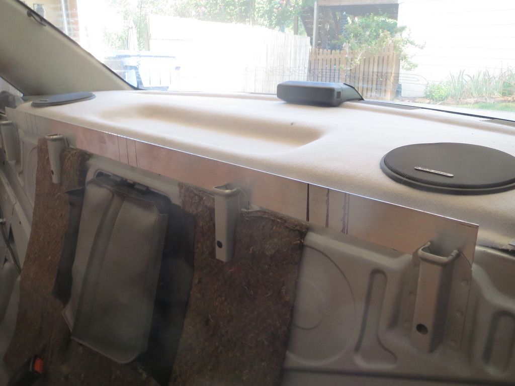

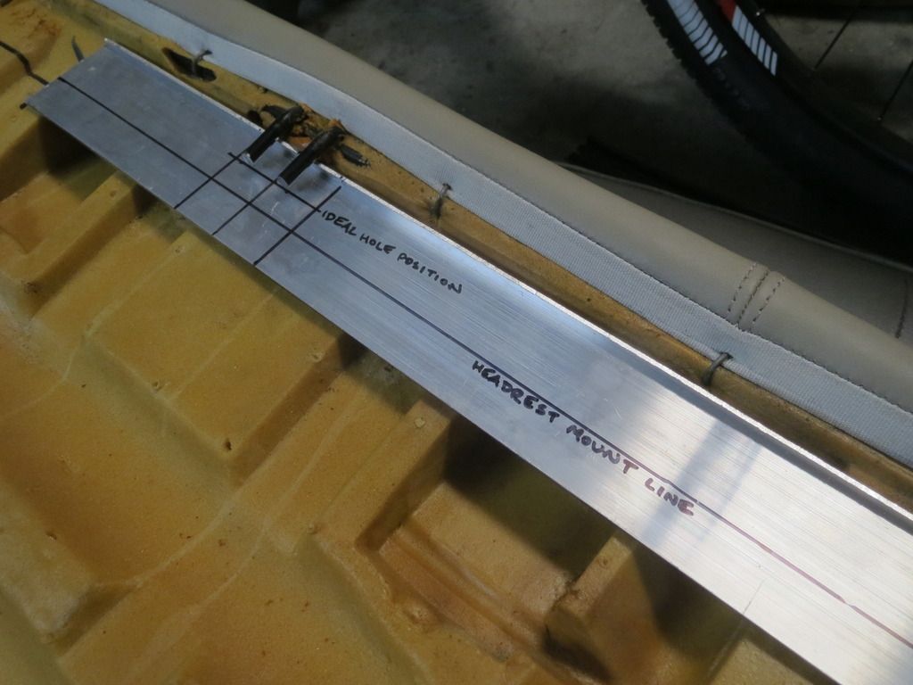

loxxrider wrote:Doesn't really seem like there is anything left to do for those rear seats! Just sit in them and go :) Looks sweet!
Haha, thanks! To be honest, you probably could. The seat bottom fits in and bolts straight up! Unfortunately, you have to first remove the 200 backing, as the UrS seats are ~3cm taller and won't fit with it installed.
Unfortunately, the UrS backing is not quite so drop in, because of several minor issues, but I've got an idea in mind to address them all. Hopefully it'll appear OEM to the uninitiated!

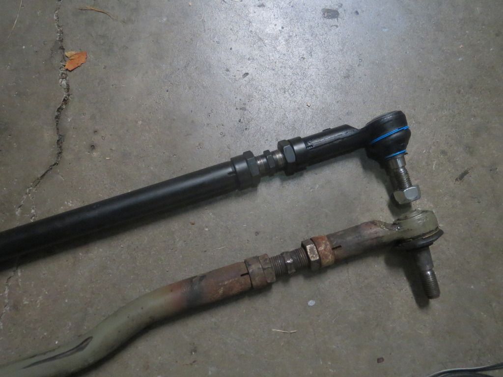

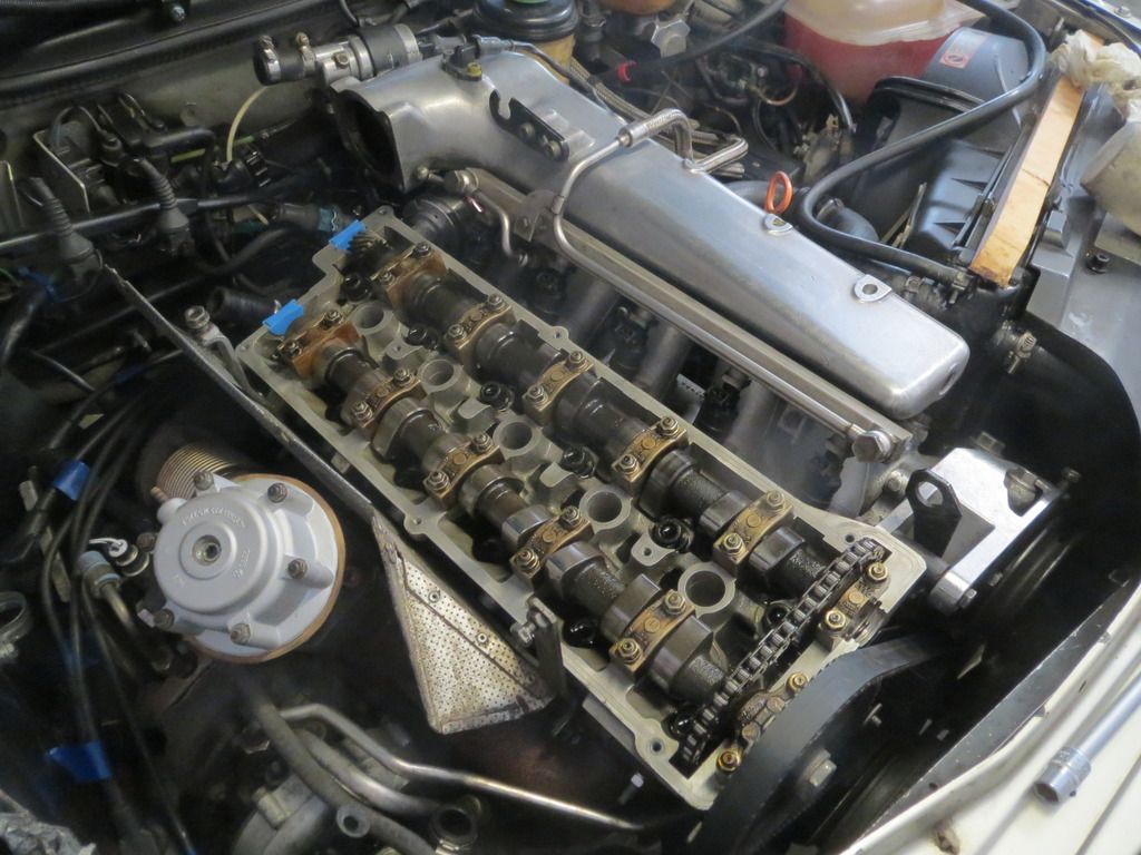

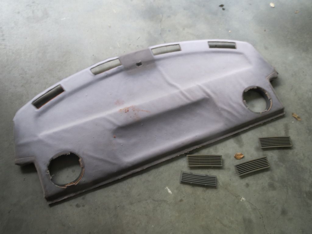

- 7A intake cam and VC leak fixed (Thanks Taylor for the help!)
- New fabric on the rear deck
- Successfully made rear seat bracket
- Tie rods, refinished new wheels, new tires, alignment
I made it to Boulder yesterday without a hitch! The car feels soooo much better both handling and in a straight line now.
Interestingly, the intake cam actually had a pretty noticeable effect on the powerband. A bit less on the bottom end, but the it gives a solid kick in the pants around 3-4k RPM before the boost tapers off.

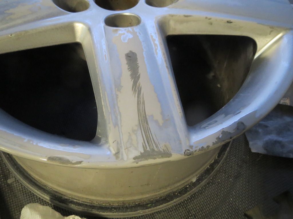

Little touches like the re-covered rear deck make a big difference. How did you refinish the wheels? Just filler and paint?

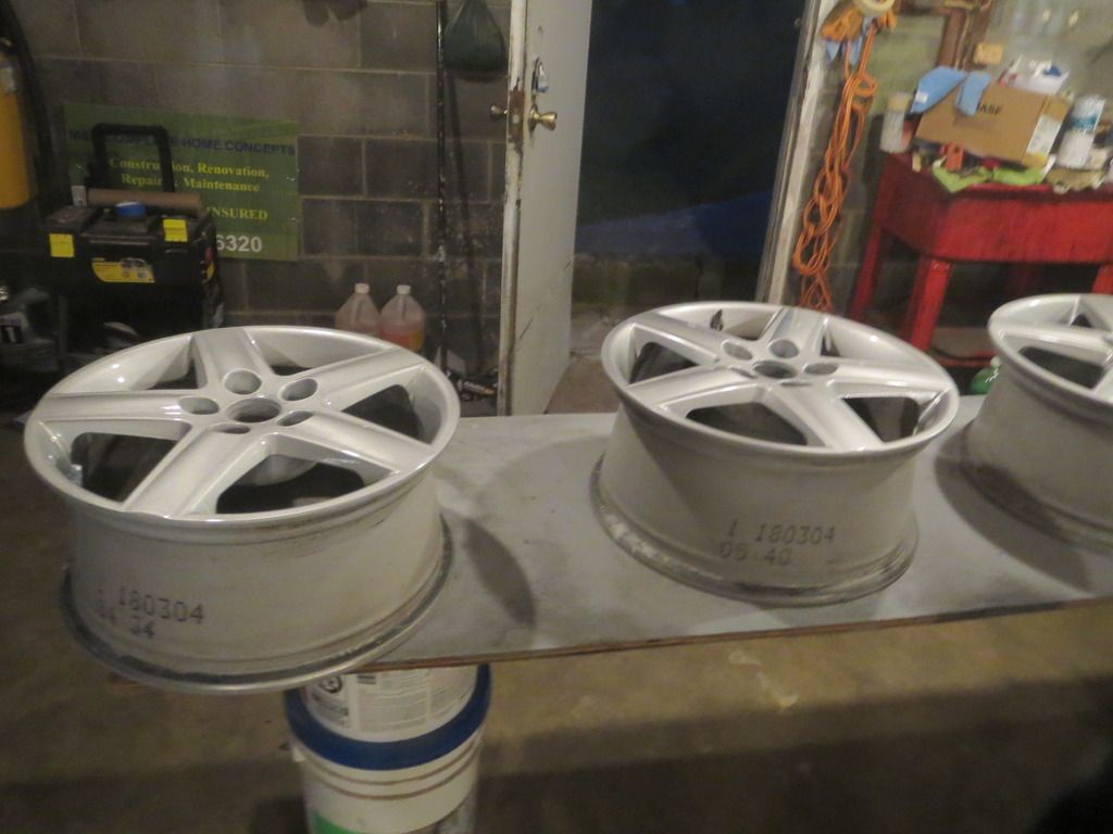

Haha, the wheels took an absolutely ridiculous amount of work.
I filled with JB Weld and spent countless hours sanding and reshaping them. After several disappointing rattle-can attempts, I went to a paint shop and had them mix up the original Avus Silver (but I cheaped out, so it looks a little metal flakey). I primed and wet-sanded, then took them to a guy with a paint setup, who kindly taught me how to spray them! They're not perfect, but they're not permanent, either. Just gotta clear some S4 brakes!
As for the rear seats, they are functionally installed! Aesthetically, there's still a bit to do, including the headrests. If there's interest, I can make a full write up on what's required to fit them when I get it all sorted.

Nice, I've used JB weld as filler (on the body of my 635csi). It's a lot more difficult to work with than other things, but it really holds well and gets hard as a rock. Not a bad choice there. I think the only reason people don't use it more as filler is because it's expensive and hard to work with. It does an excellent job when you get it right though!

Thanks man! I'm actually running both 7A cams now. I embarrassingly snapped a lobe off another one back in November, so I ran just the 7A exhaust + stock intake until I tracked down another.
Despite what I've heard about the exhaust cam making the biggest difference, I felt the opposite. I suspect that's because I'm on stock (chipped) ECU and stock turbo. The turbo is too restrictive to take advantage of the top end exhaust flow, but the ECU can adapt to the higher mass of air pulled in via the MAF. Or I'm just making things up. Dyno day to come soon, though, to see where things are. :)
