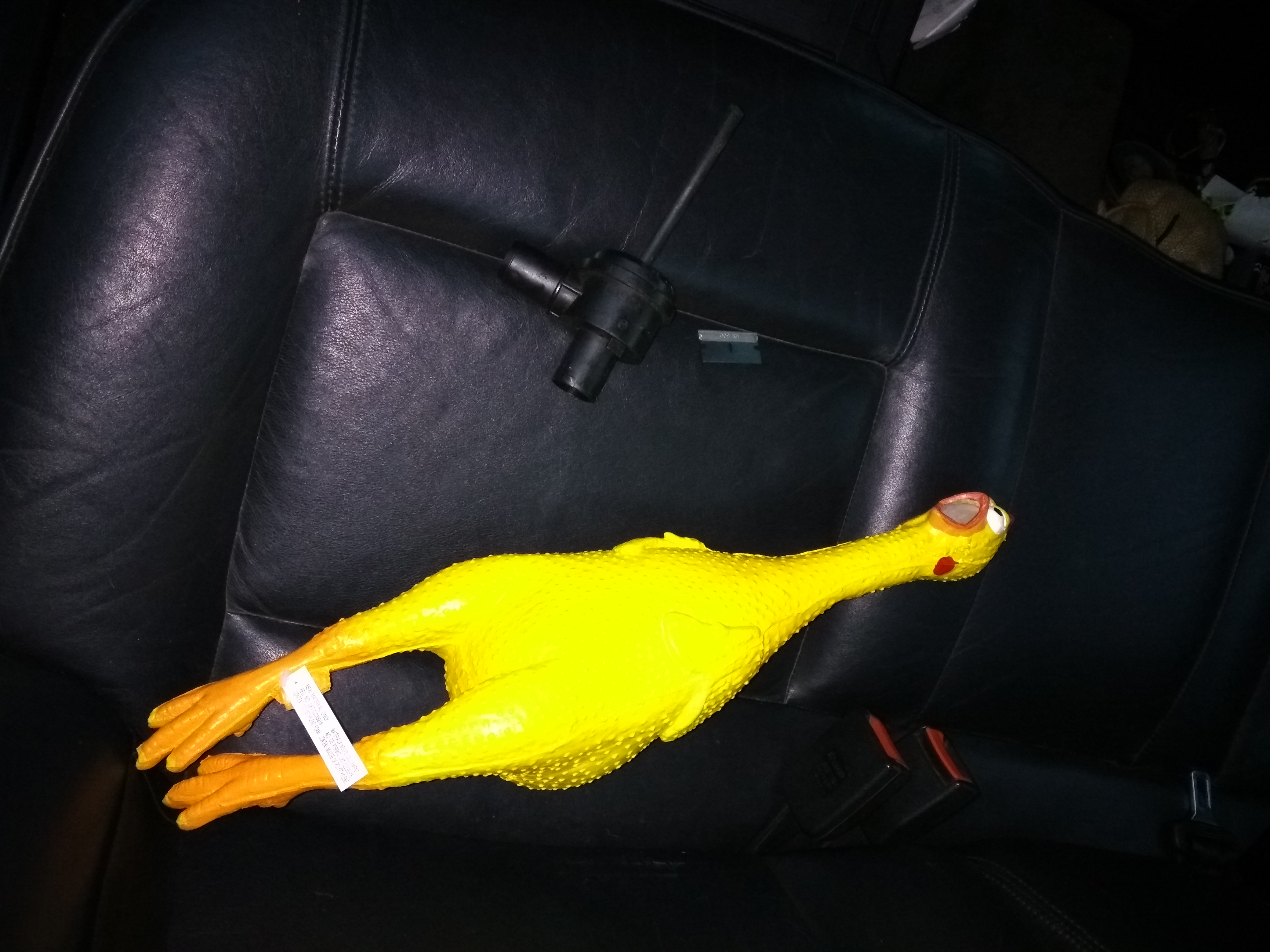

Grabber UHP's? Lol I had to google that one
Oh lord
- IMG_20170213_175703.jpg (2.38 MiB) Viewed 53501 times
4 years of engineering at university and I've finally accomplished something worthwhile!

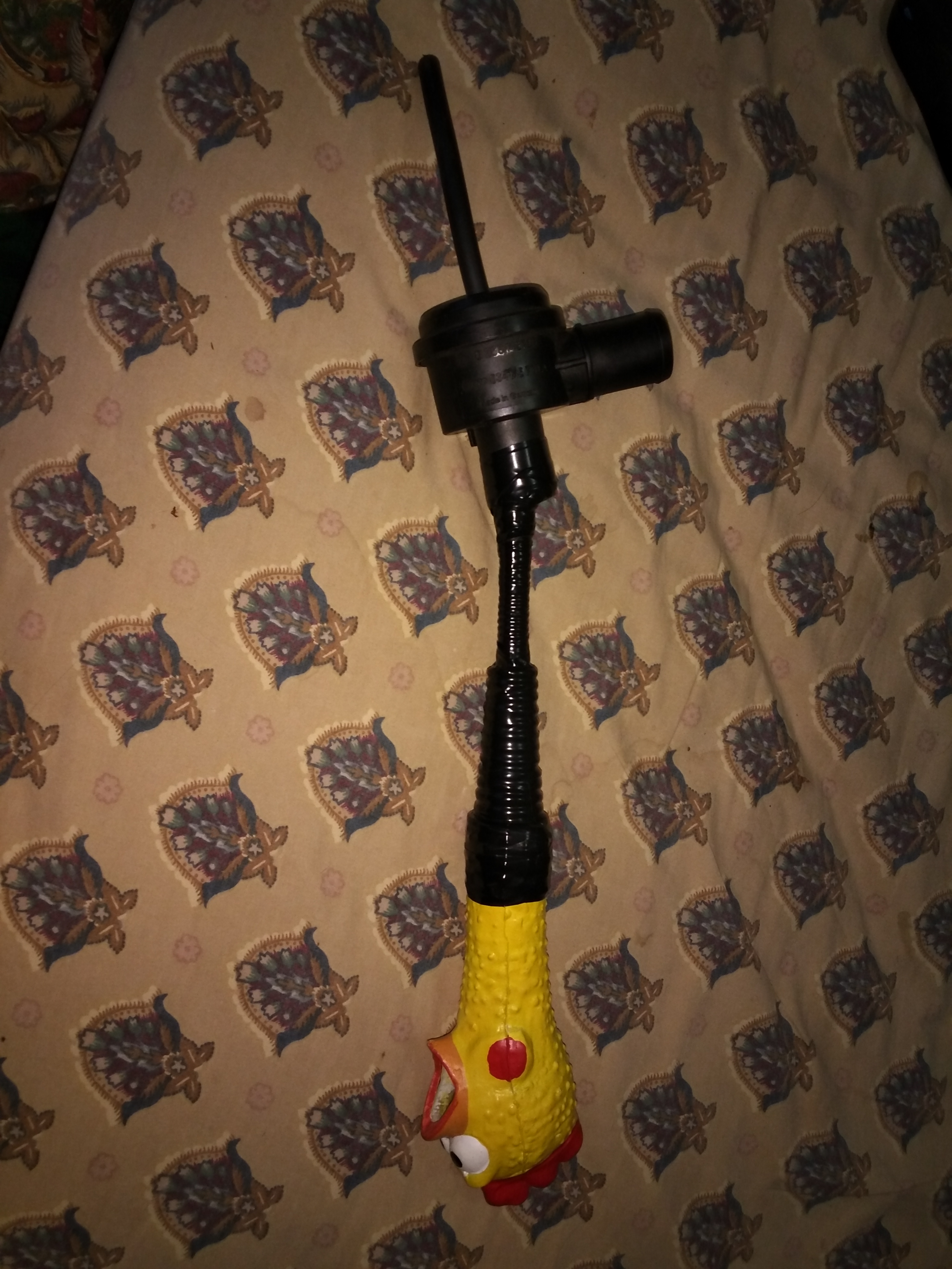

88a5tq wrote:4 years of engineering at university and I've finally accomplished something worthwhile!
Dude, you HAVE make a video of that!!!
Bahaha! The pressure was too great and shot the sound-making pellet out twice until I lost it. Of course I have another one now
Will do hehe
Will do hehe
You need to put a duck call on it, and call it a day! Haha!
Once, right, and done lol

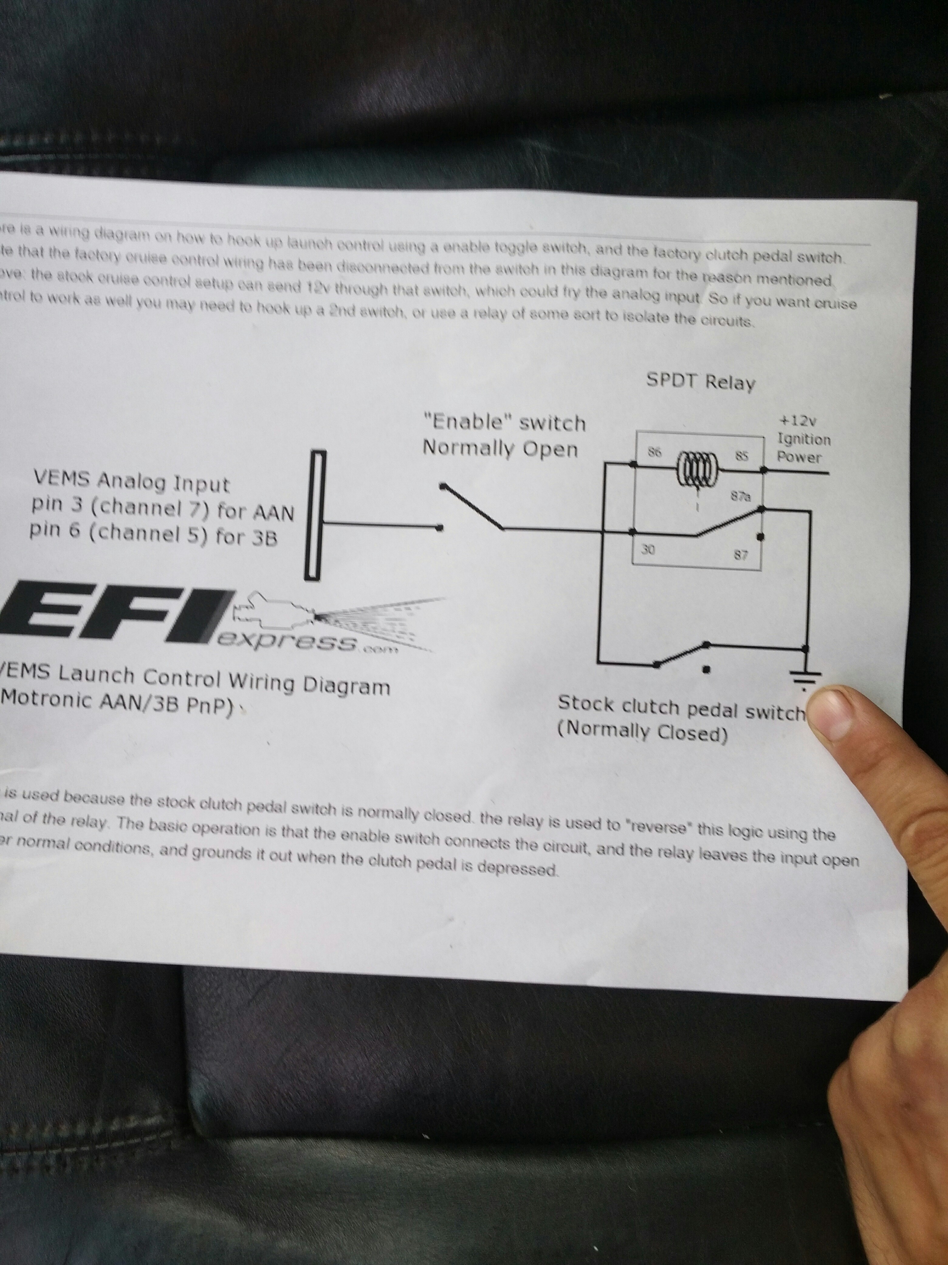

Hey Marc, just a quick question. Is it safe to use this spot I'm pointing to in the main ground of the LC circuit to actuate a regular relay that will interrupt another separate circuit when in use?
