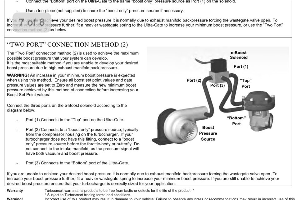

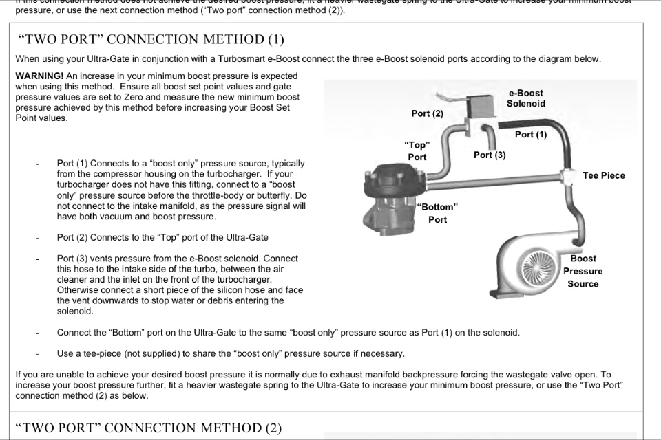

Anyone have the specifics on how to hook up an N75 using the top and bottom ports on an external WG?
Re: Nick's 1991 200q Project - QUAT44RO
Posted: Wed Jun 25, 2014 8:10 pm
by scubagli
Could be wrong but I think you only use the top with an aftermarket electronic boost controller.
Old and grumpy.
Posted: Wed Jun 25, 2014 8:13 pm
by amd is the best
scubagli wrote:Could be wrong but I think you only use the top with an aftermarket electronic boost controller.
Old and grumpy.
Mine is electric ;) I think I've got it figured out though I won't be testing it until tomorrow.

Yeah I'd love to get a ride, found these diagrams.
Old and grumpy.
Posted: Wed Jun 25, 2014 8:22 pm
by amd is the best
Method one is the plan!
