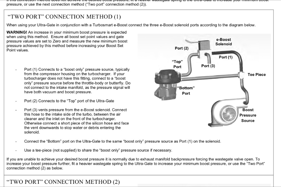

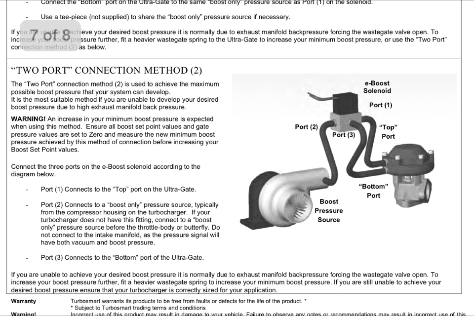

Anyone have the specifics on how to hook up an N75 using the top and bottom ports on an external WG?

scubagli
Posts: 604
Location: leeds ny
Re: Nick's 1991 200q Project - QUAT44RO
Post by scubagli »
Could be wrong but I think you only use the top with an aftermarket electronic boost controller.

scubagli wrote:Could be wrong but I think you only use the top with an aftermarket electronic boost controller.
Old and grumpy.
Mine is electric ;) I think I've got it figured out though I won't be testing it until tomorrow.

scubagli
Posts: 604
Location: leeds ny
Post by scubagli »
Yeah I'd love to get a ride, found these diagrams.

Method one is the plan!
