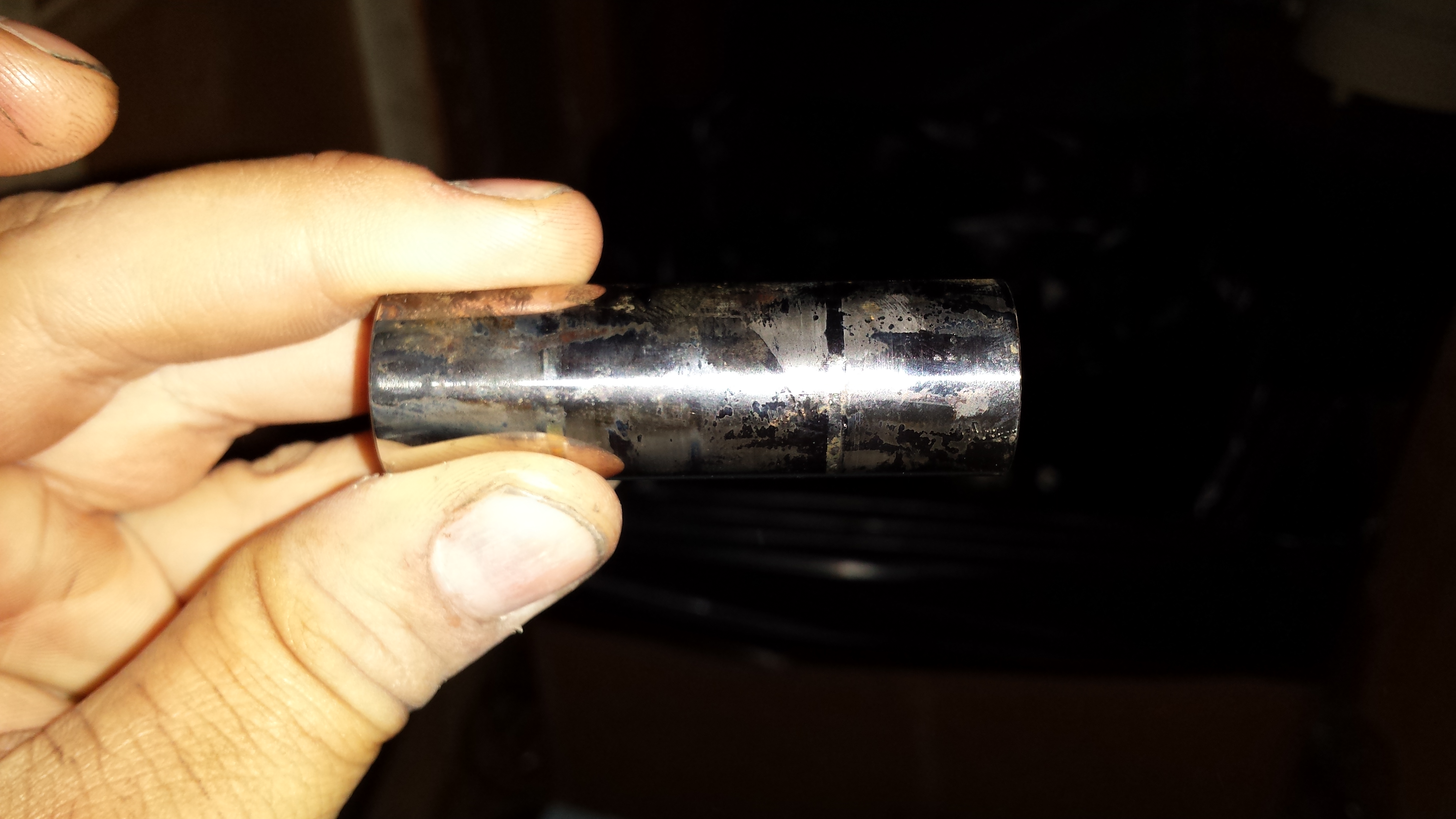

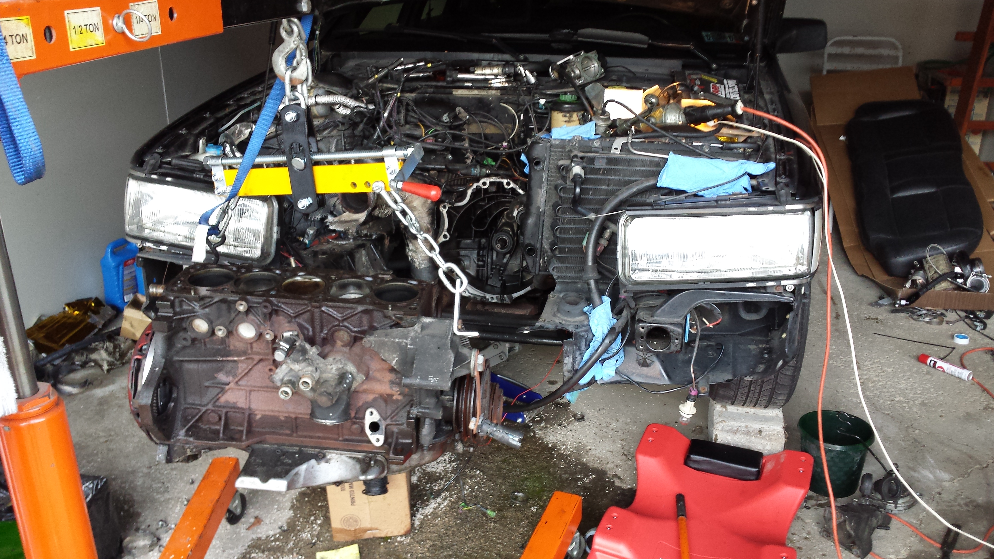

BOOM! Out, all by myself in fact. All my help kept falling through. So I'm stumped about what happened to the wrist pins from the spare motor. So weird but I let them soak over night in a box lined with a huge black garbage bag with a high mix of pinesol and water. It appears that the dye from the garbage bag transferred to the wrist pins where the we're laying on it or something. When I run my nail of the stains they seem to have more drag on my nail than the polished areas. Wtf am I supposed to do with these to salvage them? TIA Above is after sitting in paint thinner all day
I test fit the pin into a rod with no problems at all. No resistance. Seems to spin quite well in there
Run em?
Run em?
I would definitely not run them unless you don't mind the possibility of having the engine out again.
They looked perfect before I put them in the pinesol except for the oil lines left. I will try to clean the crap off before I go looking for new pistons. I don't think those pins are sold separately

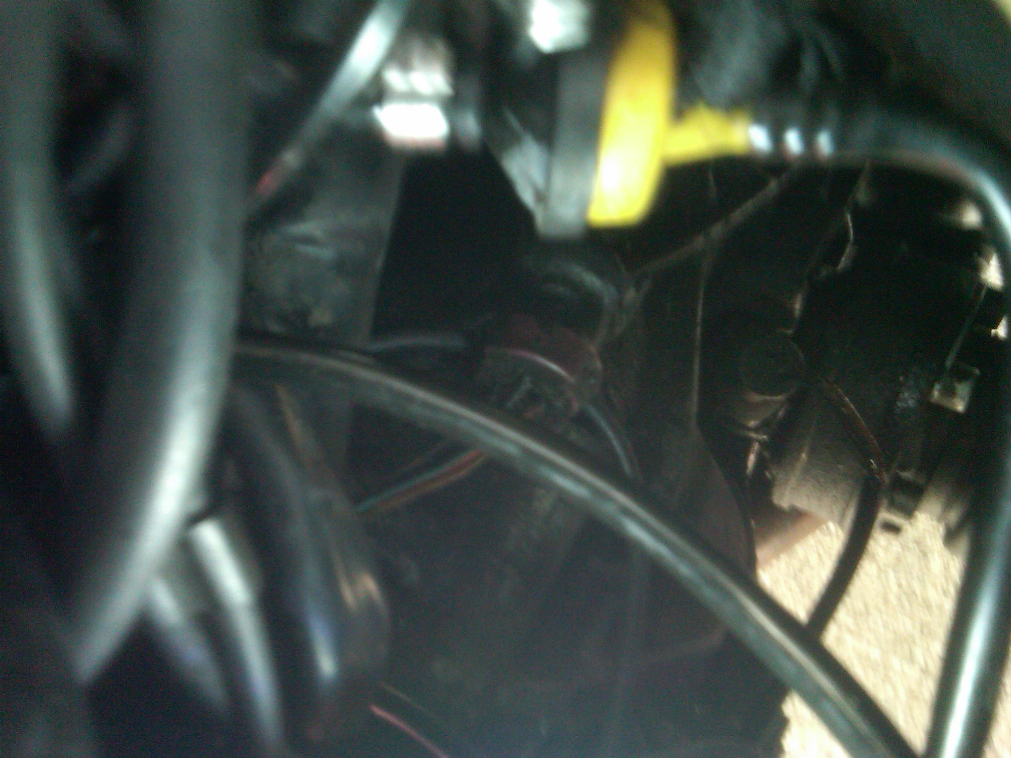

Help! Just did first start only to be greeted by an oil pressure warning. Car barely idled probably because of fueling but I did find oil at the turbo feed line outlet. I hope its polarity of the gauge sender unit (which had no reading at idle) as I've switched the wires on the terminals. I will test again shortly. Pretty certain I reused all the good sensors from the blown motor
Anyone seen this problem be caused by a grounding issue?
I feel like it could be related to the intake spaxcer and a grounding issue possiblu. I hope
I just got a stabbing pain in my brain lol. That centered connector is disconnected hah

Doh!
Nice when it's an easy fix though.
