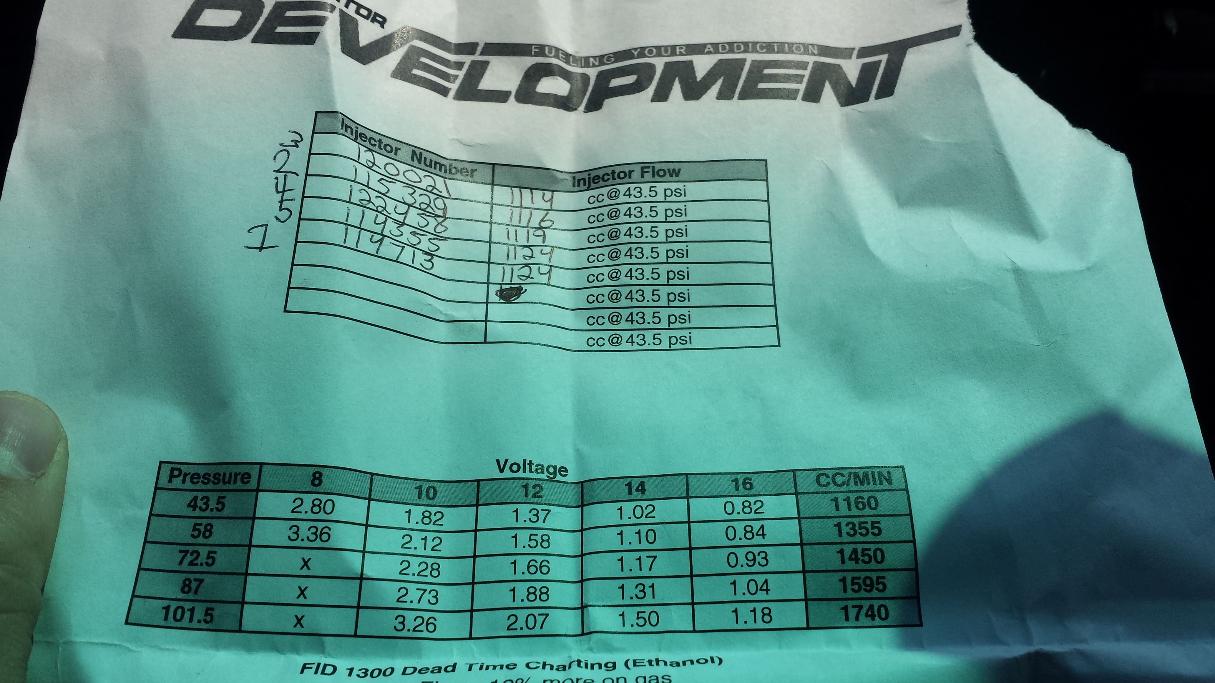

Not really sure of how to use this settings area along with the paper included with the injector. Somehow I feel like I should use the simplified tab for this fix. Not really sure here
- 20160508_120304.jpg (3.25 MiB) Viewed 38179 times
Or is this one of those instances where there's no direct correlation between those numbers on that table and the settings in vems? In that case I guess I would have to use the directions on the vems help site to determine the values
With some quick math, your "injector open time @ 13.2v" should be close to 1.21. all I did was get the average for the 12v and 14v dead times. It came out to 1.195, so 13.2 is 1.213. that's is a lot different than "0"!

Before you go throwing that in there, do some reading and see if VEMS uses milliseconds, or microseconds for this. I know megasquirt uses milliseconds, but not sure about VEMS.88a5tq wrote:Bahaha! That's hilarious! Thanks Dave
The units had me worried lol
Ya thing that has me worried is there's no units on that table from FID. Not sure what they use. I'll call them I think.
I just did the conversion and it looks like 1210 u-seconds could be the correct entry.
So with using that dead time value and the guess values from the vems help file, I've been able to keep the engine afloat with fan on! Only problem is my VE map is shit now and I have to redo it completely and I am going to the drag strip with the car tomorrow morning lol. I won't even risk it if I don't get this good tonight :(

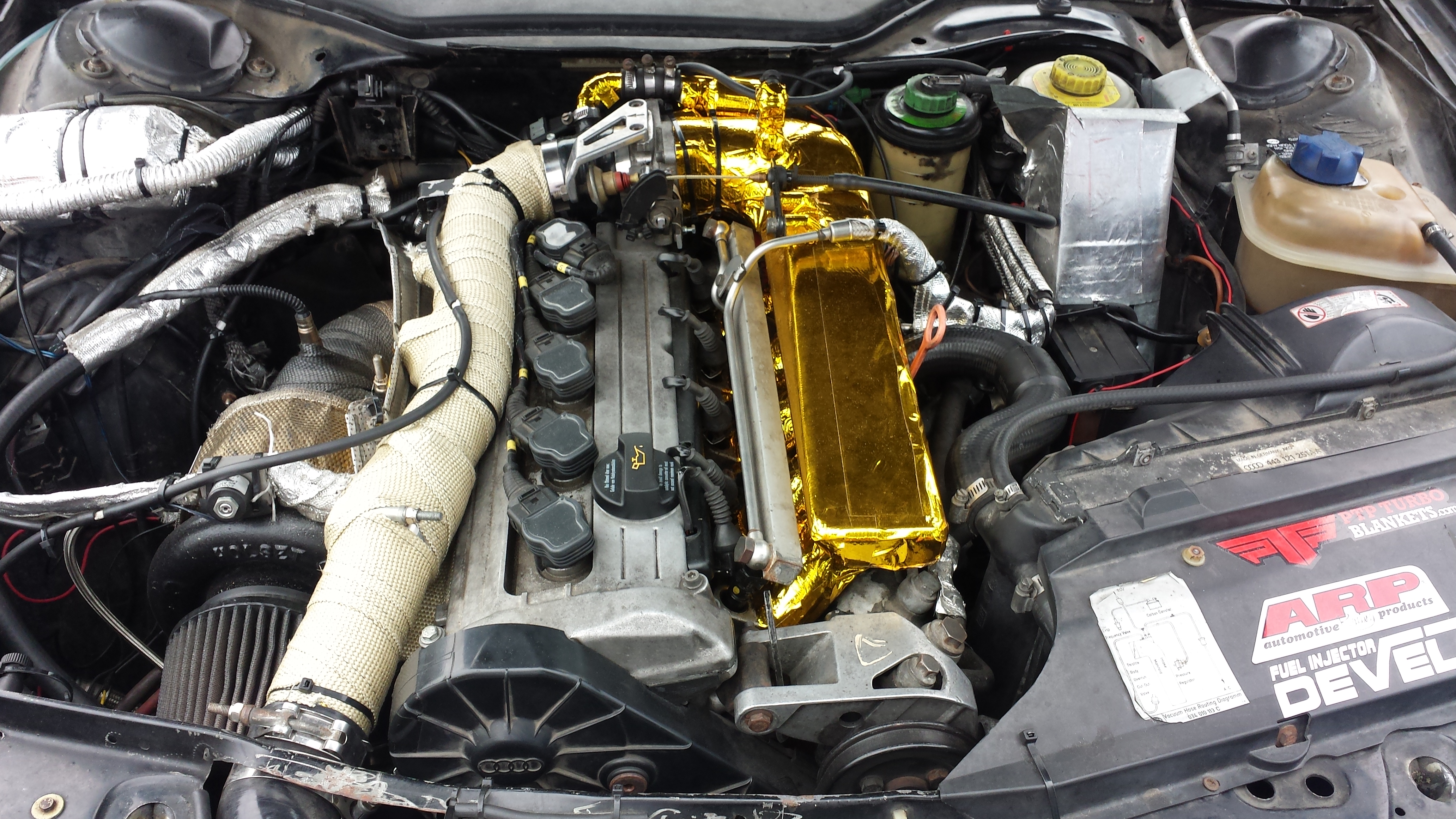

Some of you may feel like I've ruined my car but everything I do is FUNCTIONAL. Lol now look at what I've done!
The intake pipe to the left has reflect-a-gold as well underneath the header wrap. That trick was relayed to me by a local friend with a 1000 hp SL550. Although he did say titanium wrap and not the regular stuff from DEI
It is making a huge difference in preventing heat soak at lights and keeping temps steady. Coolant temps are even WAY down.
