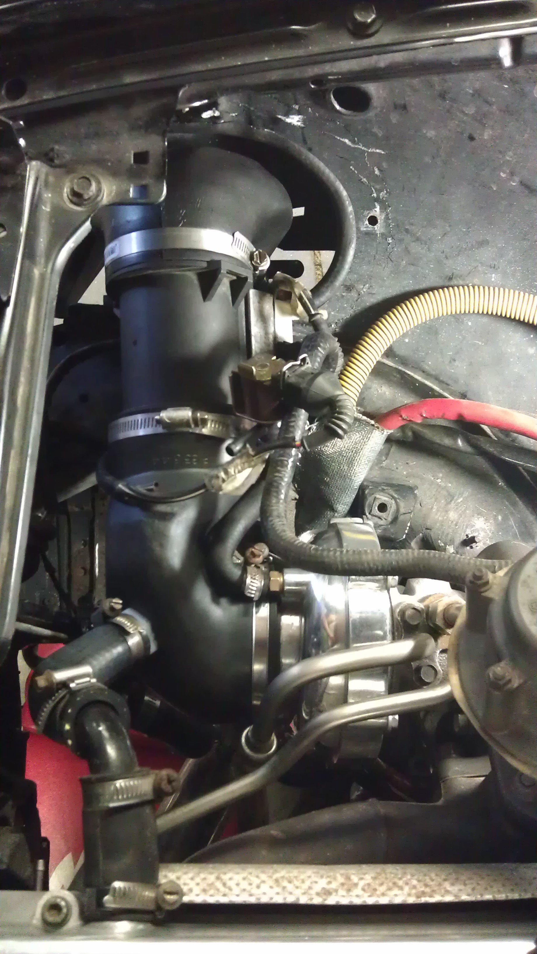

Well I think Ive isolated the hard starting issue. The intake boot failed on me Saturday. Blew a hole the size of my index and middle finger in it. Soooo in order to fix it, I think im going to cut it right before the throttle body and stick an exhaust pipe reducer in there. I tried silocon and a ton of electrical tape but it blew out first time I got over 6psi
Re: Taco's 4KTQ 20vt Swap: The Red Baron - Running Strong
Posted: Tue May 07, 2013 3:44 pm
by AngryTaco
Looking like a 2.5" OD reducer to a 2.25" OD exhaust pipe is going to do the trick. Looks like I'll be racing this Friday afterall!

Dammit....if my final contraption doesnt work tonight I may have to postpone drag racing on Friday and not buy my wheel adapters. $75 for an intake boot....oye

I fixed it! used a $3.50 exhaust pipe reducer and a 2.25" ID tractor radiator hose cut to size!
OMG TORQUE AND BOOST!! Idles better and pulls harder too. Not much...but definitly noticable

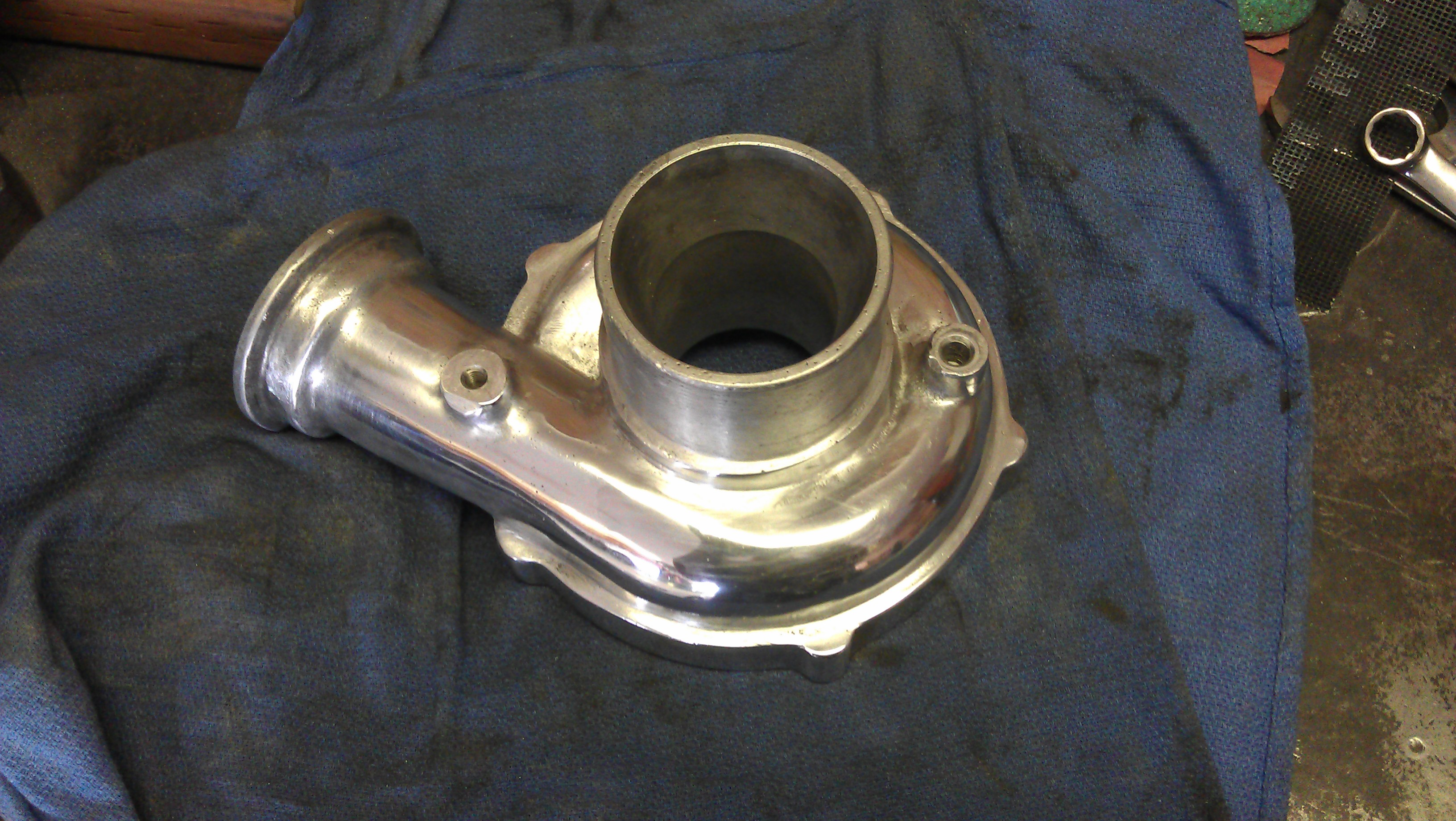

scubadave wrote:just a heads up, you will be making another mod to fit "THE TURBO"
Dave,
What cold side housing is that? My Volvo K24's cold side housing has the bypass valve in it.
Re: Taco's 4KTQ 20vt Swap: The Red Baron - DRAG RACING!!
Posted: Mon May 13, 2013 10:47 pm
by AngryTaco
He had it removed, welded up, and machined nice and shiny
