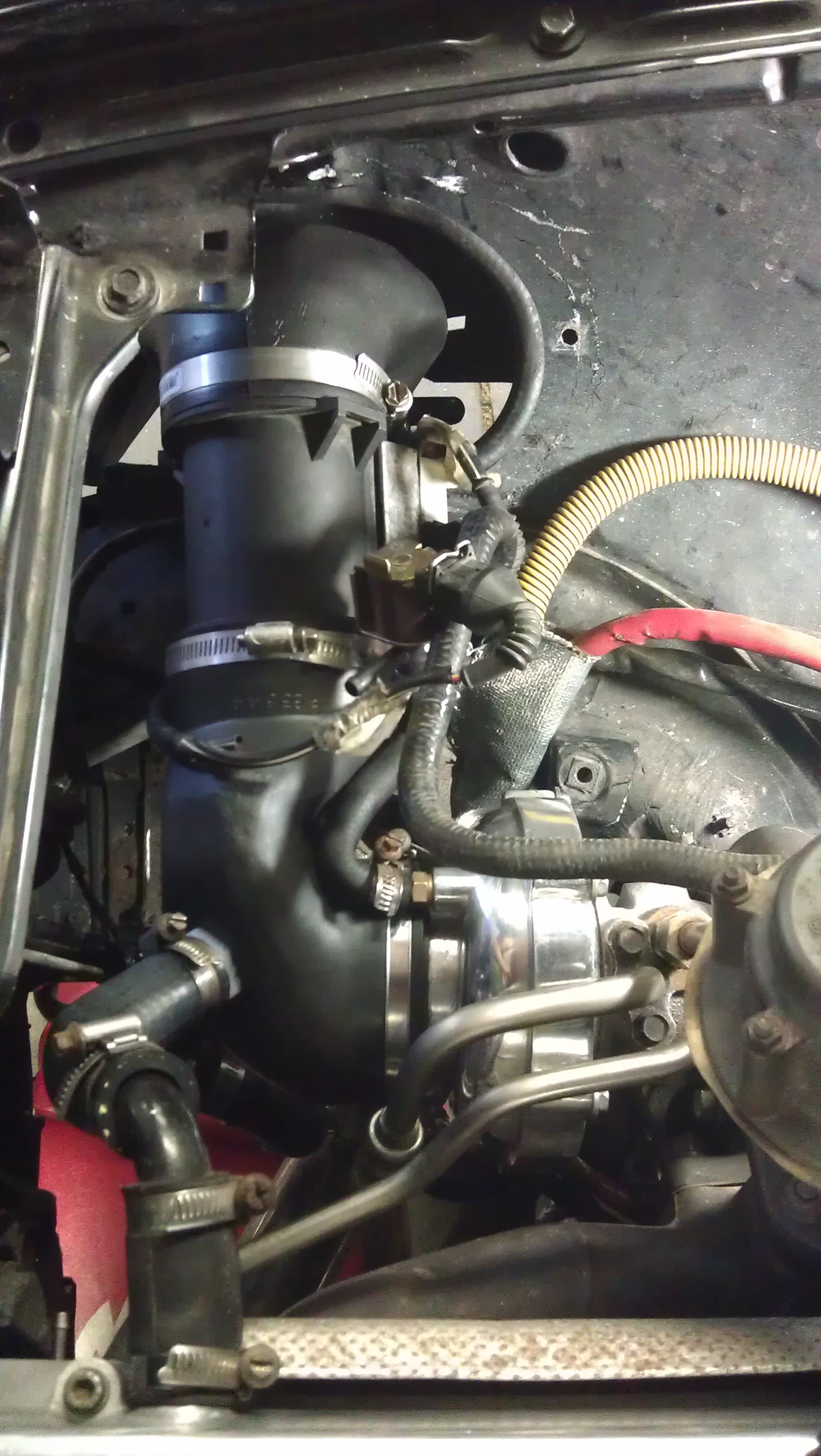

Well I think Ive isolated the hard starting issue. The intake boot failed on me Saturday. Blew a hole the size of my index and middle finger in it. Soooo in order to fix it, I think im going to cut it right before the throttle body and stick an exhaust pipe reducer in there. I tried silocon and a ton of electrical tape but it blew out first time I got over 6psi

Looking like a 2.5" OD reducer to a 2.25" OD exhaust pipe is going to do the trick. Looks like I'll be racing this Friday afterall!

I fixed it! used a $3.50 exhaust pipe reducer and a 2.25" ID tractor radiator hose cut to size!
OMG TORQUE AND BOOST!! Idles better and pulls harder too. Not much...but definitly noticable

just a heads up, you will be making another mod to fit "THE TURBO"

What exactly will I need to change Dave. I see the v-band but what size is the inlet? Hopefully wont screw up my recirc system

I cut the v-band off, so thats no longer an issue. Its just the inlet to the turbo is much bigger. You will have to figure out a different inlet boot. I used a cobra head for my solution, two actually. I got two in case I screwed the first one up beyond functionality and ended up using both to my surprise. You may do someting similar. I have faith in you to make something work. You already know the juice is worth the squeeze.

I would think a simple 90* reducer elbow would work. Or an elbow with a reducer. Ill make it work. Just gotta get the damn funds!! Not too much longer!
