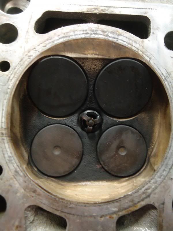

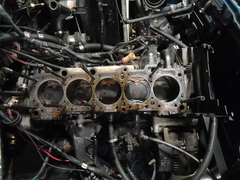

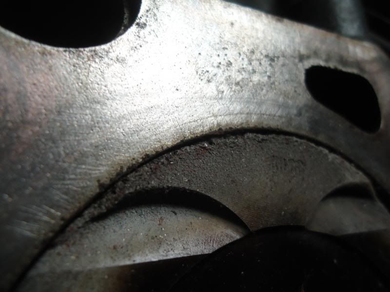

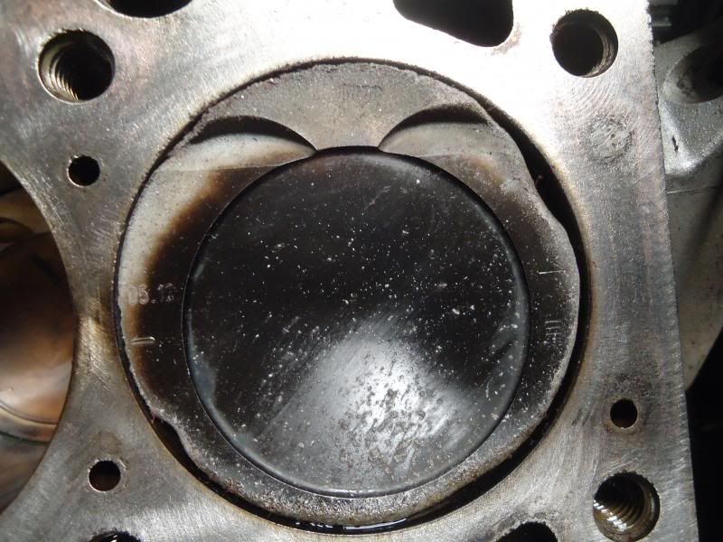

Well, today was a good news day. :D I pulled the head and only found damage on the #1 piston and nowhere else at all! Here are some pics of everything...
This is #1:
While, it does not look pretty. Everything else looks really clean including the head.
This is #1 on the head:
SO, after much thought I've decided to just throw another set of stock pistons in, new rings, hone and SS valves. Throw it together and keep learning to tune. I'd much rather make mistakes on my "cheaper" engine than a fully built one. SO if all goes well I will be back together sooner than later.
So I guess the ultimate question is what was the actual cause of the DET. Where 2-5 had ZERO evidence of DET events, I'm really starting to question whether or not the #1 injector was freaking out, be it because of a particle jamming up the pintle or a physical malfunction, I don't know. Of course overboosting was a contributing factor, but when I actually lost compression was after I made it home. I was doing a freeway onramp pull and I had a bad misfire, then it started to miss. Anyways, I may take a lab scope and watch the pintle movement, but right now as far as I'm concerned, this thing is going to get an injector upgrade anyways. I want E85.
PS: The turbo had NO damage either, so I'm super lucky and happy. :D

Interesting, in a bad way, that that plug looks really normal (in that shot).
AngryTaco
Posts: 2657
Location: Hayden Lake, Idaho
Re: Ben's Oceanic PTE5857 AAN 4kq - Good news day
Post by AngryTaco »
that piston is messed up BAD
