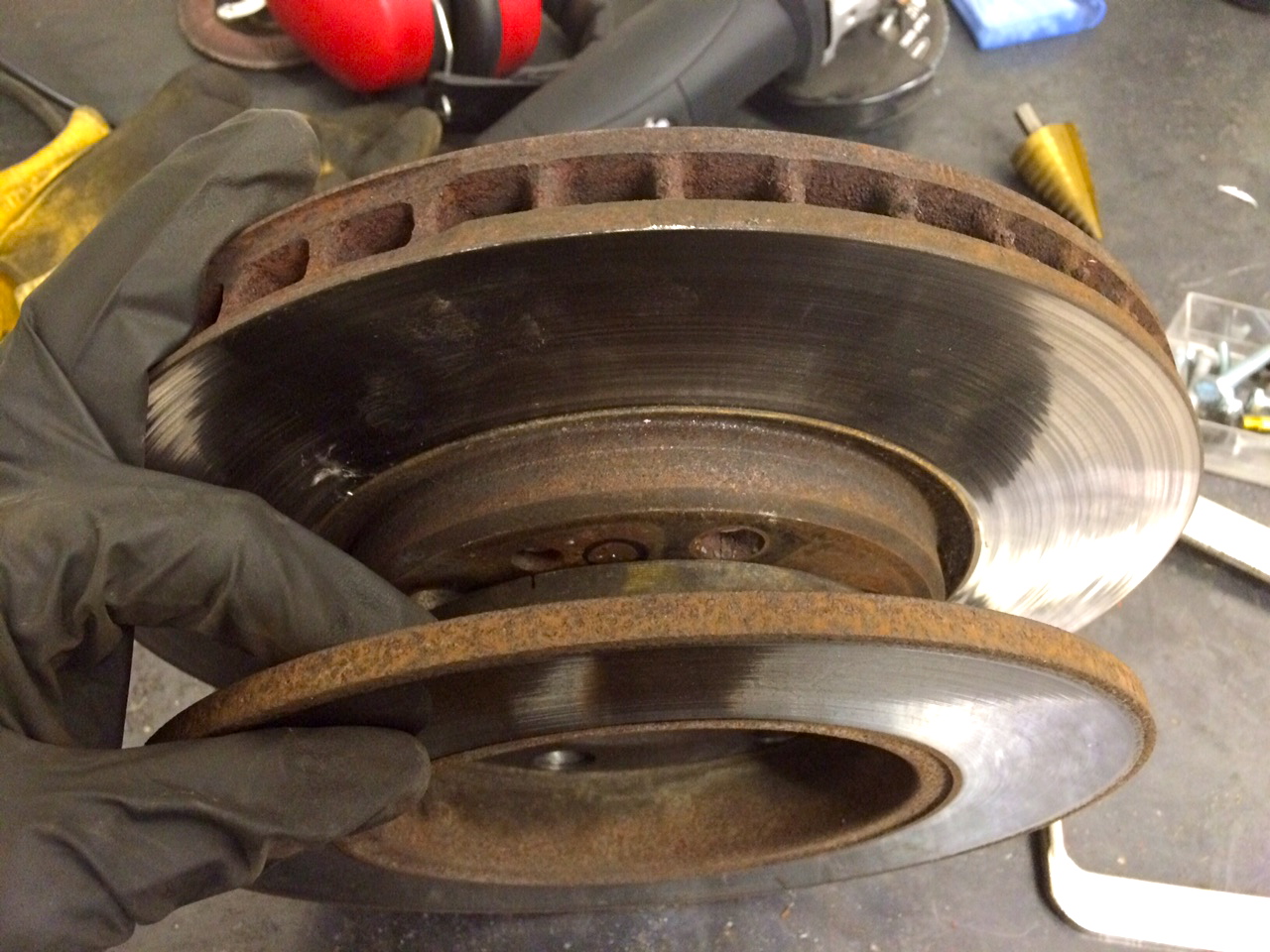

Those stock lil' 4k rotors are cute little buggers but I'm happy with 50mm more rotor and much more girth
- E30 M3 front vs 4kq rear rotor size
- IMG_5161.JPG (416.78 KiB) Viewed 40573 times

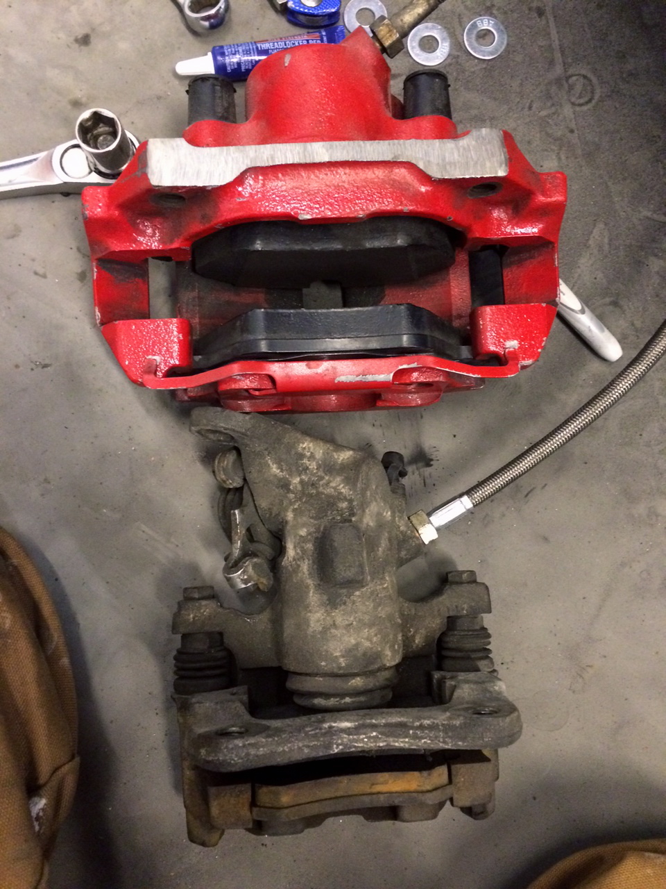

E30 M3 front caliper vs rear 4kq caliper
- E30 M3 front caliper vs rear 4kq
- IMG_5176.jpg (470.79 KiB) Viewed 40572 times

Conveniently, the brake lines all matched up no problem.

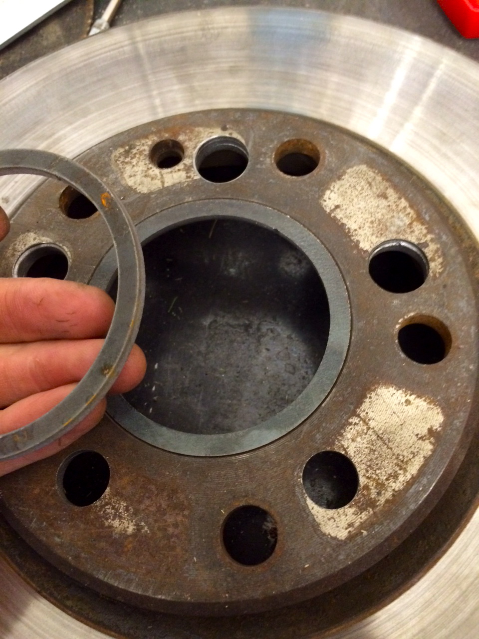

I also redrilled the 5x120mm BMW rotors to 5x112mm Audi. After taking 20 minutes one day to try and line up the non-hubcentric bmw rotor (bigger hub bore) and the non-hubcentric OZ's I decided I needed some centering rings for the rotors. What I REALLY need is to do wheel studs but I don't have time for that right now. I'll order some up next week.
For now, I had the local waterjet cutter make some rings for my BMW rotors. I welded them in place and whammo, hubcentric rotors!
- IMG_5173.jpg (405.27 KiB) Viewed 40572 times

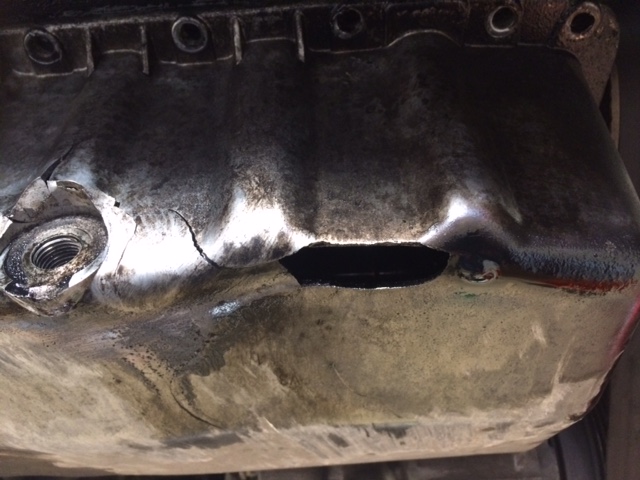

Then the next morning this happened. The wife hit something in the TDI wagon and kept driving... Literally less than 12hrs after the Audi motor went south.
So yeah, my first motor failure. Ever. I thought my right rear tire was flat because the car got a bit loose so I stopped hitting throttle almost immediately (or so it seemed??) and just coasted and pulled off the track. Then smoke everywhere. A pretty underwhelming way to blow up a motor.
So I'm in the process of getting the motor pulled for inspection.
- jetta TDI oil pan
- IMG_5234.JPG (107.86 KiB) Viewed 40478 times

oh man, major bummer!!! I've never liked the idea of the push lok hose!
Did the TDI survive? i broke my TDI pan this year and it ran out of oil and it was totally fine. However, I shut it down the millisecond the oil buzzer went off. Those pans are horrible, so easy to hit and so damn flexible.

New oil pan showed up yesterday afternoon for the TDI. Its fixed and the motor is all good. Finally some decent news

I'm glad that was an "easy" fix. I can't imagine the AAN will be quite so lucky...
