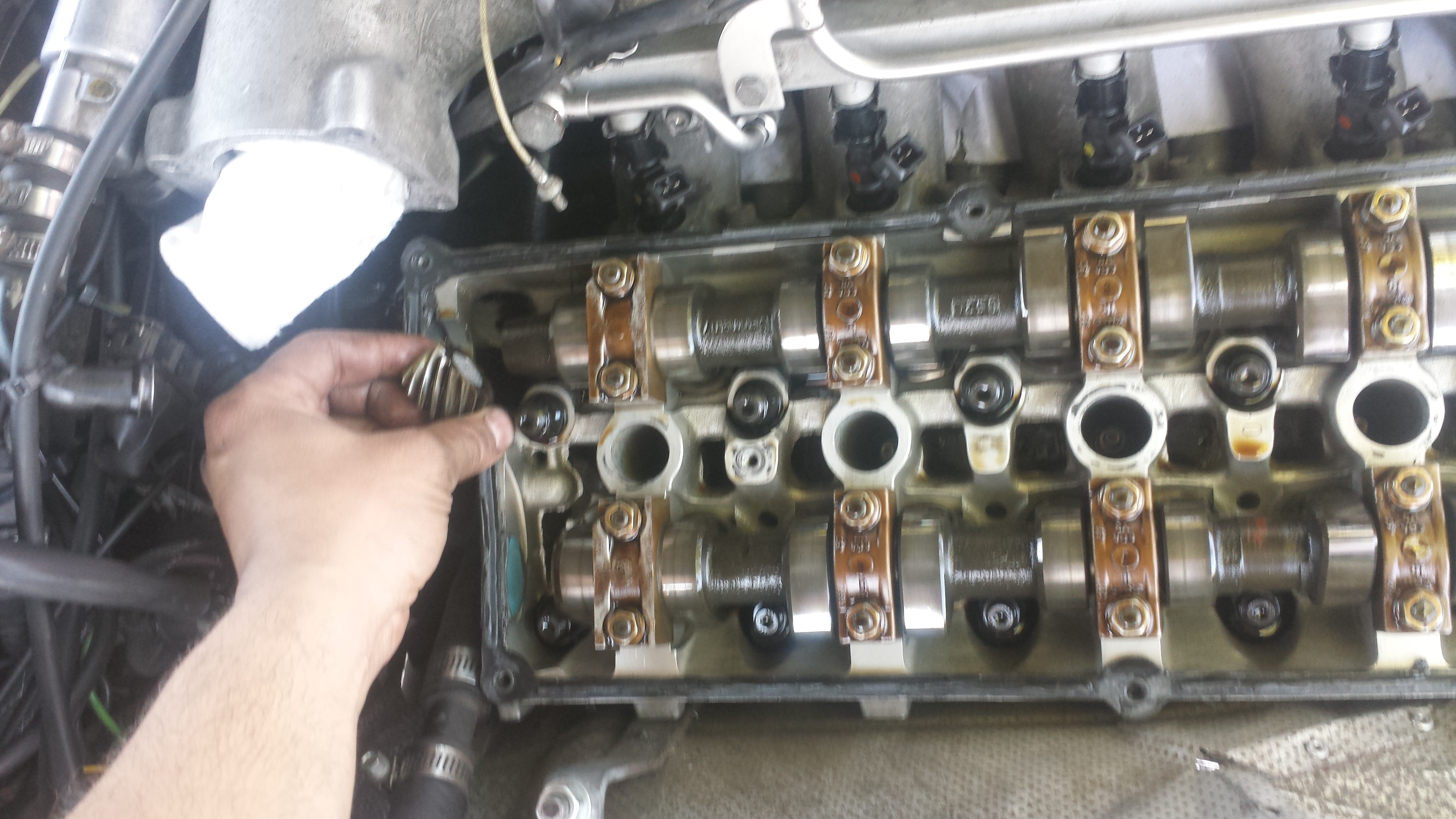

Ahhh SHIT!! My dizzy shaft is spinning relatively free. Dammit! Time to yank it out and observe the carnage :bangshead:
It even has the brass gear :wah:

Wut. That sucks man! It gives me flashbacks to when I snapped a 7A cam in a very similar manner, but it was during install. I wonder how that happened. Did the dizzy bind with anything to keep it from spinning freely?
Actually, I'm now wondering if the plastic dizzy gear was originally intended to be a designated failure point, since that would be far cheaper to replace than a cam in such an event. In any case, I'm glad it sheared off cleanly and the piece didn't cause any permanent damage to the head.

I totally agree on all your points. I would figure the plastic gear is plastic for that reason. I don't think I over revved or anything. Probably held under 5k rpm most of the time. As of now I'll be putting my new lifters in I guess. Probably a new cam chain too

New lifters are soaking and old ones and cams are out. So much for a day off!
