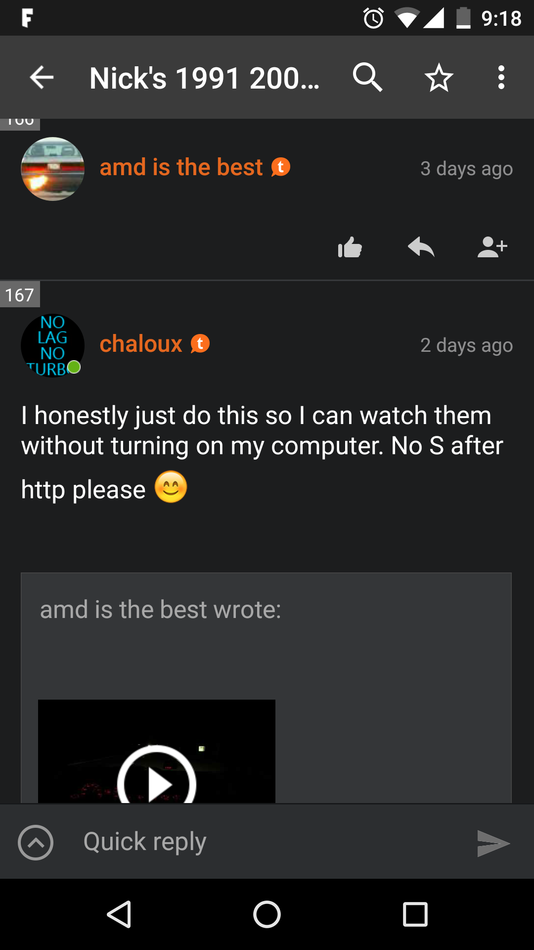

Posted: Wed Nov 18, 2015 8:07 pm
I honestly just do this so I can watch them without turning on my computer. No S after http please :)

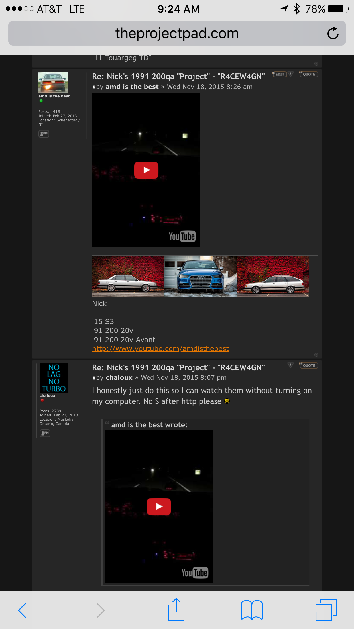

Hmm. Seems to work fine on my phone...
Re: Nick's 1991 200qa "Project" - "R4CEW4GN"
Posted: Fri Nov 20, 2015 11:36 am
Looks like you're using a browser? Matt's talking about tapatalk users.
Posted: Fri Nov 20, 2015 2:09 pm
app needs 'secure' connection - I hope there is more flogging posted soon
Posted: Fri Nov 20, 2015 5:39 pm
Yeah from within Tapatalk specifically.
