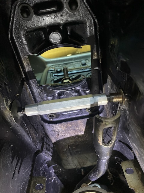

by rennenmsports
Bruce lee’s 1 inch punch to spread the transmission tunnel for the 01E 6 spd

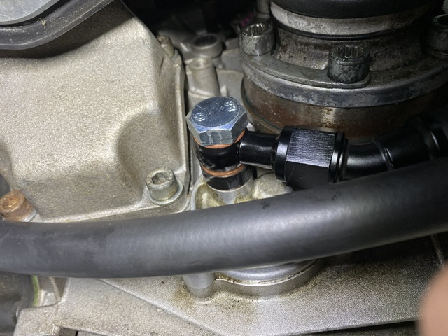

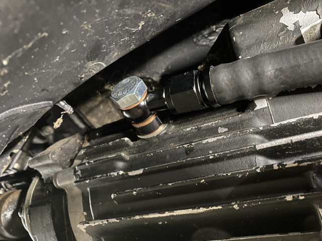

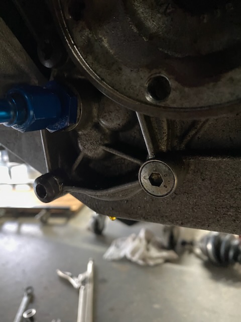

by rennenmsports
I used a counter sink bit to be able to use a flat headed taper bolt so I can install a -10an banjo fitting for the transmission cooler

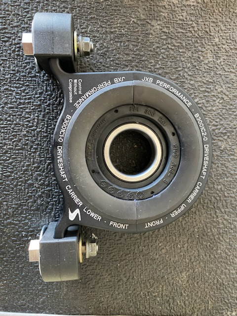

by rennenmsports
Rebuilt prop shaft center support
Bearing from McMaster carr 4668k295 works

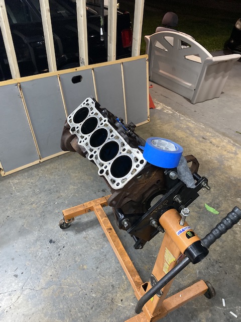

by rennenmsports
The new coils solved the issue only it lost a lot of compression due to piston ring failure. I finally am able to start removal and disassembly of the entire engine this time.

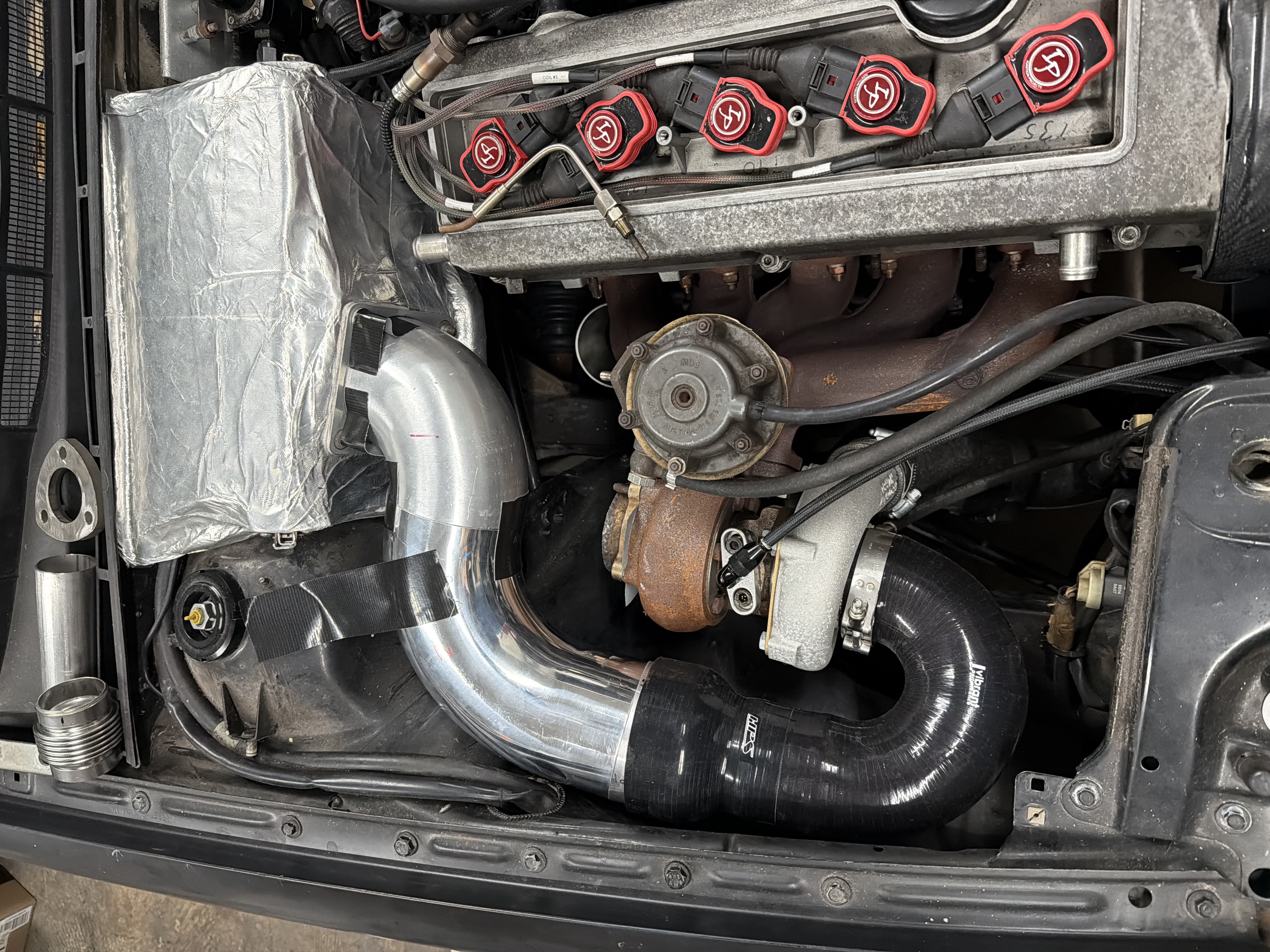

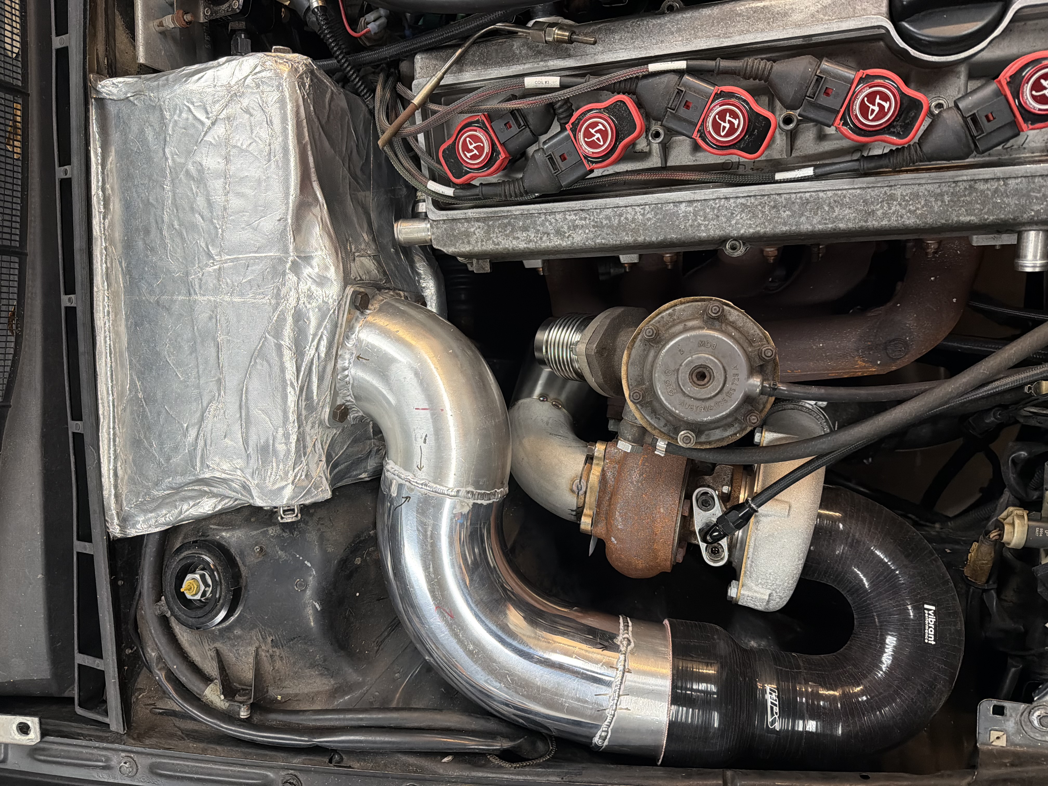

by rennenmsports
I pushed her back into the garage on the first. Happy new year everyone. for the third time around. This time I’m getting a short block professionally built. Didn’t have much luck the first two times. I’ve gotta make the intake and exhaust first so we can tune it properly. The intake tubing was easy. The down pipe on the other hand won’t be. I’m using 2 1/2” schedule 10 304ss pipe.

by rennenmsports
Making a downpipe is much more difficult than I thought. A new found respect for fabricators. Here’s what I got so far.
Re: Andy's 91' 80q
Posted: Tue Jan 27, 2026 9:27 am
by rennenmsports
It fits :D
