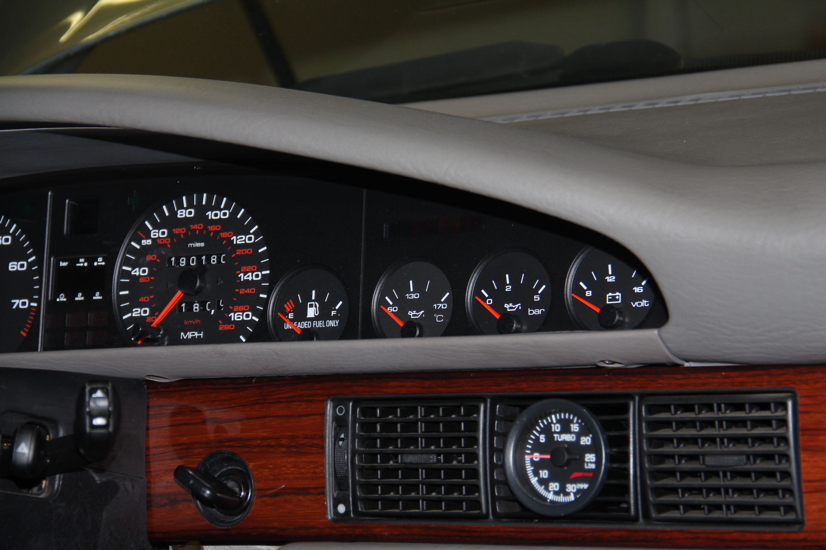

I've got mine vent mounted! I think it's the most aesthetically clean option, and, though my A/C hasn't worked it years, the other vents remain fully functional and retain the same flow.
My only complaint is that it does take your eyes further from the road than I'd like. Not horribly, but I'm planning on switching it with one of the less fluctuating gauges, such as voltage or oil temp. If you wanna play around with it, I can send you a spare vent from my stash so you can always go back if you decide it's not for you.

I have mine vent mounted and I like it quite a bit. I have it set up so the vent open/close functions properly and since its three vents all attached to the same duct I really don't think it impacts the hvac much.

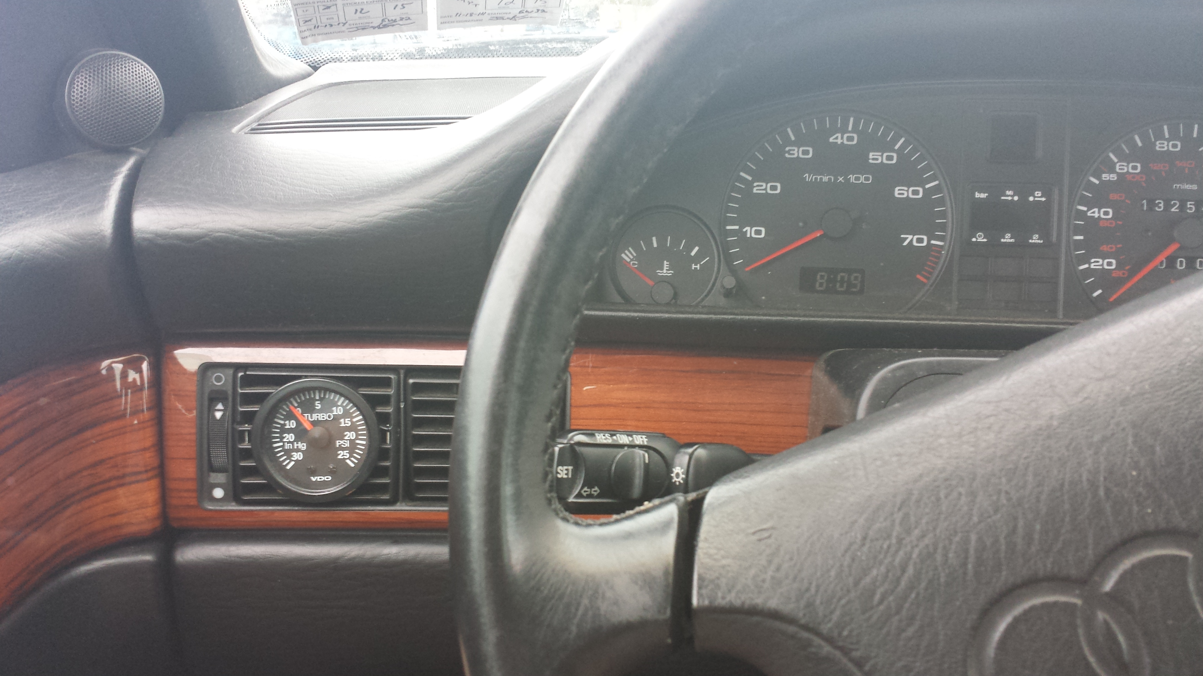

This is also how I've done mine.Aktapod wrote:I've got mine vent mounted! I think it's the most aesthetically clean option
I will say, some light bleeds around the edge of the gauge face (it's a VDO boost gauge) which can be distracting...

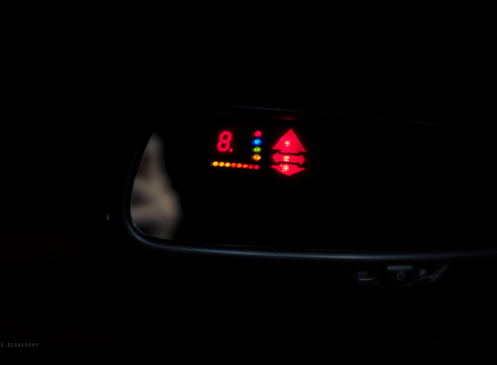

That mirror gauge is awesome. I would like to put my radar detector and a wideband display there. That'd be awesome!

I did a custom install of my v1 display behind a b7 mirror... i have a bunch of pics to do a writeup at some point
I'm going to ask radar mirror.com if they can do custom auto dimming conversions to our rear and side mirrors, integrate a wideband, and my radar! That'd be a tall order, but you never know...
I checked them out but I wanted to keep an OEM Audi mirror and they don't have anything for Audi specifically...plus they are really expensive. I will say that DIY was a lot of work, but definitely worth it.

The hidden displays only work with a certain type of translucent/2-way mirror glass. Audi didn't start using it until B7 cars. So they would have to cut custom mirror glass to fit into t44 mirrors (might be possible?)
This is a b6 mirror for example...you need to actually remove the mirroring surface in order to see through (this person added a boost gauge to a b6 mirror):
On B7 the mirroring surface is sandwiched into the glass, you only need to remove the backing material to make it translucent:
