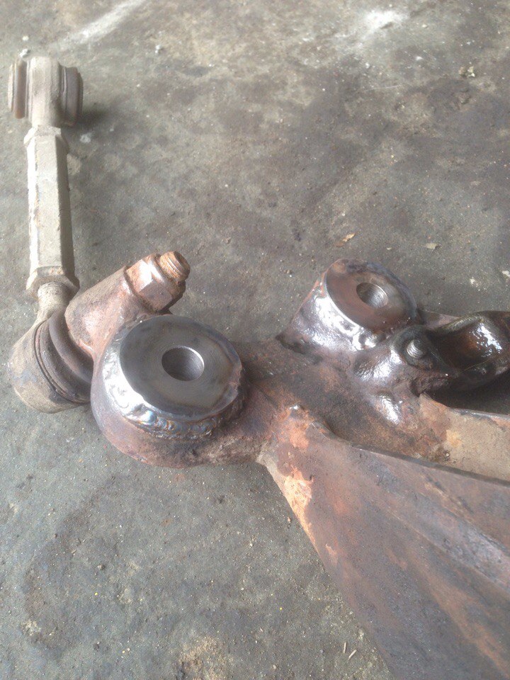

Поставил стальные втулки в подрамник. Надо ждать лето.
Руль разве что острее стал.
На дороге поменьше мотыляет. Не пытается поехать туда куда ей хочется ..

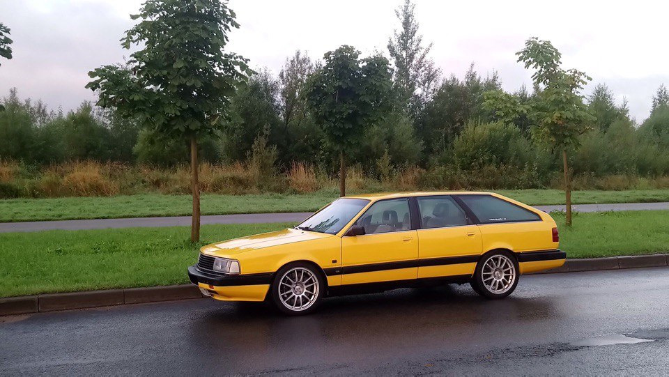

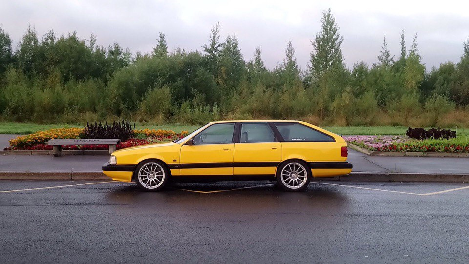

I never would have thought I would like the Avant in yellow, but it looks great!

I like the new color, definately unusual for typ44.
Maybe a chiquita logo on the side just for the fun? :)

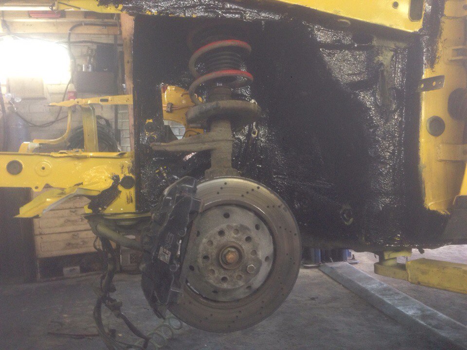

This project is insanity! The Big Brake conversion is amazing, in line with every other modification that you do to the 200. I would like to read more about the Big Brake change, what donor car is it coming from? I really enjoy following your project, always inspirational.

maxnadri wrote:This project is insanity! The Big Brake conversion is amazing, in line with every other modification that you do to the 200. I would like to read more about the Big Brake change, what donor car is it coming from? I really enjoy following your project, always inspirational.
Thank you. put the car now for restoration. full analysis will be before the body of the body. anticorrosion. strengthening thresholds. And so on...
brakes from the Audi RS6 c5. Spacers are made by native from c5
