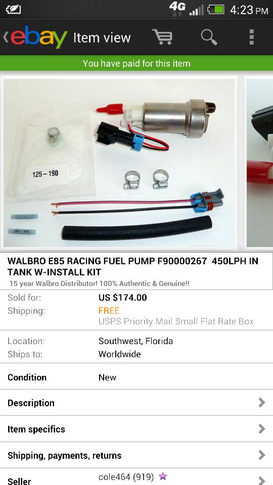

In other news (to divert my attention and keep things going) I purchased a vital piece over the weekend...

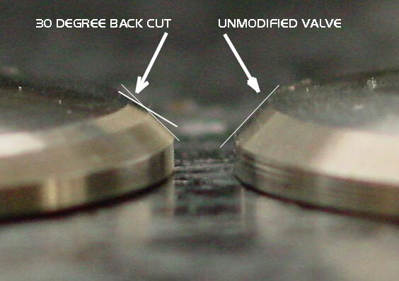

The only possible way to use cut OEM seats on a +.5mm valve is by cutting them in a way where they seal on the bottom ridge of the valve... We've arrived at this by looking at soo many 20vt valve jobs on the internet that had this set up...
Now in essence this is NOT optimal (for flow) as the the idea is to cut open the seat as to seal on the outer most ridge of the valve as opposed to slightly under. In fact he actually feels as the end result will not be that much of an improvement over a stock valve unless you get re-seated.

Your conclusion is sound, though the testing I have seen in the interwebs still shows a gain in flow with the seat lower. Ideally, the seats would be changed.
Re: A tale of Rubí...PTE5862 .64 a/r Received, Head Rebuild
I'm sure there's some improvement but he feels as though a stock port, stock size valve that's backcut like soo...
... would flow better as there's .5 less valve area the that air has to move around as the overall port isn't enlarged, just the seat perimeter. He recommends this with super light diy porting as the best combo.
In my case I will no longer be able to backcut the valves as that's where they will now meet on the cut OEM seat. As opposed to seating on the outer ridge coupled with a larger seat and port.
In other words anyone who's put a bigger valve on a stock cut seat has just put a bigger door on a the same sized opening just modified to close properly. And if any gain has been measured it's probably more because the OEM seats now sit lower creating a marginally larger opening when the valve is open.
Heck he even went as far as saying that some people don't even measure cfm on a forced induction car, they measure airspeed instead... So yeah, I'm chasing that 10hp dream... :cry:

The GOOD NEWS is that the shop called me just now...
Shop: "The hurdle faced on the exhaust side is not the case on the intake side."
Me: "ok"
Shop: "We were able to properly seat the intake valves on the outer most ridge of the valve as needed in hi-performance applications and in fact it seems as though someone at Ferrea knew something about this head design from the get."
Me: "Ok"
Shop: "The intake valves come backcut right out of the box as there is enough seating material on the OE seats for a proper cut and placement of the valve, where as the exhaust sides aren't as that material is needed for seating, so there will be no additional charge for backcutting""
Me: "Awesome"
Shop: "it'll be done later today"
