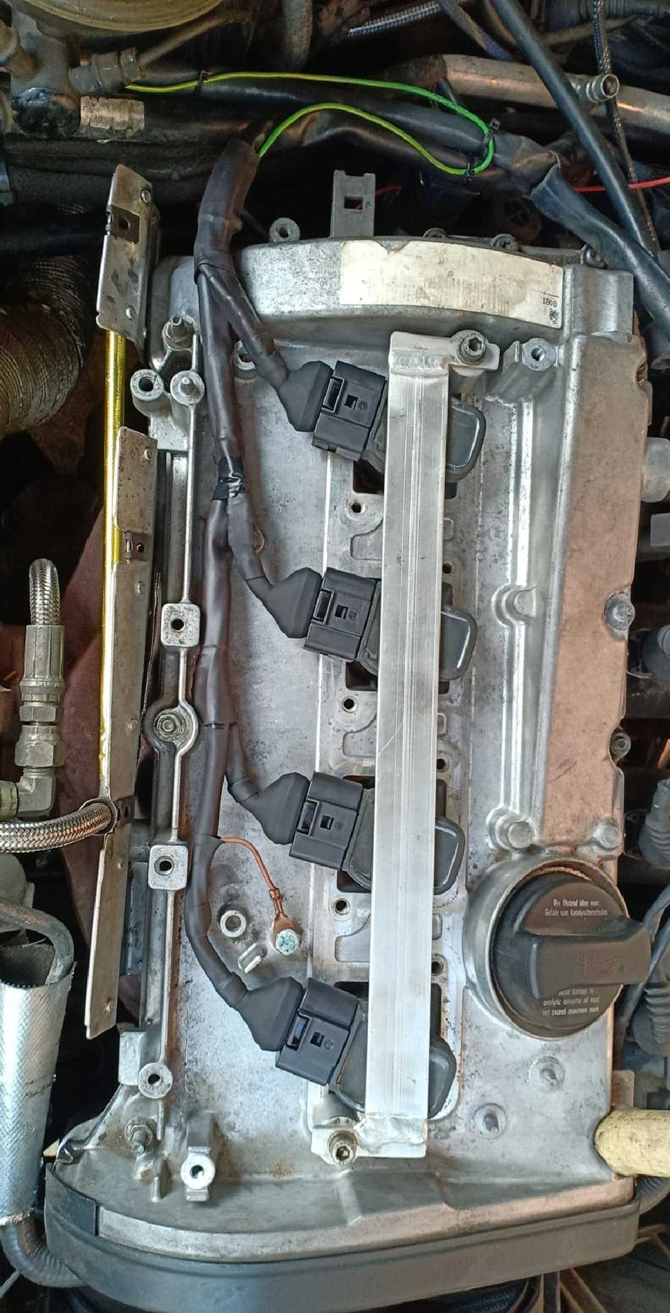

-Coil harness.

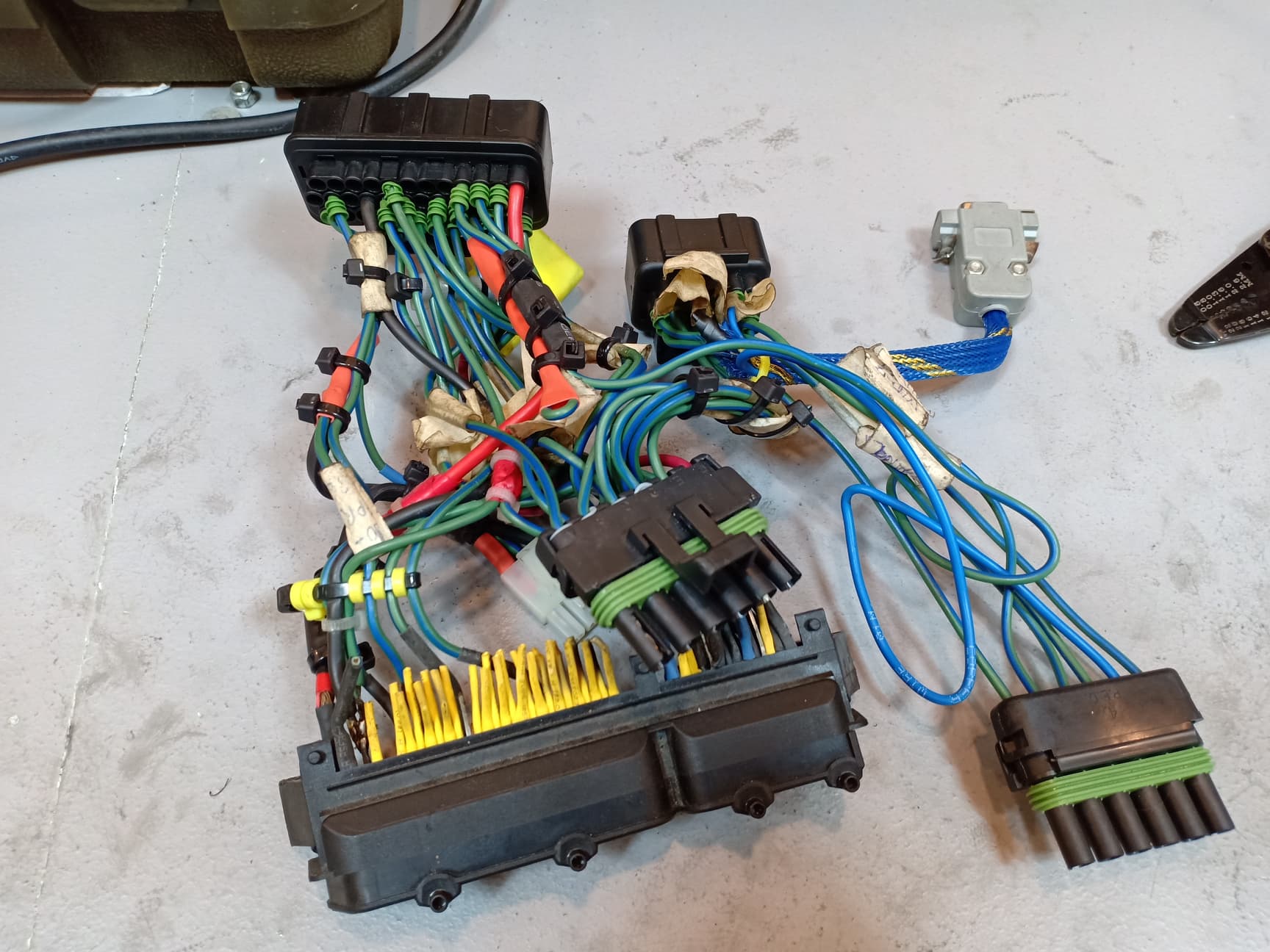

-Motronic to VEMS adapter harness. A serious PITA, but had to be done. See pic of old adapter. It worked, but on inspection it was clear it needed replacement.
Several issues with the adapter harness, but got it to work properly today. Worked for two days to build it. Fucked up a few connections, but managed to fix them all.
I forgot to take a picture of the new finished adapter... :roll:

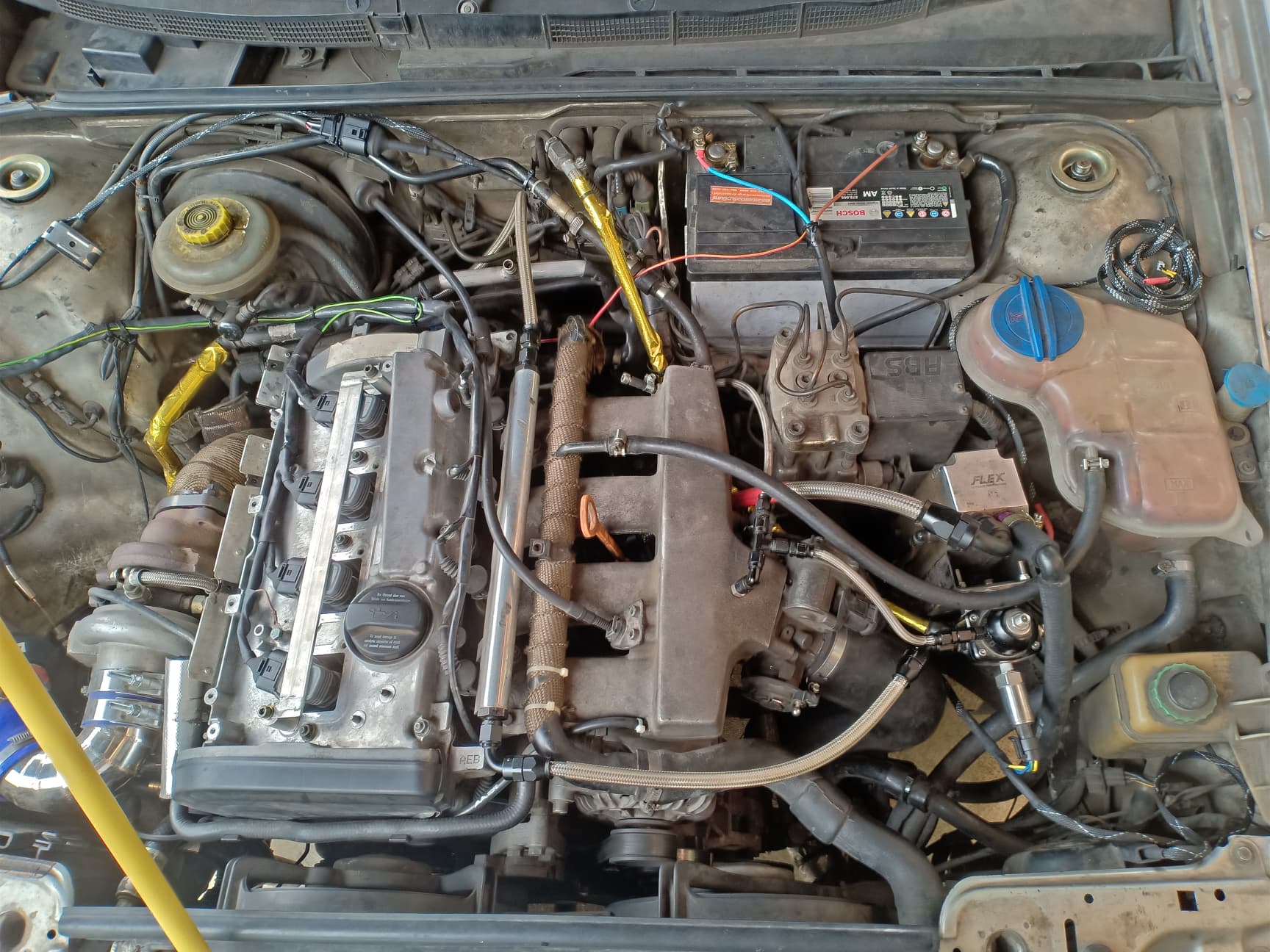

Decided to redo some of the fuel lines.
The feed now goes into the rear of the rail instead of over the block through a 180.
Return much shorter from the front.
And most importantly shortened the signal line to the Fuelab FPR by like half. Hope this makes a difference with control and eliminates the small ridge at around 2800 in the VE table.
See pic. It looks way cleaner than that stupid shit I had before.

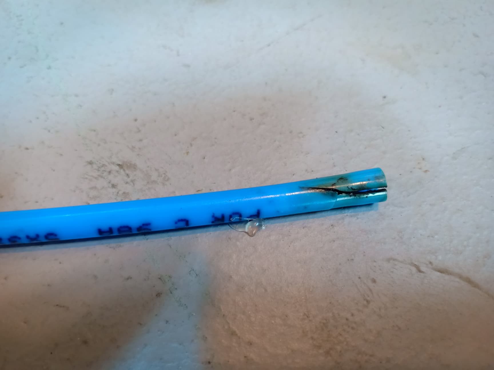

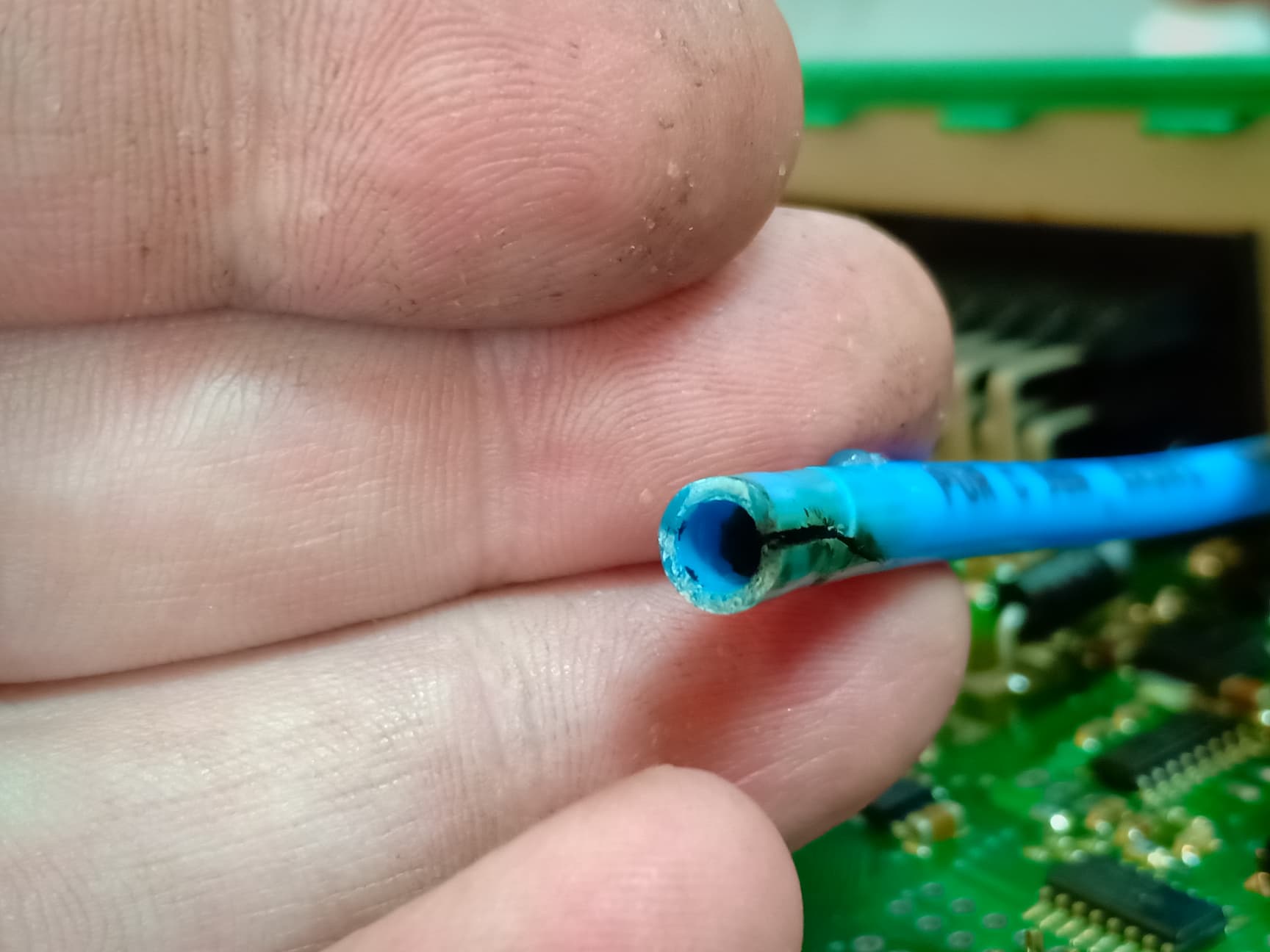

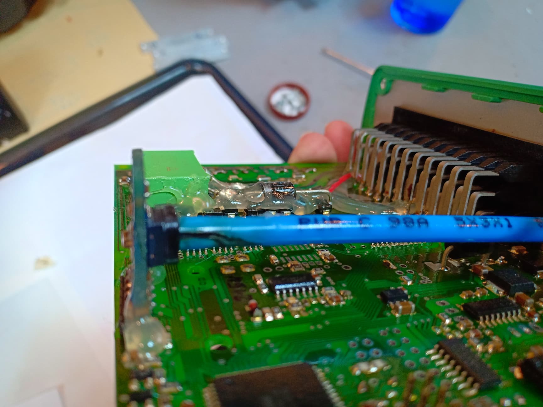

A small but critical part failed. This cause me to chase my tail for a long time even though it ran OK, but could not really maintain boost target. I put that down to the wastegate actuator being 0.5bar stock. I had been hearing a hissing sound from the ECU for a long time, but thought it was normal. Silly me.
However, it tuned out that the little tube inside the ECU to the sensor was borked big time. Luckily, a tuner I have befriended recently from Lithunia is visiting Thailand so, after fixing the issue by just replacing the tube with a silicone hose, we went for a drive where he live tuned the VE table because it was completely wrong.
Before, it idled at 60kpa, now 45. Cruise on hwy before 76kpa, now 60. Boost for days. Maintains 200kpa flat to 6000.
See pics of culprit.

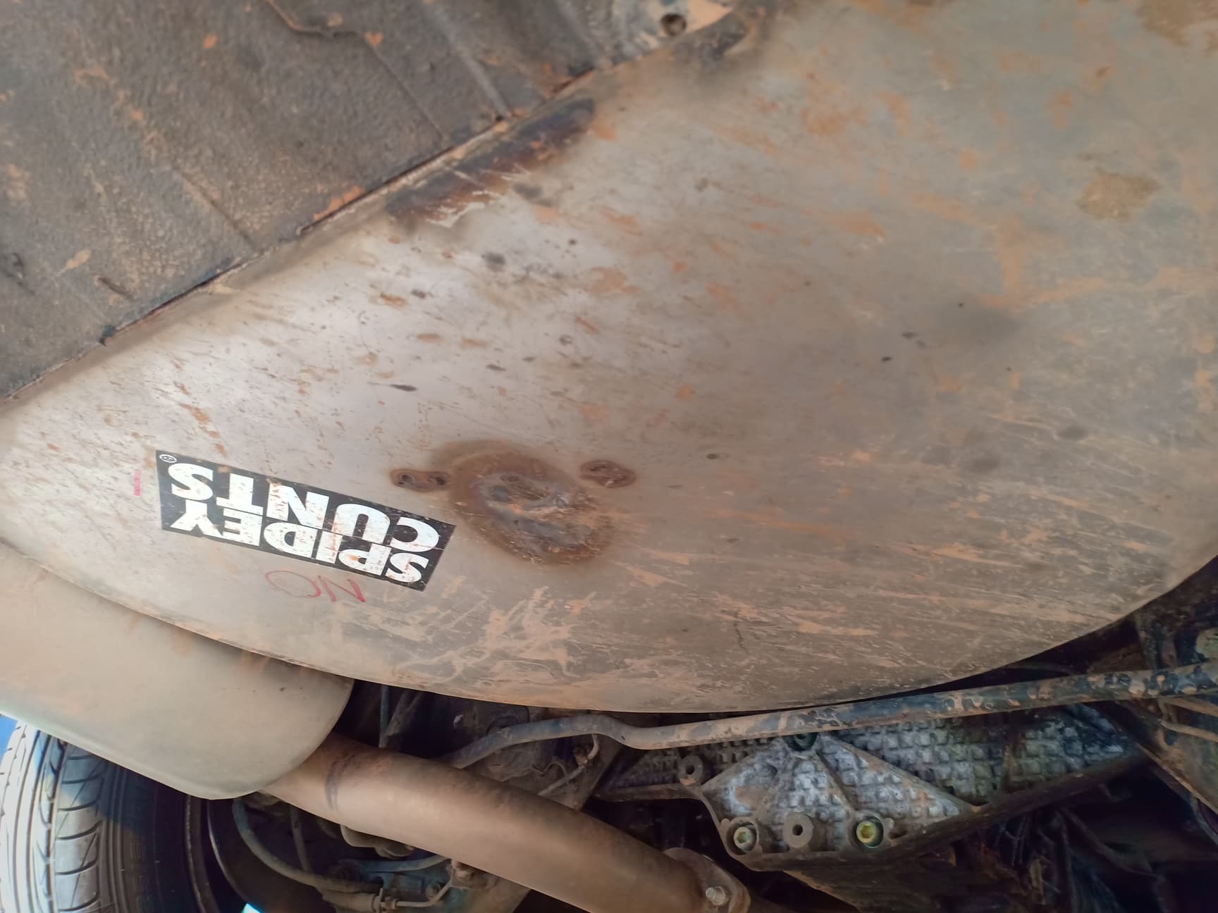

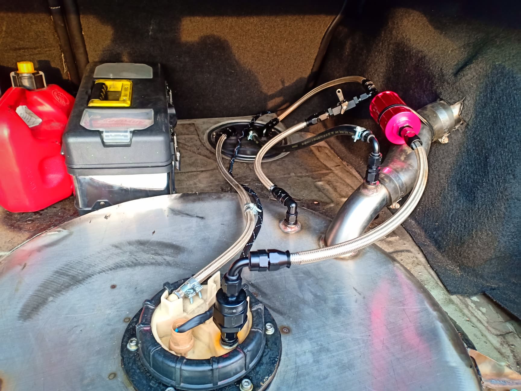

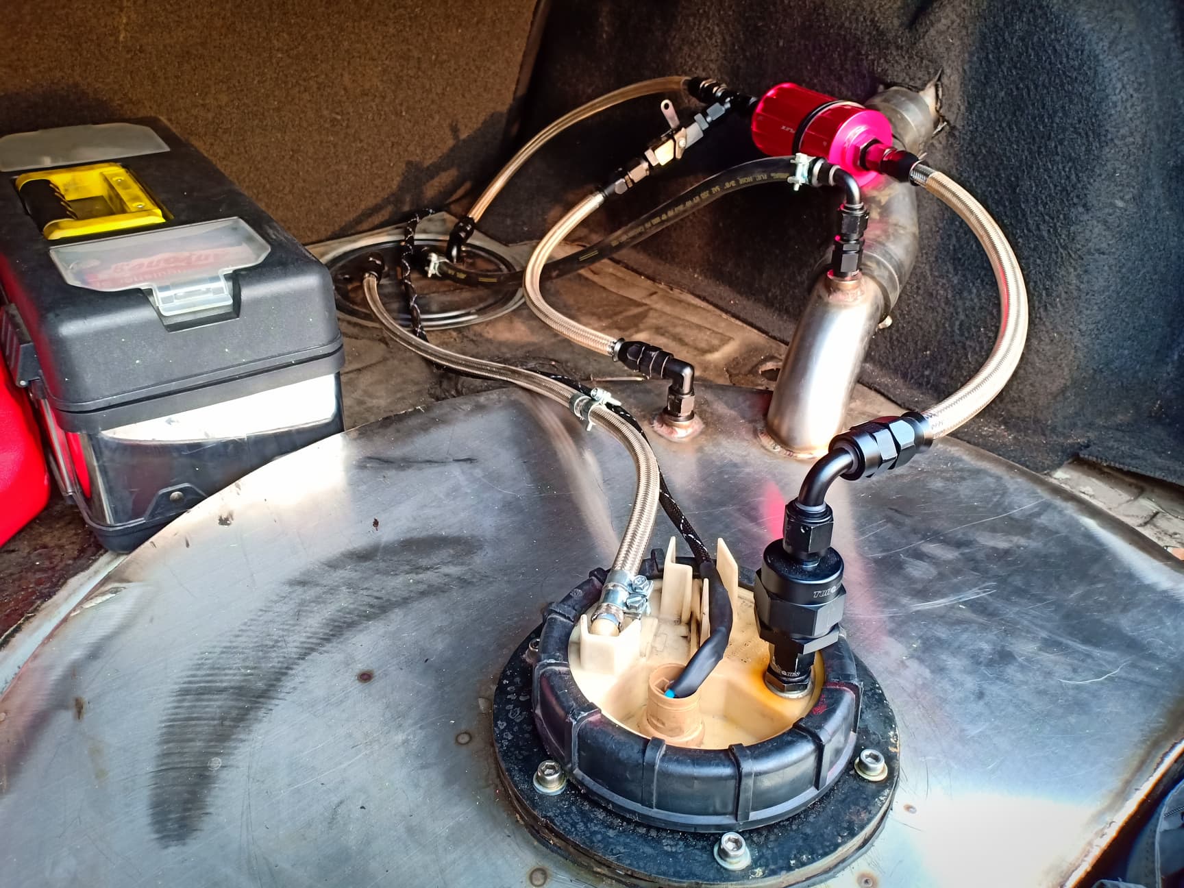

Forgot to post these shots. If you compare the fuel pump wiring from before to now, so much better and cleaner. I spent a lot of time on the previous config too. Shit house :shame:
Moar better now. The relay and fuse are under the back seat now.
Bottom of fuel tank looks bad, but it's just dirt and weld discoloration. No rust.
The sticker is from a hilarious YT channel called juiceboxforyou. Some dudes in Ireland who are crazy about AE86s and other JDM cars.

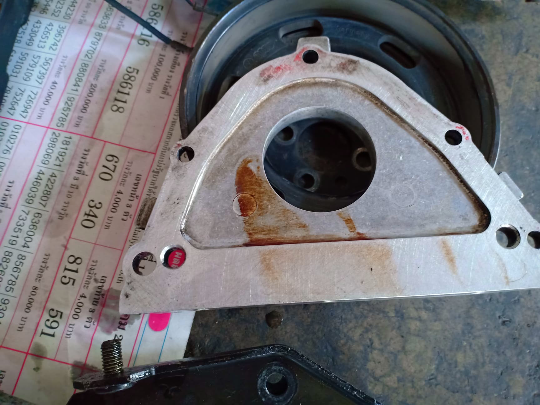

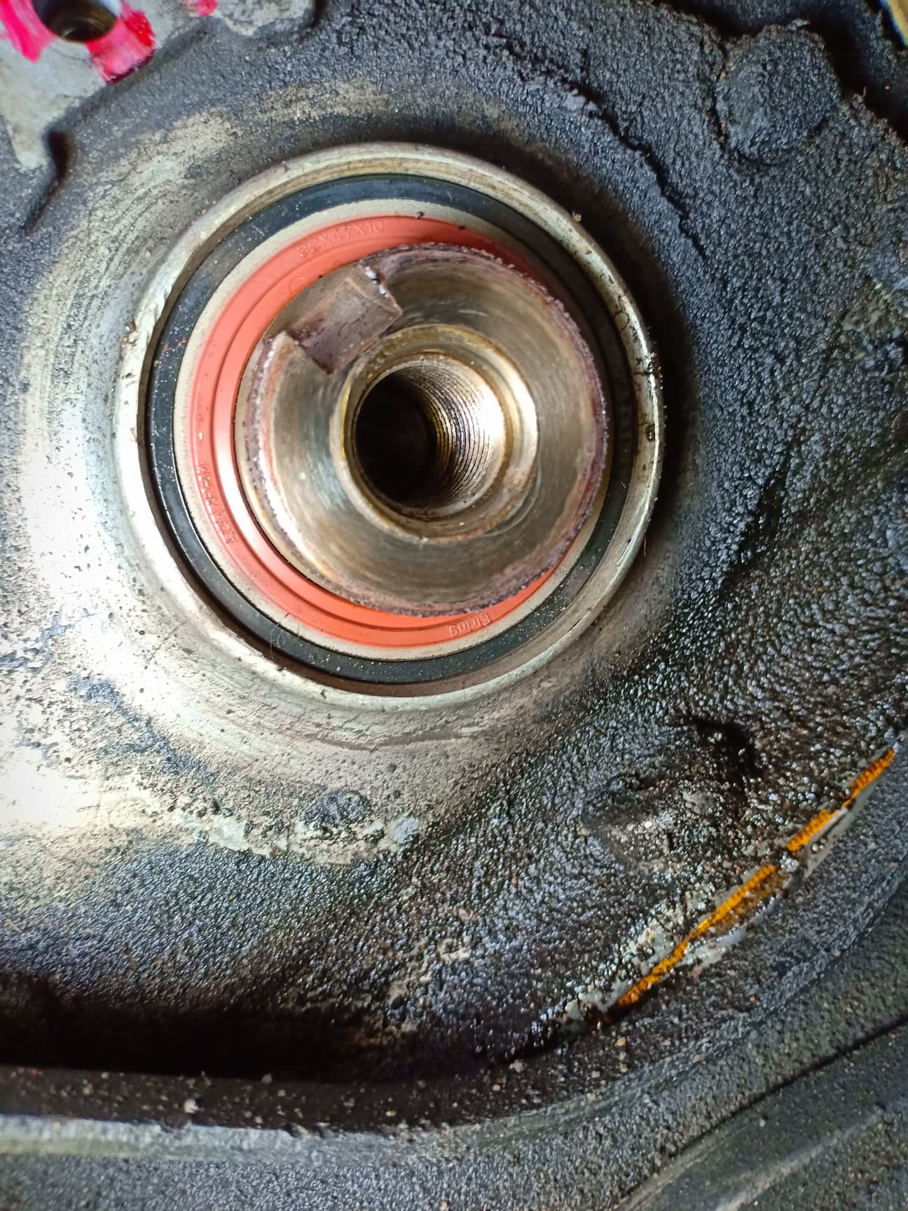

Some maintenance. Had an annoying oil leak for a while. I was fairly sure it was the front crank seal. Not quite.
It was time to do the timing belt set I figured. Good thing I got it done. The water pump belt was about to go. Dry rotted and cracked.
However, it was not the crank main seal that was leaking. I had that replaced about 3-4 years ago, so thought it weird it would leak so soon.
Turns out i was the gasket between the block and the bracket that holds the front main seal.
So, while in there, changed out the timing belt, idler, tensioner and accesory belts.
