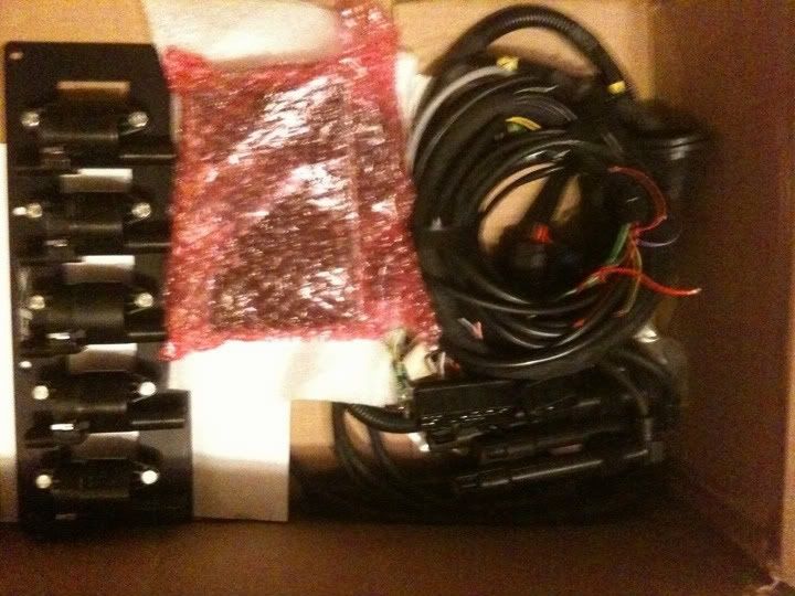

So after months of running the numbers and going back and fourth I settled on VEMS. I was happy with my 034 Ic in the last car and would have loved a IIc but right now, 3 kids & wife in school, the IIc price point was too high. I ended up with the Econoseal V3 from Marc with a VEMS harness and LS2 coils. In all this should be about the same work as an S2 harness but a HUGE savings by skipping the Bosch plug. If I ever go to a IIc it will be easy to adapt the harness. Big thanks to Marc for waiting around for me to make up my mind!

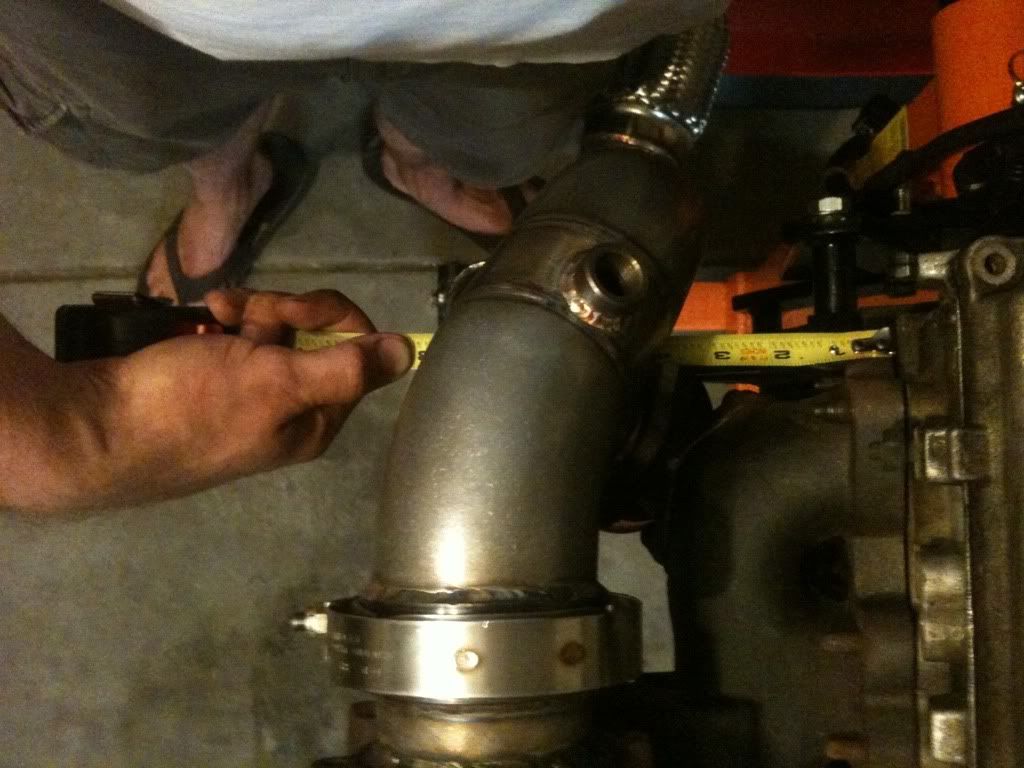

Must. see. the WG dump tube to frame rail. clearance...
Ed's 1991 CQ, H1C, SEMS, work work work!
VWAudi4Life wrote:Must. see. the WG dump tube to frame rail. clearance...
I wish I could put it in tonight!
If it helps the whole thing is <5" wide.

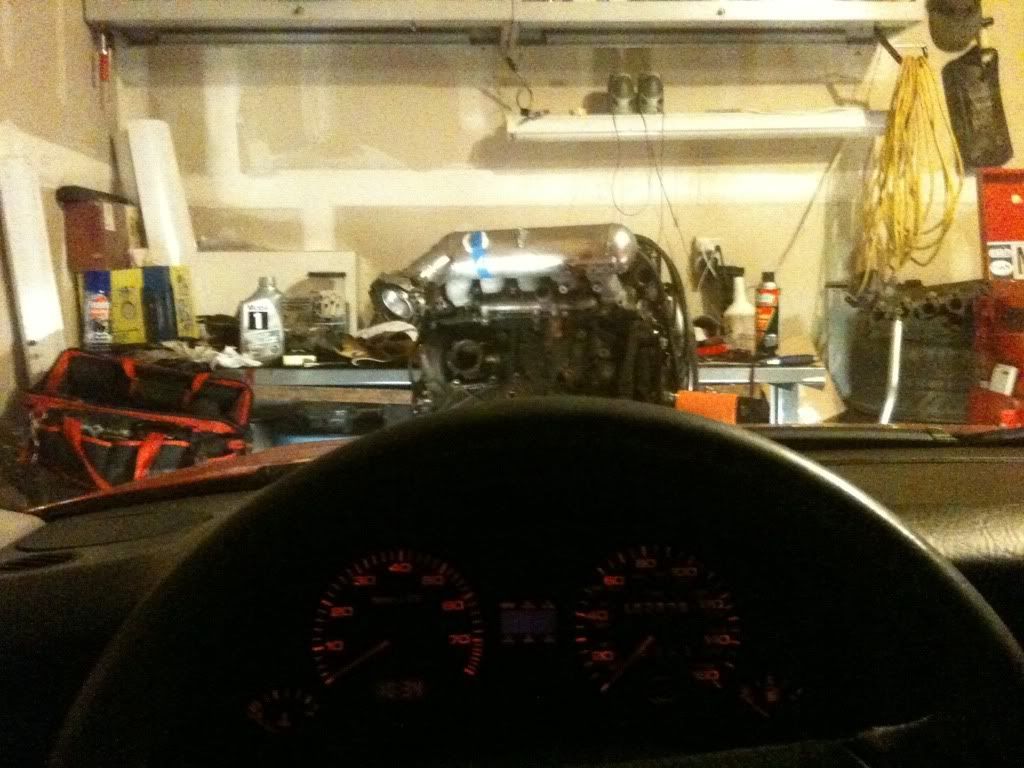

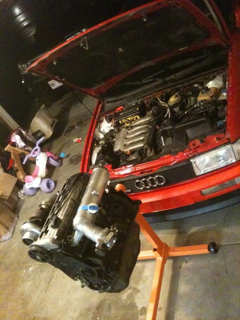

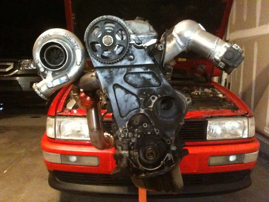

A little time spent...
I had a pic of the exhaust side but the iPhone ate it and everything is packed away now.
This pic is difficult to read but that is an 8 next to my thumb and the WG flex joint can be, just, made out above the stand wheel.
Daily motivation...
I need to pickup some wire (NAPA only had 50' spools) and lock down a whole list of gaskets and such to make it happen. Right now I think the worst case could be a VEMS 7a with Hank's intake and we all know the best case!

Re: Ed's 1991 CQ, H1C, SEMS, work work work!
I am kindof nervous about the frame rail. A few people have mentioned it. It fit in the urq just fine so hopefully it works. :).
