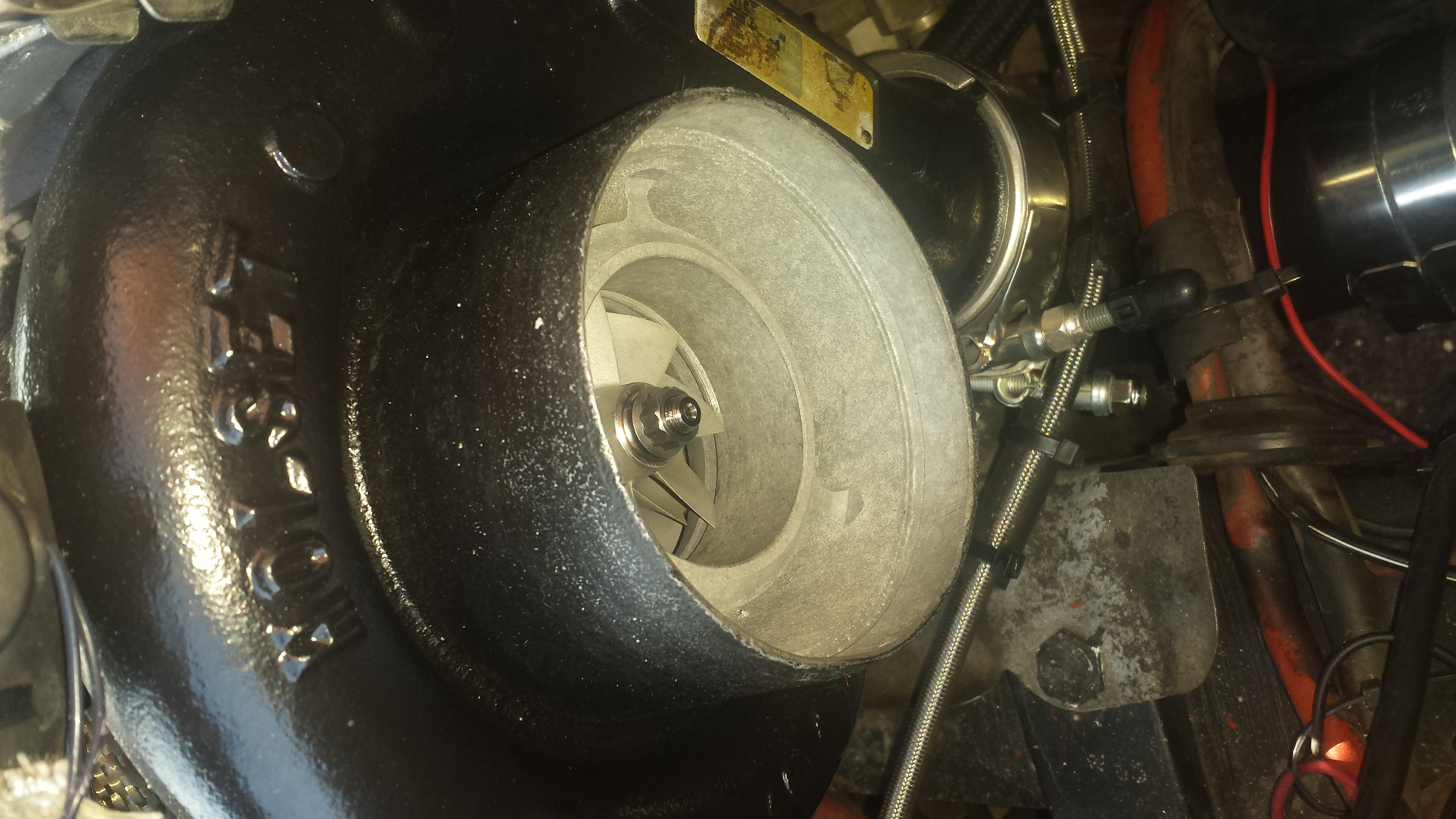

Do you think the bushings would've seen scoring if the nut was tight enough to prevent catastrophic compressor damage? There was only a very slight grazing on one side of the comp cover on the ID. It would be easy to replace them at this point but it sucks. A whole rebuild kit shot would be the icing here lol
Back together and butter-smooth. Night and day difference in threading that Sucker on there. Really put the torque to it this time... erm the CORRECT torque. I always find it interesting that Holset recommends using the loctite as a lubricant between the nut and top of comp wheel. Brilliant lol
- 1461791694654272996818.jpg (3.38 MiB) Viewed 35177 times
Well, it is a lubricant and it is very important to have a known coefficient of friction between the clamping surfaces. There is no way of determining the correct torque otherwise. Holset has great engineering becuase they think about the practical side of things in addition to the crucial engineering.

You can lose up to 90% of your torque value due to friction if not lubricated properly (or at all).
Yeesh! I blame that stupid 6 pt nut. I remember thinking it couldn't possibly be right but I'm an idiot on occasion. The comp wheel it came with wasn't very smooth anyway. I figure this mistake is for the best.
