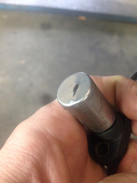

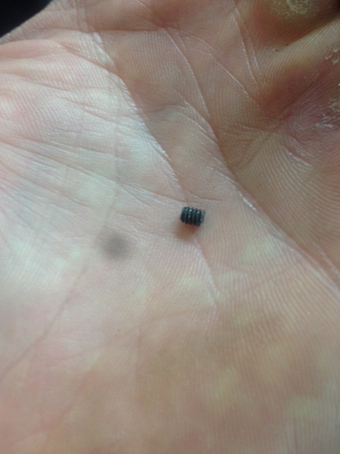

So late in the day we finally arrive at our destination. Enter Apikol. These guys are amazing. I'd heard of them and have even ordered parts from these guys but somehow had no idea that they were in Boulder. If you need service done on your car and you're in the Rocky Mtn region, check these guys out. Troy and Doug are awesome dudes and are genuinely interested in YOUR problems. As soon as I walked in I felt at home. Little did I know, Doug and I are acquaintances from way back in the days when he was racing mtb's. Cool. That's my peeps.
So after troubleshooting the car for about 3 minutes and finding that I'd gone from a weak-spark situation to no-spark, we (Troy) discovered that the 034 trigger wheel was now completely detached from the pulley. Ok, now it was all starting to make sense.. Apparently the miniscule .00000000001mm bolts had somehow managed to shear off
. 034 has never heard of this happening but on a positive note, they ARE now for some reason producing a "Now Improved" version of their product that has never failed.
I believe the wheel started coming loose, as evidenced by the groove worn into the CPS sensor. Anyway, didn't have much choice but to have Troy work his magic and re-attach/weld the wheel to the shitty potmetal surface of the crankpulley with absolutely no guarantee of how long it'll hold. Well, it held long enough to get me home and may well hold up for the rest of time? I'm investigating a better solution until that time comes.
. 034 has never heard of this happening but on a positive note, they ARE now for some reason producing a "Now Improved" version of their product that has never failed.I believe the wheel started coming loose, as evidenced by the groove worn into the CPS sensor. Anyway, didn't have much choice but to have Troy work his magic and re-attach/weld the wheel to the shitty potmetal surface of the crankpulley with absolutely no guarantee of how long it'll hold. Well, it held long enough to get me home and may well hold up for the rest of time? I'm investigating a better solution until that time comes.

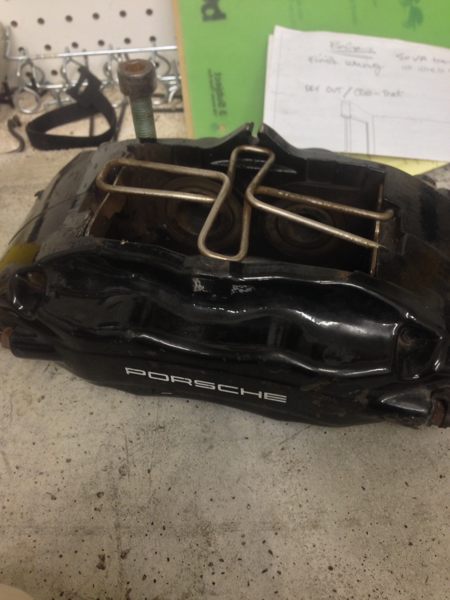

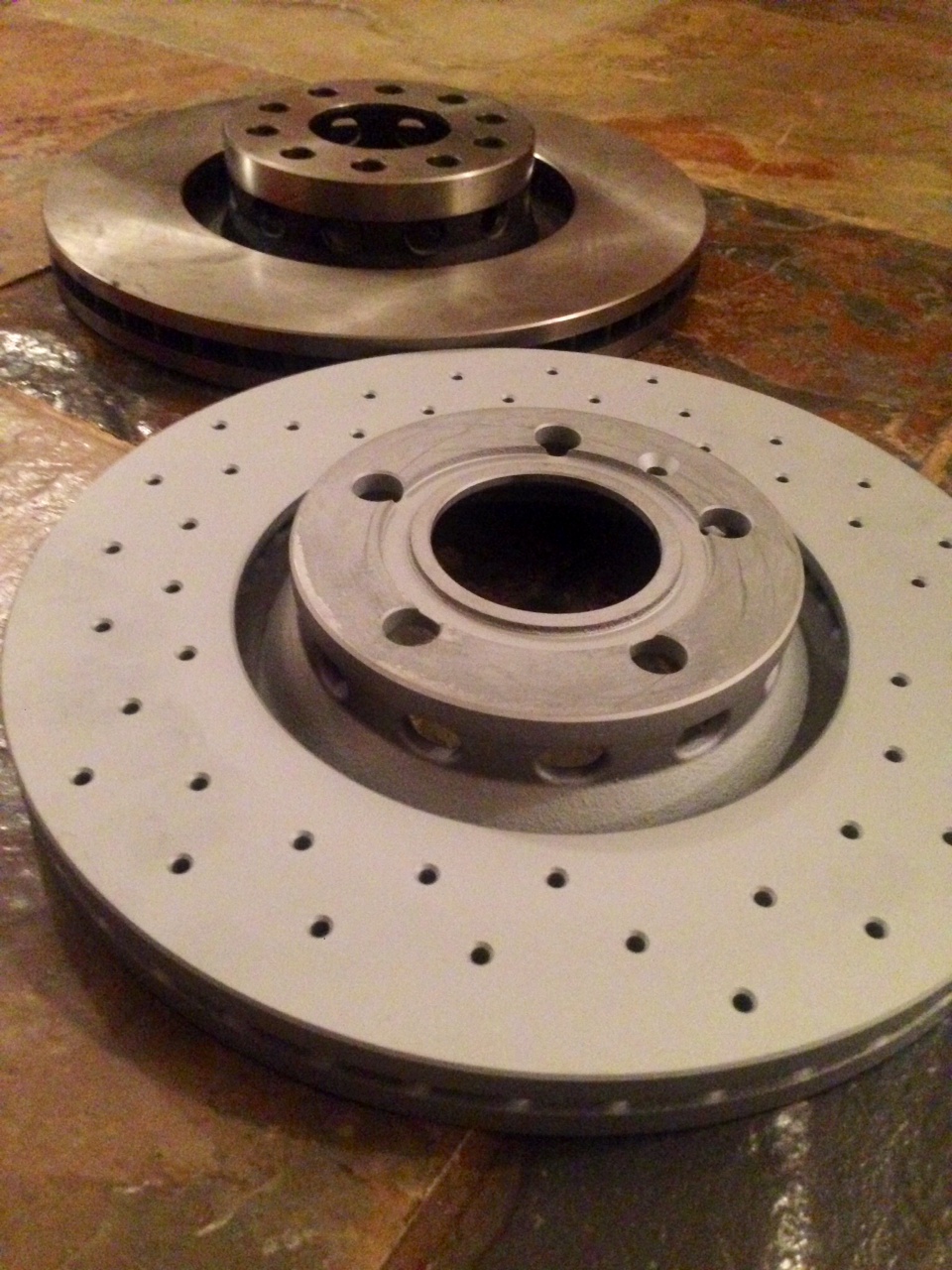

Ok moving right along. I got home without a hitch, massive thanks to all the kind people that helped me do so. You guys are awesome, the community is so great.
I got home from the hellacious return home and drove the car for about a week. Even before the launch control novelty had worn off, I had the car on the lift and torn apart. I couldn't help it. The car was scary without real brakes. Upon returning home I started compiling the list of parts necessary to not only install the 993 BBK onto the 4000, but do the 5 lug conversion outlined in several places on this forum. I sourced a pair of URS4 uprights, Audi 200 (auto) front hubs, new wheel bearings, 5 bolt hubs, 19mm ball joints, MK2 tie rods, 4000 rear axles, etc, etc...
Unfortunately, the shop that was pressing the new wheel bearings/hubs into the housings, messed up and pressed the old 4 bolt hubs back in. In the process, the brand new wheel bearings were obviously ruined while being pressed back out. They made it right and ordered a new set of wheel bearings for me but this set me back another week.

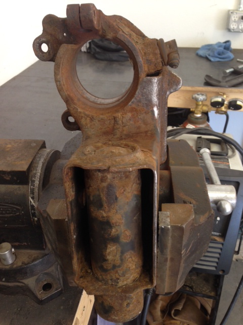

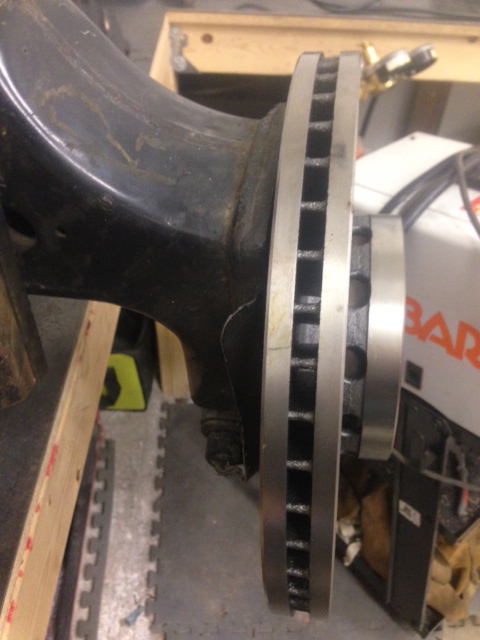

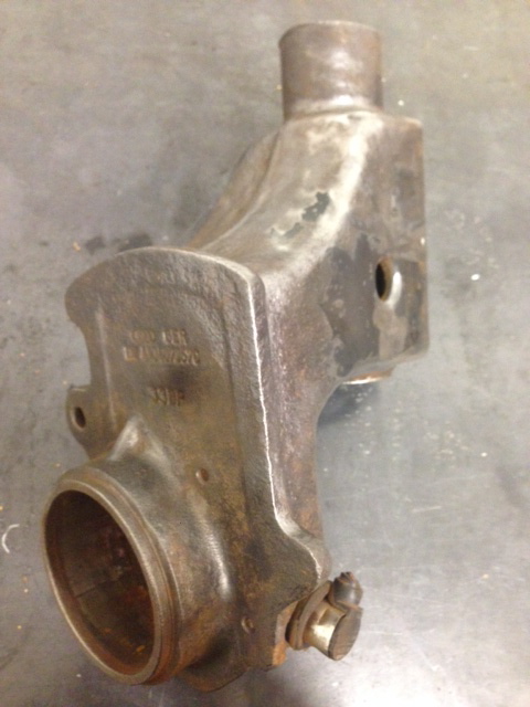

So here are a few pics of the progress. I chopped the URS uprights and cleaned them up a bit. Once housing was just nasty with corrosion so I cleaned it up with the wire brush wheel and my media blaster, then primered and rattle canned it black. It'll do for now. I also found that I had to work the inside of the URS housings with a brake cyclinder hone to get the 4000 uppers sleeved down far enough to be at the right ride height. I clocked the steering arms in about 1/4" from stock location and will slug weld them as done by those before me. I really wanted to retain the coilovers that the car had and also use the BBK that I got from Chaloux. So far so good but I haven't received the new wheel bearings so the project is on hold for a few days.

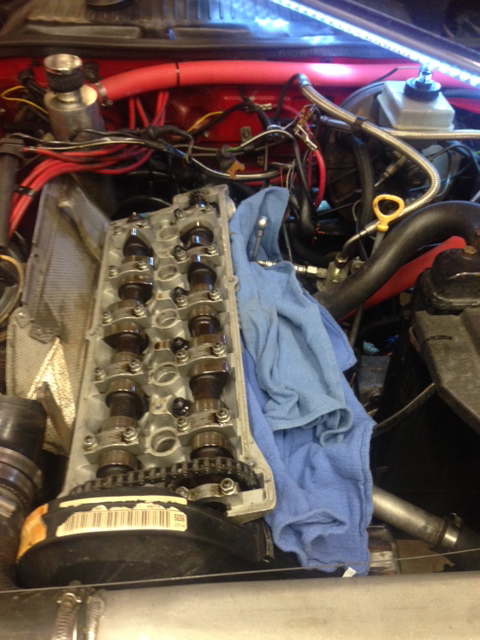

Then I decided, while the car is down, to do something about the horrendously, hideously, gawd-awful color of the rattled-canned intake manifold and VC. I just couldn't look at it anymore. No offense Matt, I know that's what you had in the garage. Run what ya brung and all that.
So I pulled the fuel rail, VC and Intake mani and have them off at my buddy's shop for powdercoat. That'll make me (and 4FoxSnakes) feel much better about ourselves.

The 323x30mm A8 rotors I initially ordered had the wrong offset (rotor height) and were not even close to being right. I measured the distance from the center of the hub to the outer limit of the 993 caliper and also found that I needed a 312mm rotor. I did some searching and found these Zimmerman Sport, c-drilled rotors with a 46mm rotor height as opposed to 60mm on the initial A8 rotor that I sourced. They just showed up today so I'll head to the garage tomorrow and check the fitment. I'm going to assume these are a go. I hope.
- photo 1.jpg (106.38 KiB) Viewed 38757 times
- photo-183.JPG (439.38 KiB) Viewed 38757 times

Plus the Zimmerman Sport rotors are 4lbs lighter, bonus. It'll help offset the weight of the Ronal R28's I'm hoping to use. These weigh 28lbs each, ouch! The SSR's on my E30 M3 weight 17lbs. The 4000 also has +100hp advantage over the M3 though so I guess its acceptable
- photo 3.jpg (97.95 KiB) Viewed 38754 times
