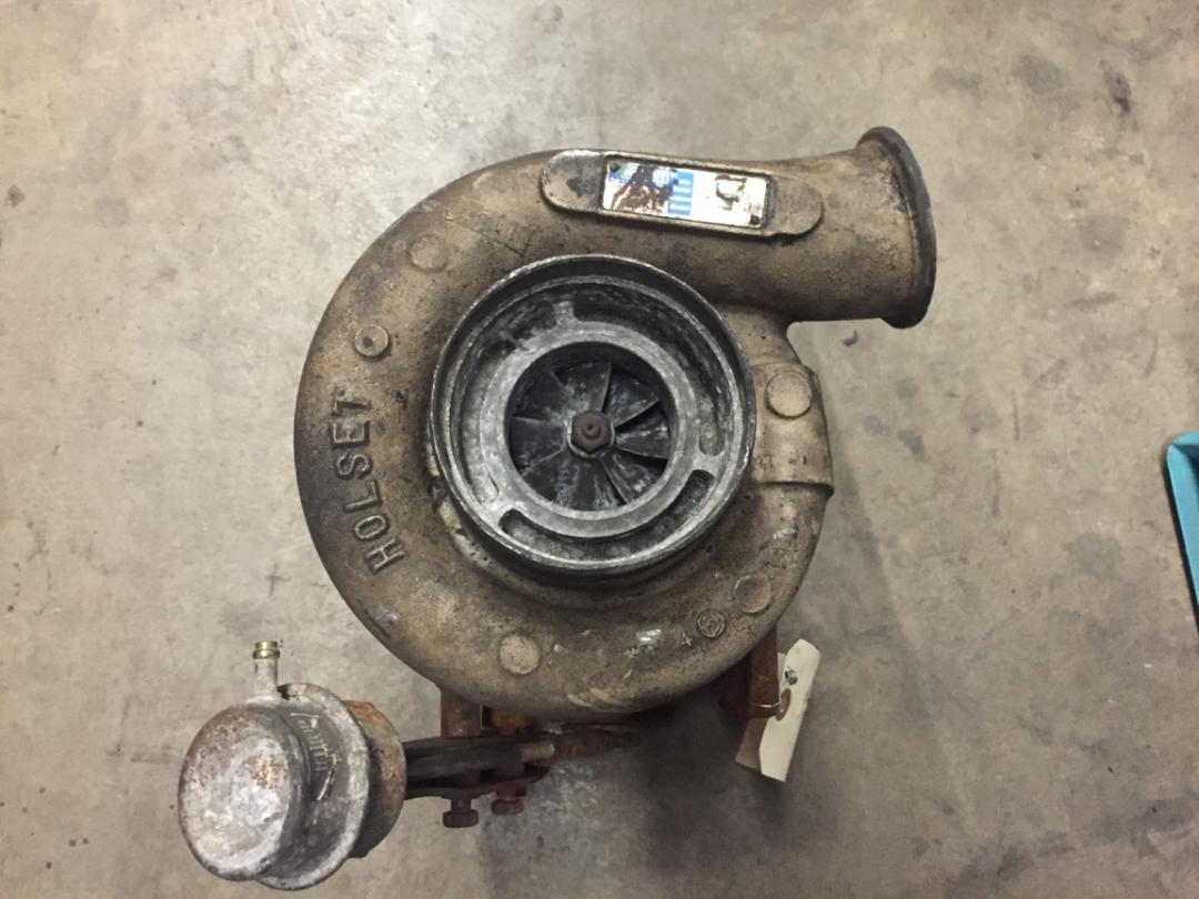

Uh oh, it's a 6 pt nut. I don't want to get it balanced so I guess I'll be very diligent about marking all the assembly parts for alignment. Afterall, i did just order the rebuild kit. It's also dirt nasty. Hope I can clean it up easily.
I do find myself wondering if the supplied 12 pt nut in the rebuild kit has the same thread/pitch as the 6 pt and if I can change them but that seems risky considering balance and torque differences. Screw it I'll just reuse the nut
Is there something I should know about holsets with 6 pt nuts?

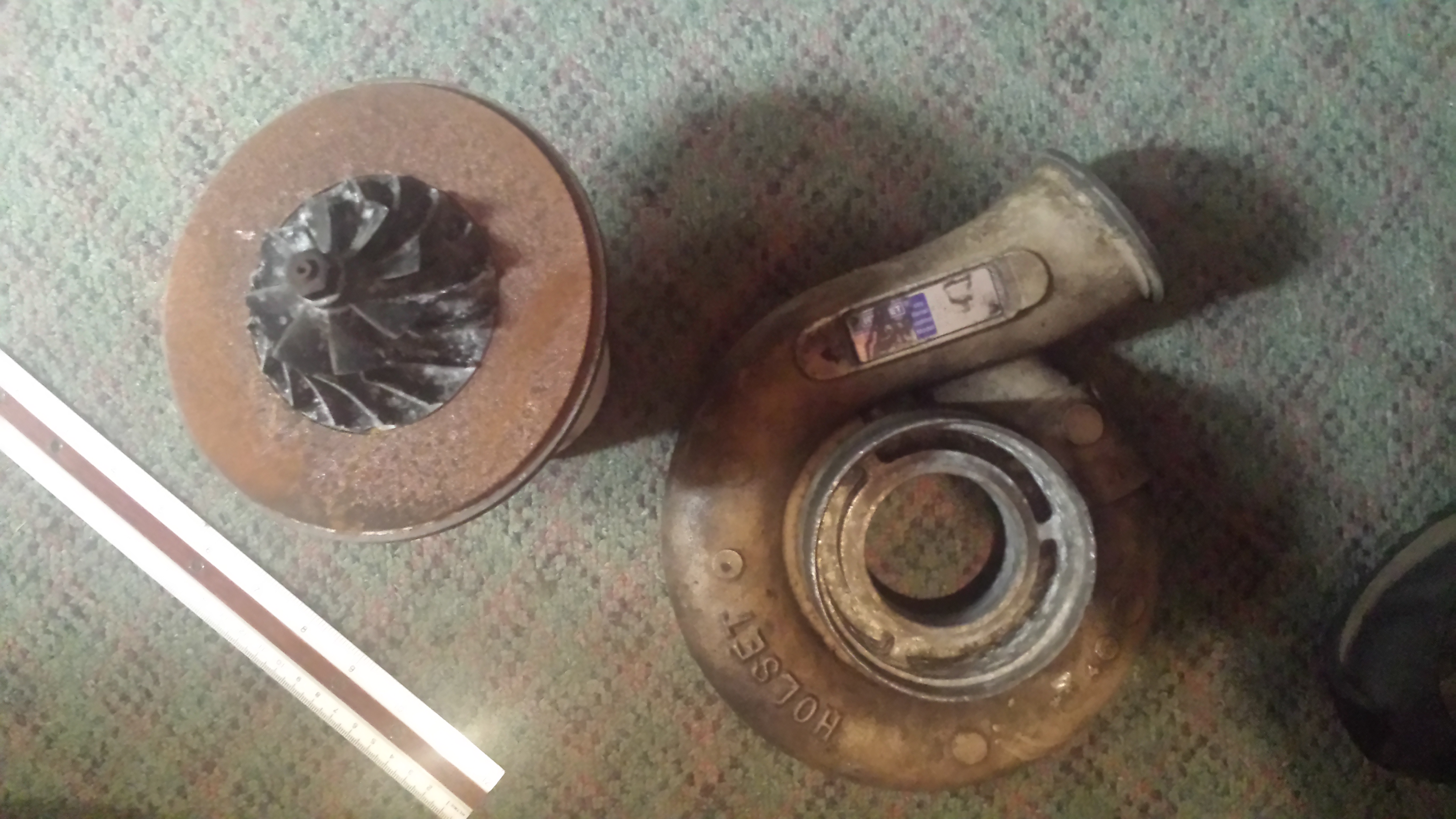

I've got a happy story here for yunz guys :D
Those guys at G&A don't even measure the inducer of these turbos before shipping them (apparently). I just eyeballed the new one with a ruler to the tune of ~2.1875 with a RULER. Sucker is 55.5mm bahahah! I got the monster hx35 on the 2nd shot. Pretty sweet.
However, this snail needs some serious love :(
I suspected it was much bigger when my 54mm comp housing wouldn't fit it either. You know, the painted one they sent that I was hoping to use on this one. This should clean up good still I think.
