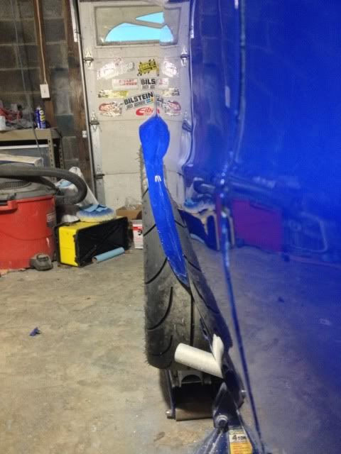

thinking ill sell off the ROTA slipstreams that i was saving for drag radials. and just rock 275/40/17s all around mickey thompson drag radials.
rears fit. the fronts hit the steering. so spacers will be needed, or perhaps a hub swap from the 90Q hubs to the CQ hubs ive got laying around. we shall see this weekend.

or move the steering arm mounts off the strut inboard further like the KW coilovers do. get them away from the tire.
that is what i am looking to do, but i am going to use some rear strut housings as they have the larger diameter caps. since you will be building new strut housings for the coilovers, its actually pretty simple thing to do. but i am going to have to do this for the 26's if i change to them.
it may affect bump-steer or something i dont fully grasp (or care about actually for my intent and purpose) but its a solution. and if it were a bad one would a company such as KW sell them modded like this??

i also thought about cutting and turning the upper steering arm mounts. but i think the CQ hub swap will give me more then enough room to do what i need to do. plus pushing the wheel outwards a tad closer to the fender line will give me hella-flush scene points.
