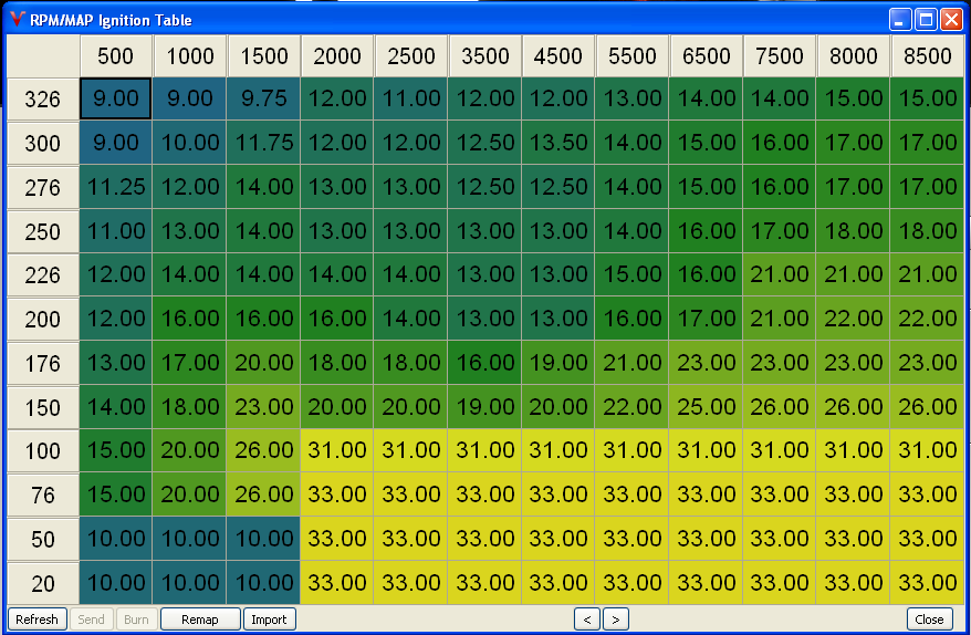

Re: Nick's 1991 200q Project - QUAT44RO
can you post a screenshot of your pump gas timing map? MERCY! :)
amd is the best
Posts: 1431
Location: Schenectady, NY
Post by amd is the best »
See attached.
93 Octane Timing
93 Octane Timing

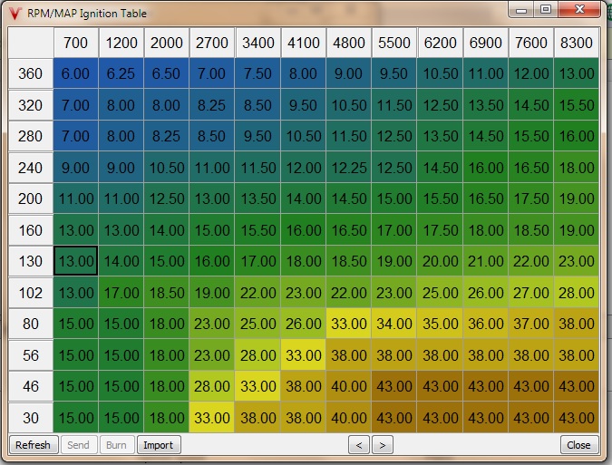

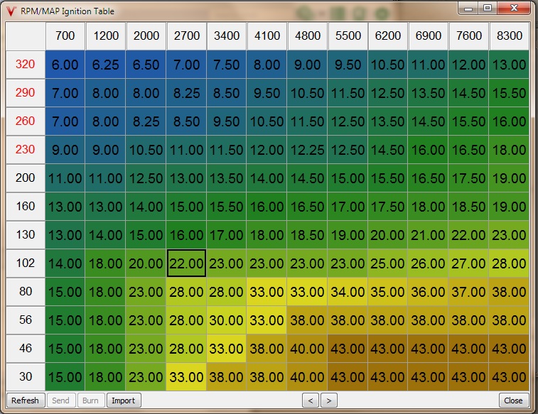

thanks nick. This is what I had before:
before
before
timing map before.jpg (170.54 KiB) Viewed 27454 times
and after:
after
after
timing map after.jpg (221.38 KiB) Viewed 27454 times
You had a ton more timing down low. So I added some. And you also had a few more degrees once in boost, but I left mine the way it is for da safety. I wonder how much the added timing will help around town cruising. Probably a lot.
