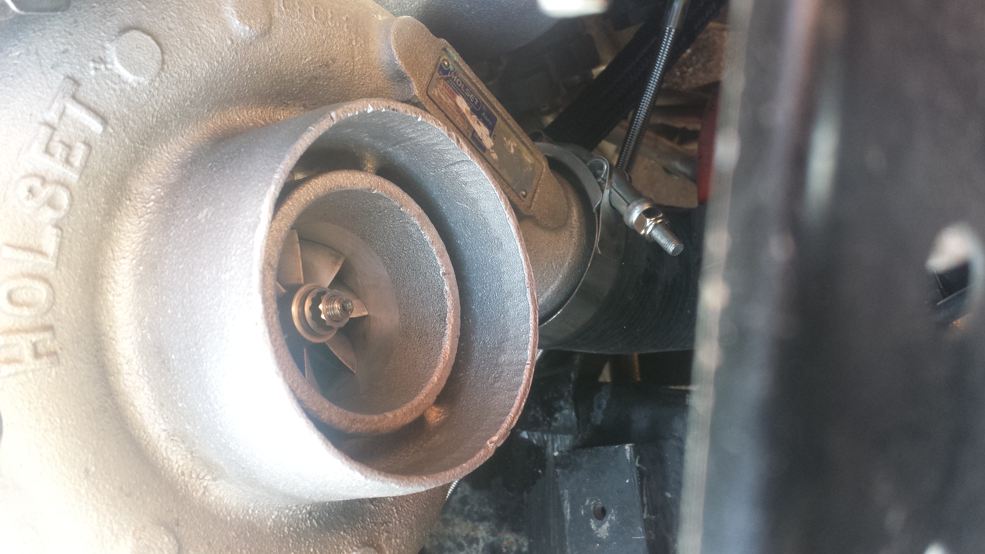

You have a good point magellan. I'm cooking the air probably enough to keep the water vaporized. I don't think I have rm on the other side so I think I'm stuck wrapping the DP
When I see you say "groove" I picture an area in the turbo inlet, except in the larger ID area of the outer hose clamp area, where a c clip would've held the silencer ring. A look over while cleaning showed that area had only way way in tho and didn't do anything for surge.

Does this answer your question Chris?

Is it an HX35 or H1C? I don't think all (any?) H1C's came with an anti-surge housing.
88a5tq
Posts: 1553
Post by 88a5tq »
Hx35 here

88a5tq wrote:Does this answer your question Chris?

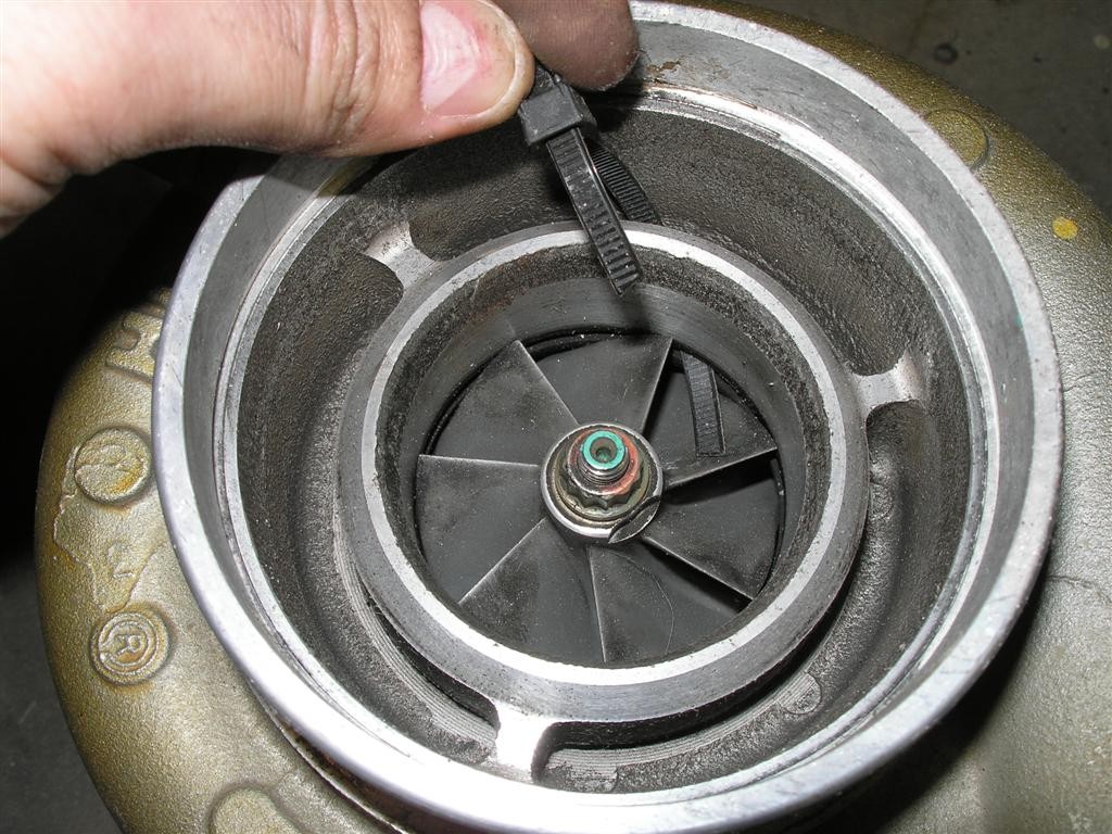

I'm not 100% sure if I can see it or not, but it looks as if you don't have the anti-surge groove cut out. That is why it is quiet! The groove looks like this (although this is an HY):
vt10vt wrote:Is it an HX35 or H1C? I don't think all (any?) H1C's came with an anti-surge housing.
Not all H1Cs came with anti-surge housings, but some certainly did. I had one! My friend had one with the casting for the anti-surge, but it didn't have the groove which leads to the compressor wheel. We cut out the groove very carefully with a dremel and it whistles louder now :D :drive:

I def don't have the groove on mine. I like the sound of dremeling it in tho... I'll go looking for a DIY
Haha, man you aren't likely to find a diy on that. You're better off asking goldfarb if they have an anti surge housing you can buy. It's not worth the effort to have to figure out where the groove should go, get it straight, and go through a ton of dremel blades (mine even needed new brushed half way through!) by the time you're done!

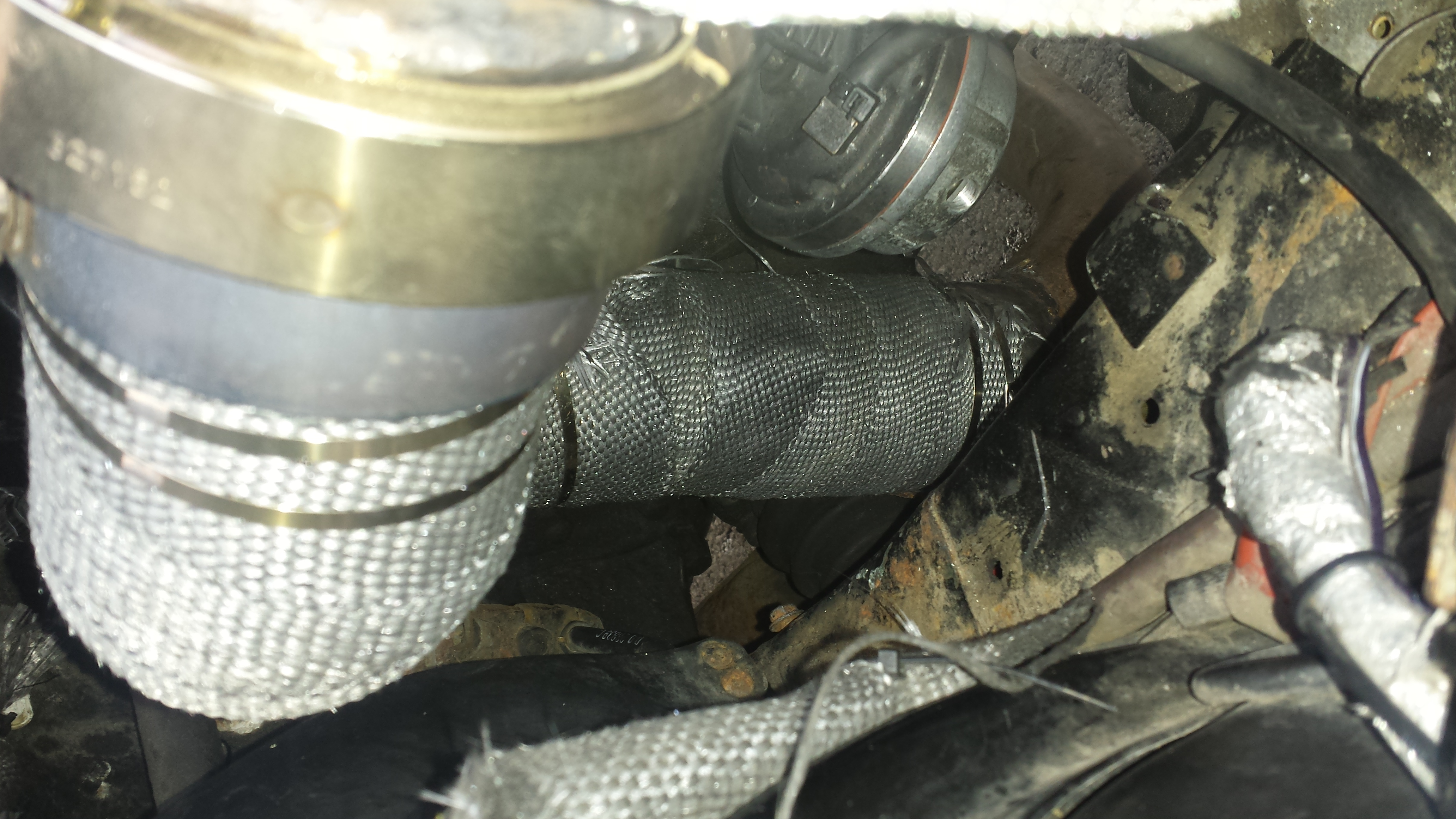

I wrapped the DP in 4 sections with overlap since I did it while on the car. I'm told I'm a quack for even trying lol.
It's fully dressed now above the y-pipe. I was concerned that the WG might overheat with all the heat soak going on. It's still hot as shit right where the v band is. Gonna wrap that part too, I guess, as much as possible.

Thanks. But I just got worried because I wrapped over my vband clamp. You think that will be alright long term?

Wrap came out great. Didn't understand your race story but sounds like it performed well? :drunk: :drunk:
I think it's unnatural if you do not use launch with this. It would be very disappointing. Even more so if there was no media to confirm it.
I don't really see why wrapping the clamp would be a problem.

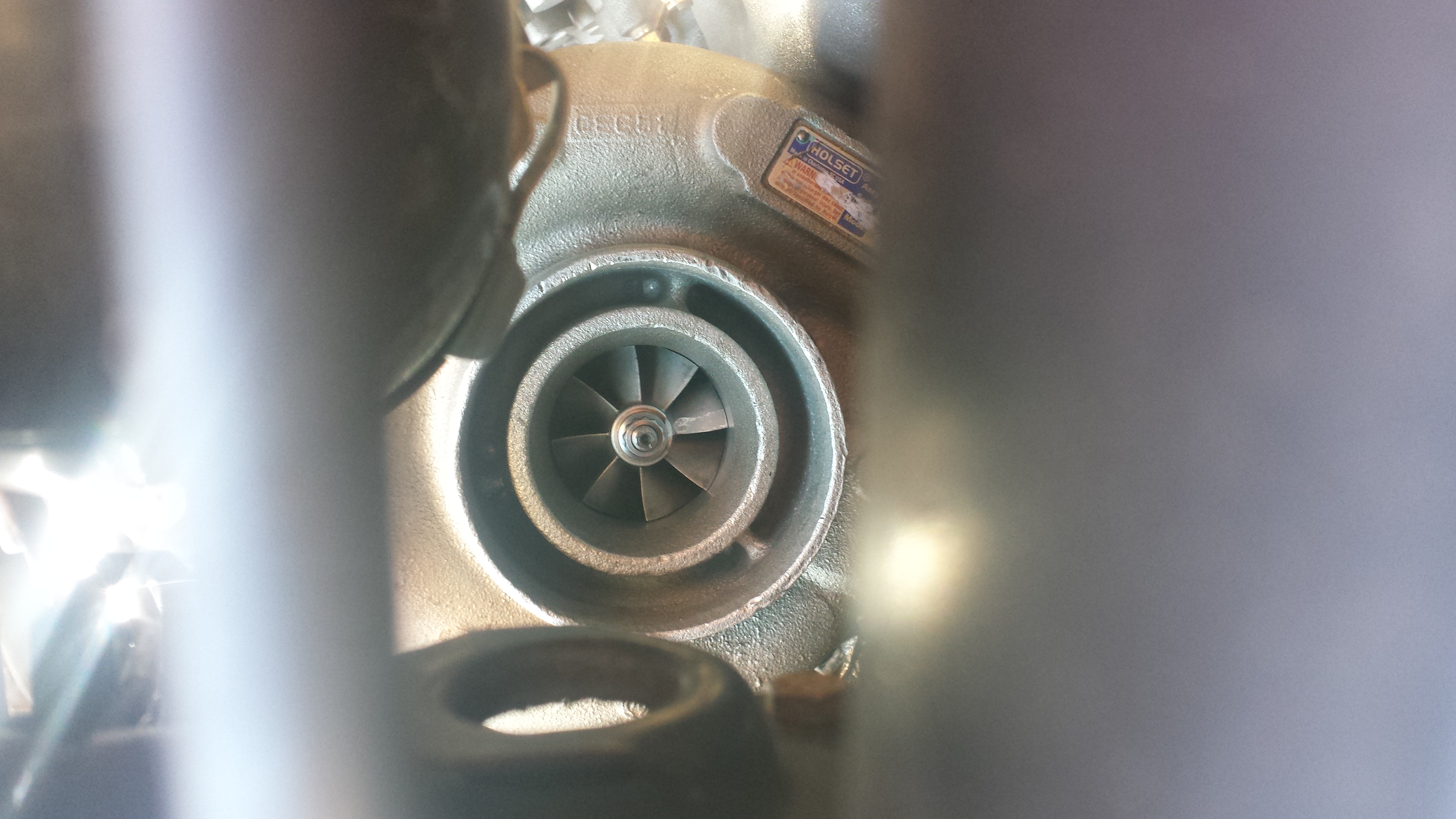

We've hit a brick wall that presented itself concerning Goldfarb. They don't know the inducer size of my 8 blade hx35. Its frustrating as I don't think I could even measure it accurately while its on. I sent them this info from the turbo's ID tag:
3537132
03068978
3537132-03-11/5
HX35
8 blade\ compressor wheel.
That coupled with looking at the close up pics of the inducer leads Brant over there to believe I have a 54 mm inducer. He doesn't have them at that warehouse so he has to check the others over the weekend. :( :( :(
He mentioned selling me a 52 mm and having a lathe bore it to 54 for me since it has a slip-on outlet like my current housing does. Does that sound insane?
