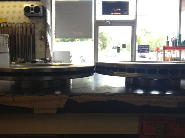

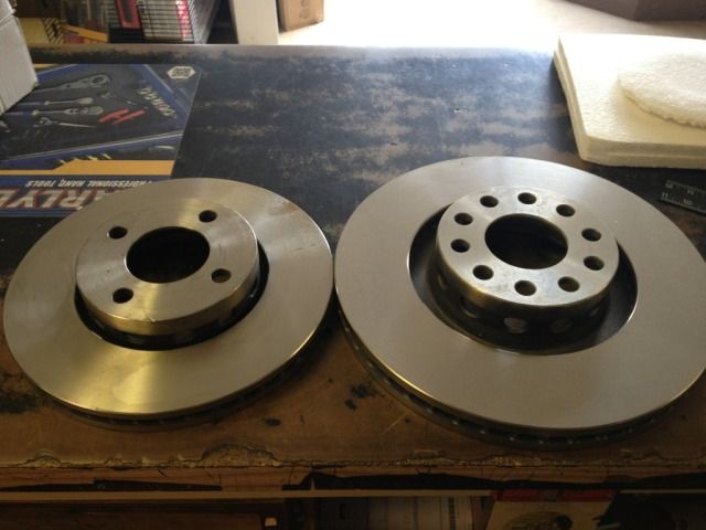

So. Got the 10 hole rotors that Jim mentioned a few pages back.

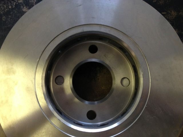

Hat height is a bit deeper as expected. And looks like ill be able to line up two of the predrilled 10 holes in the rotor hat, drill two more, and be mint as far as mounting them to the hub goes. This winters project for sure.

ya, it should work well. im going to dive into it this winter. two of the 10 predrilled holes seem to line up pretty well, maybe a bit of die grinding to get the holes a tad larger and then like i said two fresh drilled holes and theyll be good.

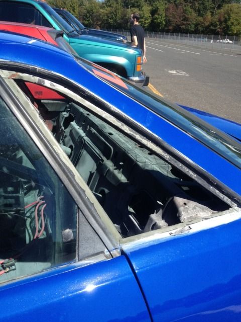

what happened to the driver rear glass
Re: 600+whp 4cyl20v90Q on 32psi....10.7@136 on street tires
the drivers rear glass? oh that ended up somewhere in the field next to the return road at the track on the 10.8 pass. friends in the stands said it was quite the site.
