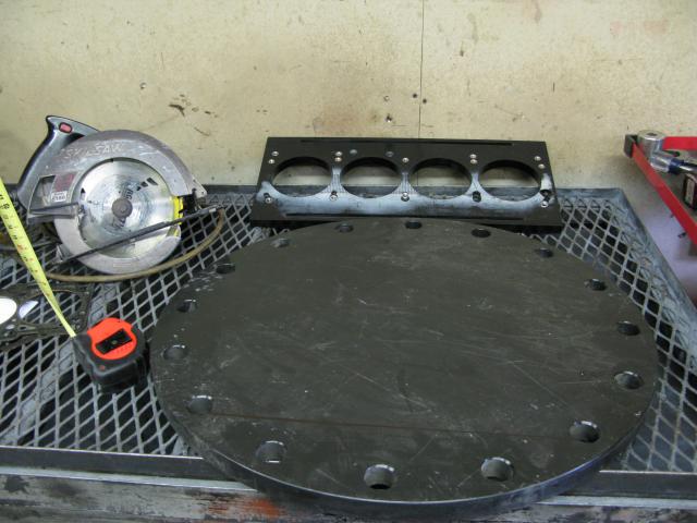

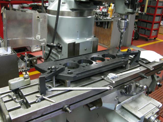

update, almost done with the flow bench test plate.
Started with a big ass chunk of scrap plastic, the idea was to get two useable flowbench plates out of this so I wound up being pretty tight on space
Just gotta add some threaded inserts for the head bolts into the plate and then machine up the sleeve that goes in the bench and I'll be good to get some baseline numbers :woowoo:

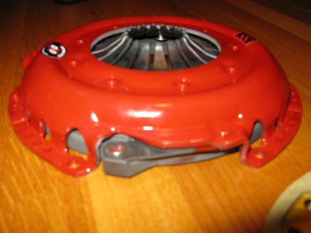

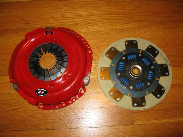

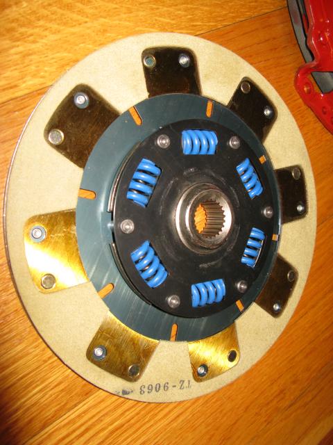

Also got my new clutch, southbend with the same pressure plate that Janis is using on his coupe but with a different clutch disc. Never seen anything quite like it, apparently a kevlar compound, rated for 750 ft/lbs torque

Ah the big red pressure plate... I have one of those in my car, quite happy with it so far, hope it works out for you Marc. My Stage 4 South Bend clutch requires much more pedal effort but with that comes higher torque capacity. I have no problems easing my clutch out to roll my sedan under idle power from my garage into my driveway.
I believe one of my co-workers has iirc a TZ South Bend setup on his 04 GLI 1.8T. This weekend he is installing a new friction disc, after 60,000 miles of what I'd consider to be aggressive driving on a lightly tuned car (K03 + Revo, turbo back, upgraded SMIC etc). I've driven his GLI and I didn't notice any slippage but he says it is there... it may not even be his disc but rather a slightly leaky 0A5/02M slave cylinder / TO bearing. I didn't find his clutch to be unusually grabby or obnoxious, even when driven calmly.
I was once told that a kevlar disc will last about five times as long as an organic disc under identical circumstances. I have also been told that the kevlar disc is much less abrasive towards the metal friction surfaces on the pressure plate and flywheel.
