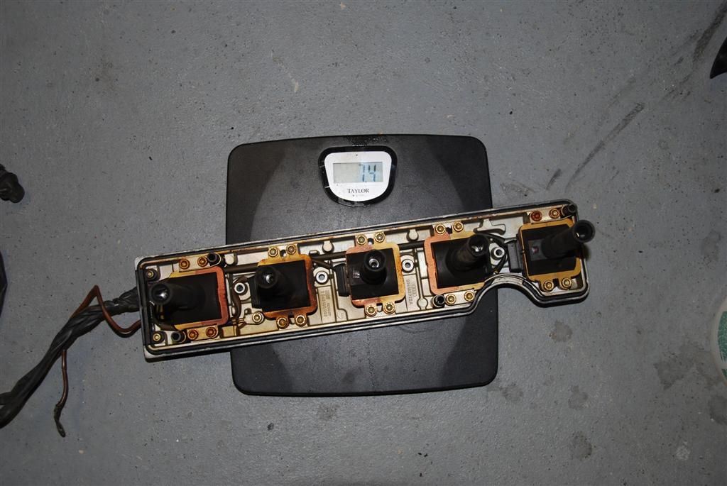

Not to mention the weight savings if comparing to an AAN setup...
Yikes...But, there are so many places to cut 5 or 10 lbs. here and there with updating to later technology gear. The ignition system, the starter, the AC components, removing the bomb and associated hydraulics...All while keeping the heart of the engine intact...
