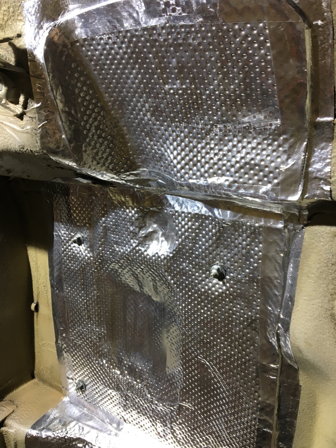

I decided to not put the rear heat shield back on, put heat shield directly on the chassis instead.
