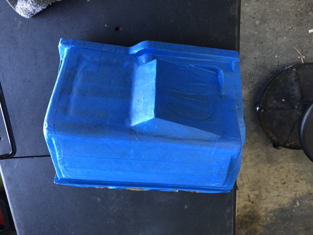

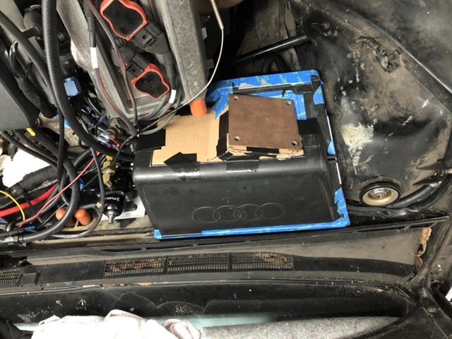

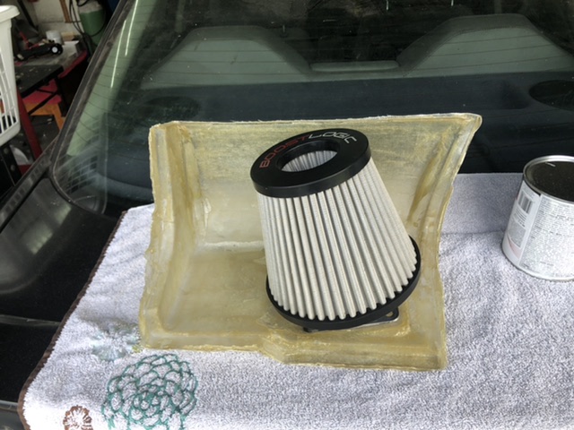

My new air filter box mold. Making it out of high quality fiberglass. But I think everyone cuts them out. If your interested in one let me know

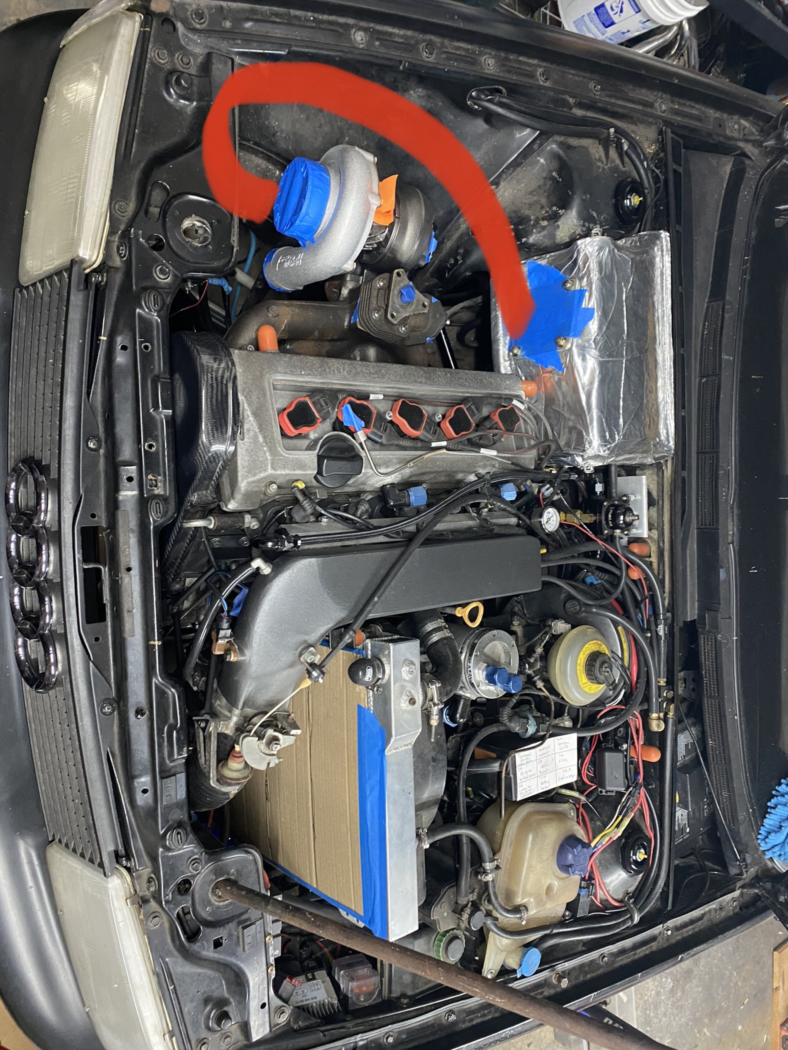

Oh boy, that's a nice tactic. Adapting the Sport quattro concept has been on my mind a long while.
Is there ducting into the scuttle panel / rain tray?
Velocity stack?
Re: Andy's 91' 80q
Posted: Mon Jul 19, 2021 8:42 pm
by rennenmsports

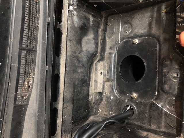

Thanks bud! I made a plate with a 3 inch tube to cover the hole in the bottom of the battery tray. Then since I’m not running ac I attached a 3 inch silicone hose pushed through the firewall to draw air from inside the cabin. Found spectre 4 inch duct flanges. One on the inside for a 4 inch turbo gaurd air filter. There is a few slots going into the rain tray from factory making up for the 1 inch difference. There is room for a velocity stack as well.

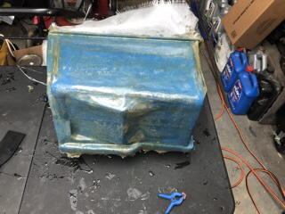

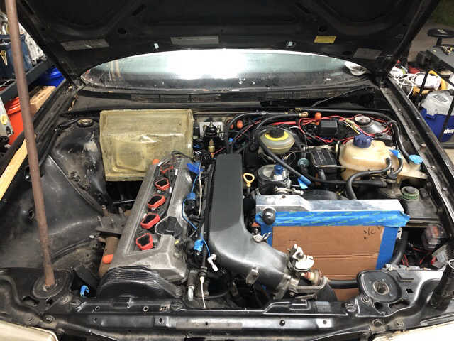

The mold is coming along nicely. I’m still debating on what to make the real one out of. A lot of heat will be generated under it.
Re: Andy's 91' 80q
Posted: Sun Aug 22, 2021 8:14 pm
http://www.extremeheatprotection.com/hi ... satin.html
Something like this looks alright... I'd guess basically any fibreglass rated for high heat will do the job nicely. If you were so inclined you could use gold foil to reflect heat away from the airbox, and/or a thin OEM-like aluminum shield as well.

That looks good! I’ll look into it further. I have a bunch of different things on the car pending. I’m running aluminum fuel line from the front midway up the firewall to under the back seat right now. Almost done. But need about 5 ptfe lined flexible hoses to finish the fuel system to hopefully be able to idle it on its own now. I’m getting there. Got everything mounted. Just need to plumb everything up

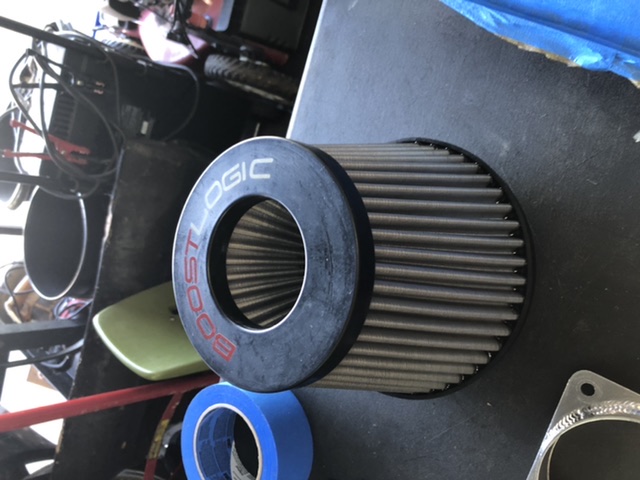

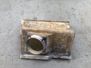

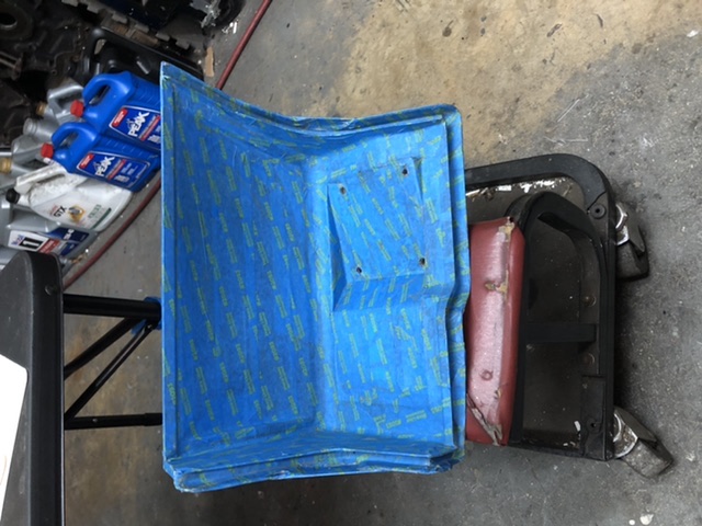

Finally got the plug made. I’m about to make the piece that actually goes onto the car. It’s going to have a boost logic universal 4” air filter

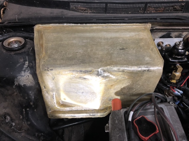

It fits :) you can see the flange on the filter inside the first layer of glass

Now that I know everything will work out. It’s on to the next one made out of something I found that can handle up to 1100 degrees F and make it thicker.
I failed miserably using this. Gonna try something different

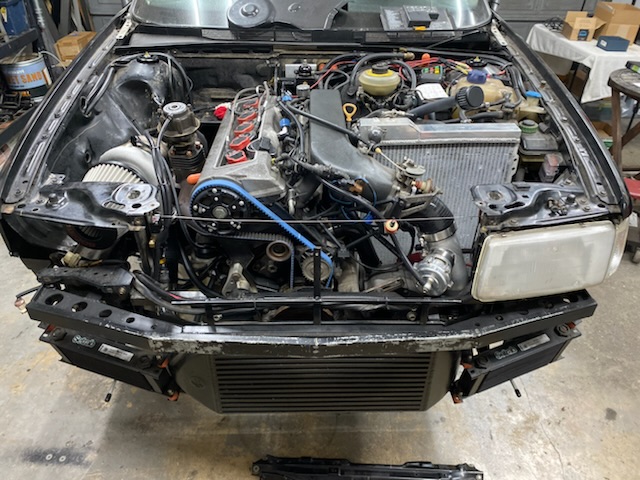

Well. She finally runs on her own after 17 years :) I tried to post the video but it didn’t work. It would probably be sideways or upside down anyway :lol: What a sigh of relief!

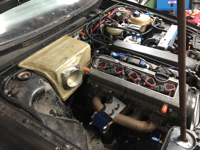

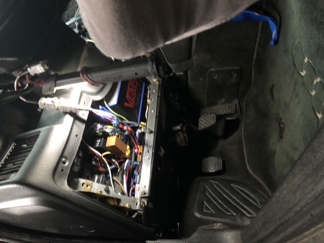

Hahaha. It fit. No dash removal

What’s the part number for that timing belt?
Re: Andy's 91' 80q
Posted: Sun Jan 22, 2023 1:43 am
by rennenmsports
T137RB. But it’s for the AAN. Different tensioner setup then the 3B
Re: Andy's 91' 80q
Posted: Thu Jan 26, 2023 11:01 pm
by JH87
rennenmsports wrote:T137RB. But it’s for the AAN. Different tensioner setup then the 3B
Gotcha… uses the spring tensioner instead of the water pump?
Re: Andy's 91' 80q
Posted: Sun Jan 29, 2023 5:34 pm
by rennenmsports
Yes. But no spring in mine

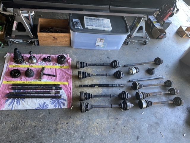

To get the front urs hubs and bmw wheel bearing to fit the outer cv joint into the 80q’s rear knuckles
