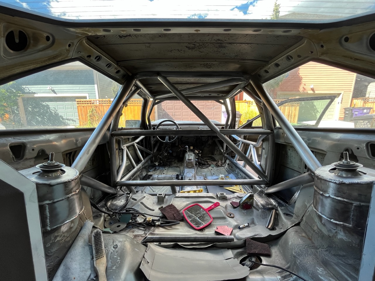

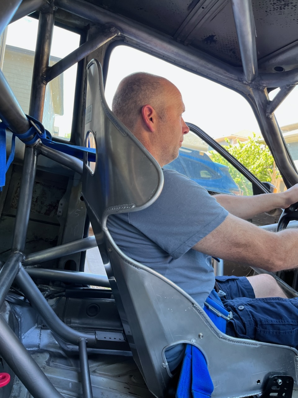

Re: '84 Audi Coupe Gt grp2

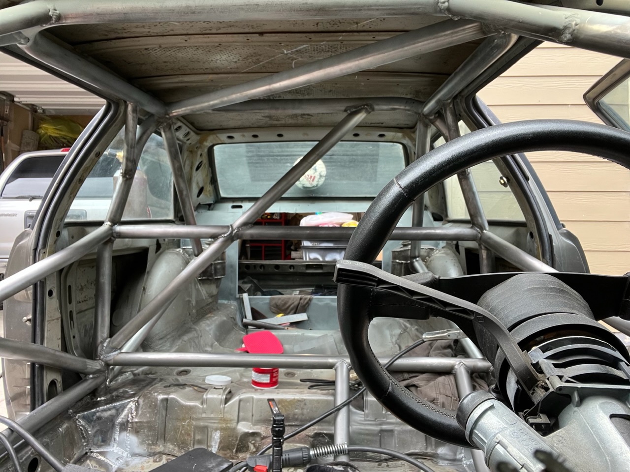

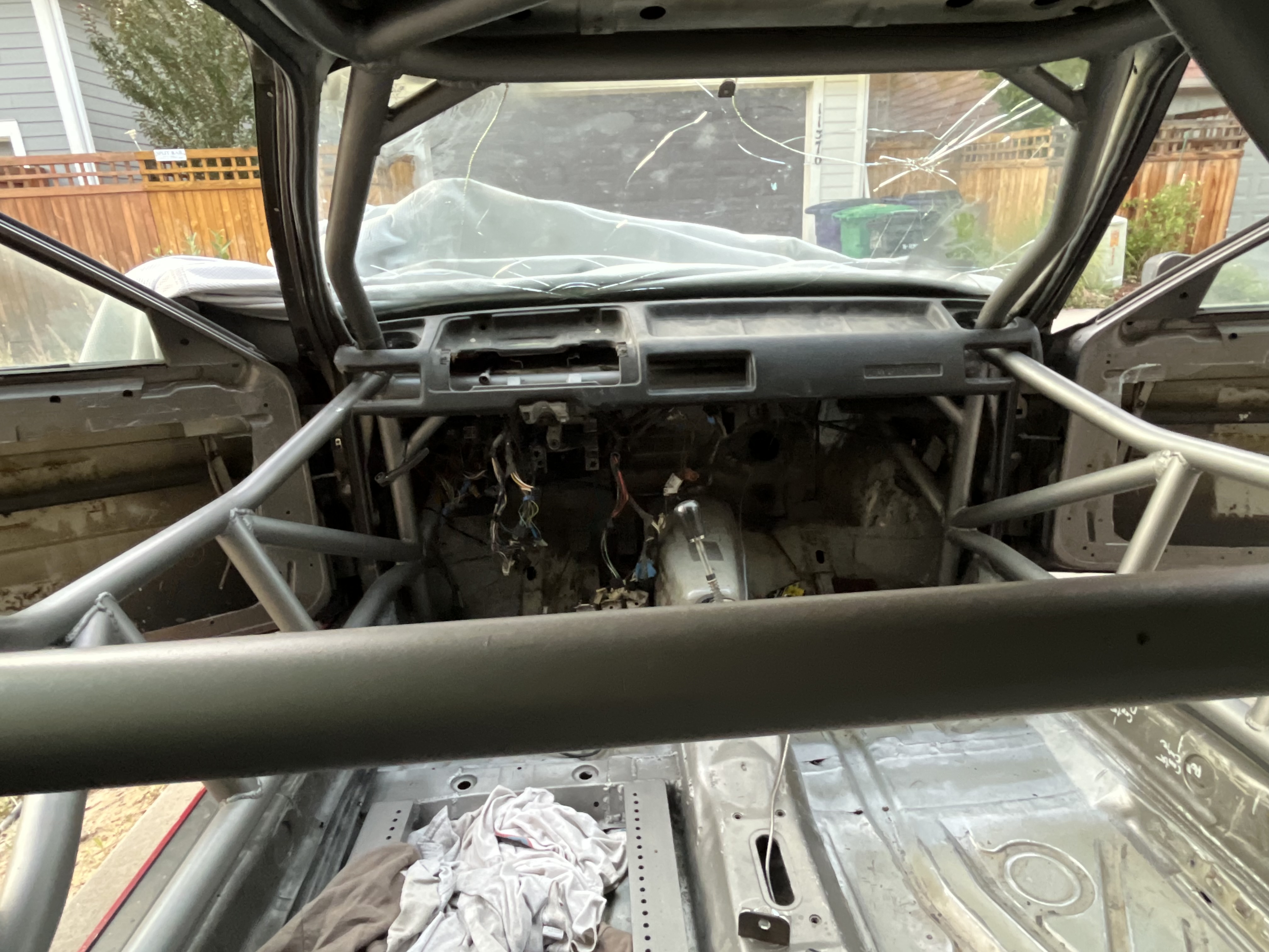

So bear in mind the car is not on level ground so I did my best. Test fitted the diagonal and horizontal/driver’s restraint tubes a couple of days ago and got them welded up today. Hopefully no spine compression will happen. I have a few more things to fine tune on the driver’s restraint system: the right lap and submarine belt attachment points. Thanks for looking.

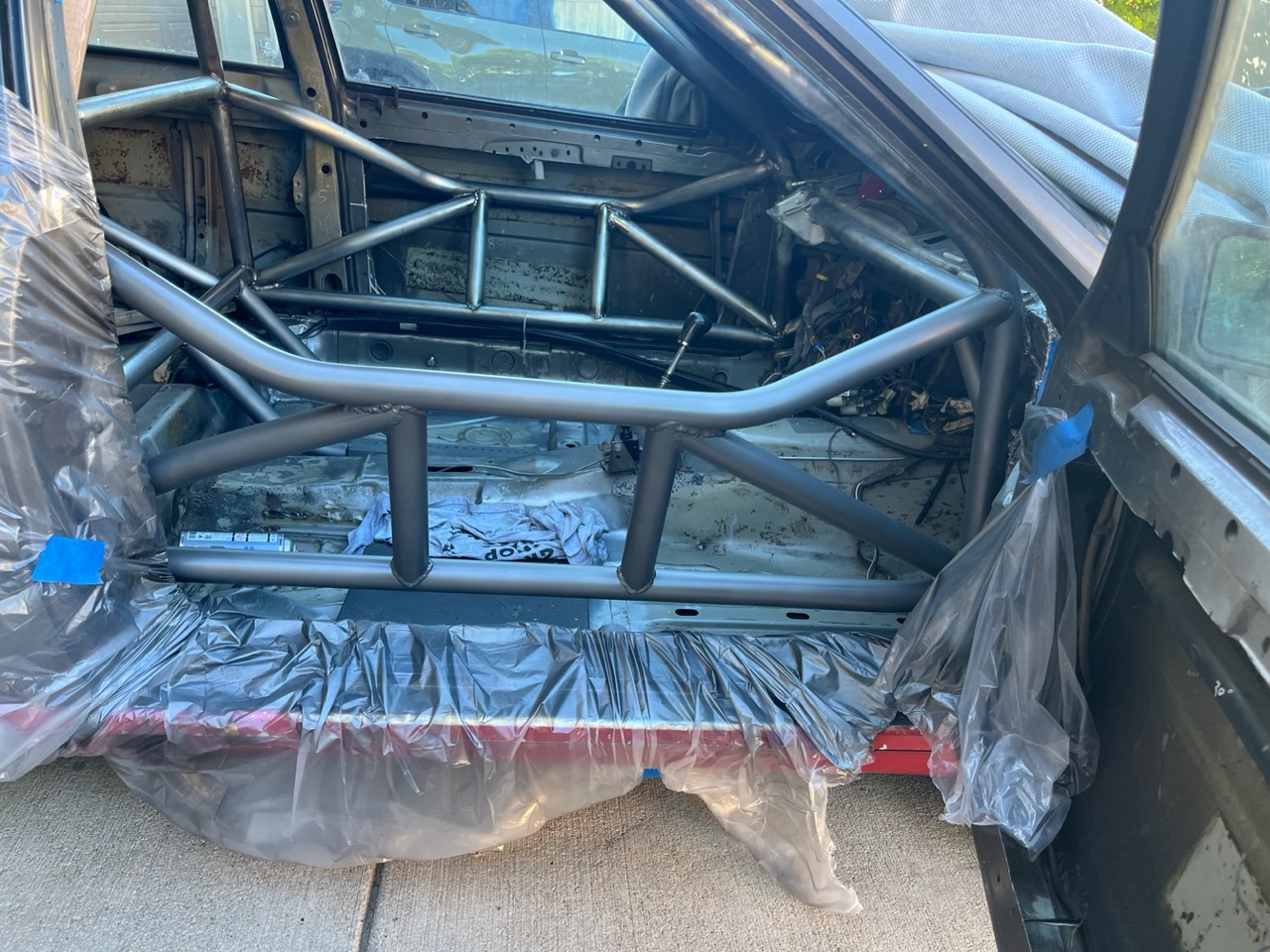

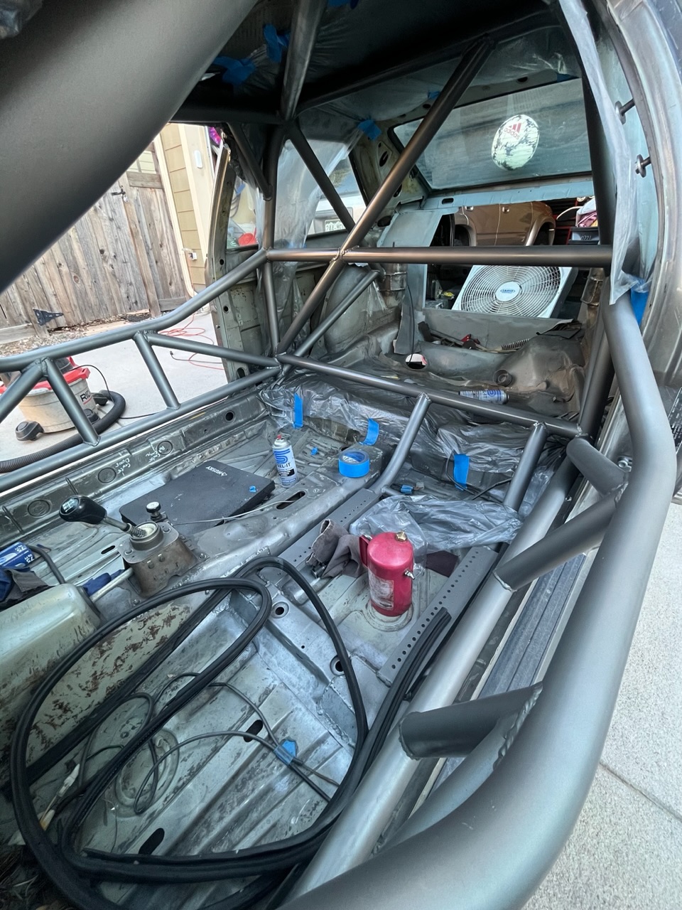

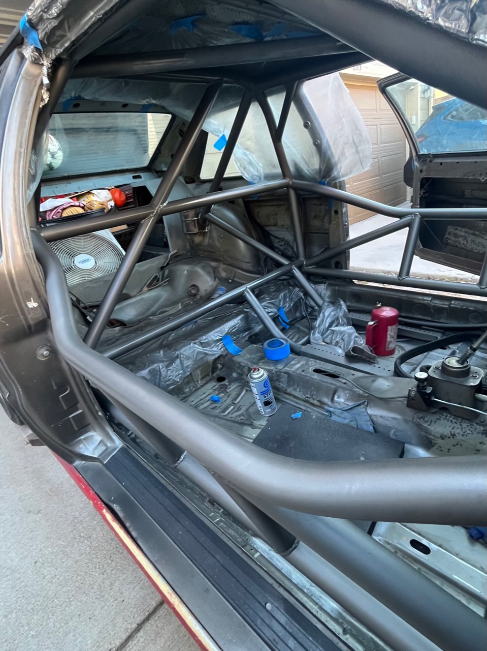

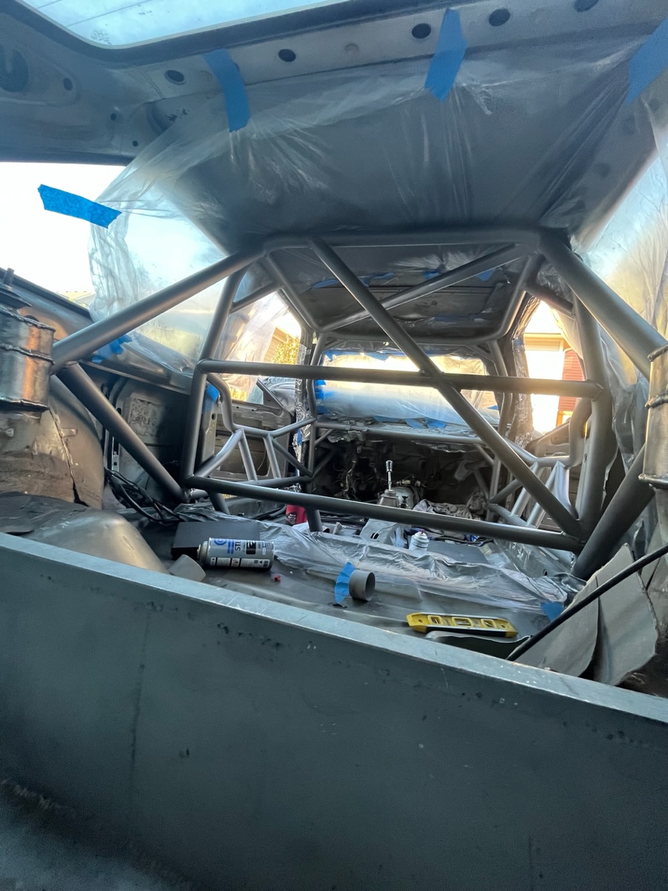

Cold weather is on its way so I’ve been trying to get some paint on the roll cage. Using “Steel-it” paint in a spray can. They say paint makes everything look better, not so much in my case. The paint goes on nice and looks good. It can also amplify imperfections. I used tinfoil and plastic drop cloth to get behind tight areas to help keep the over spray down. The plastic drop cloth works good as long as you don’t use it on anything overhead, the paint will weigh it down causing it to stick to what was just painted. When I paint the interior of the car I’ll wrap the roll cage with tinfoil to keep over spray down. Thanks for looking.

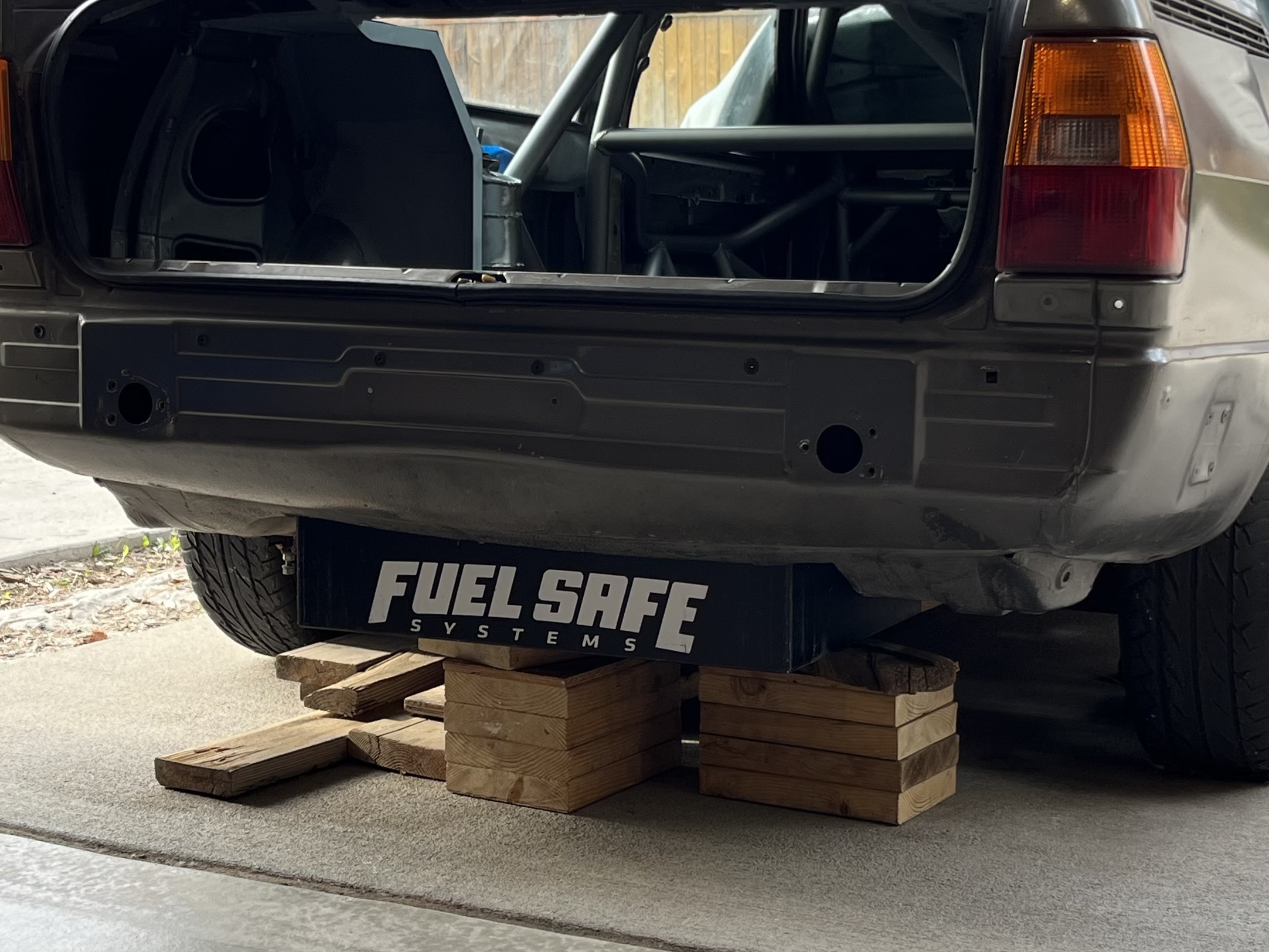

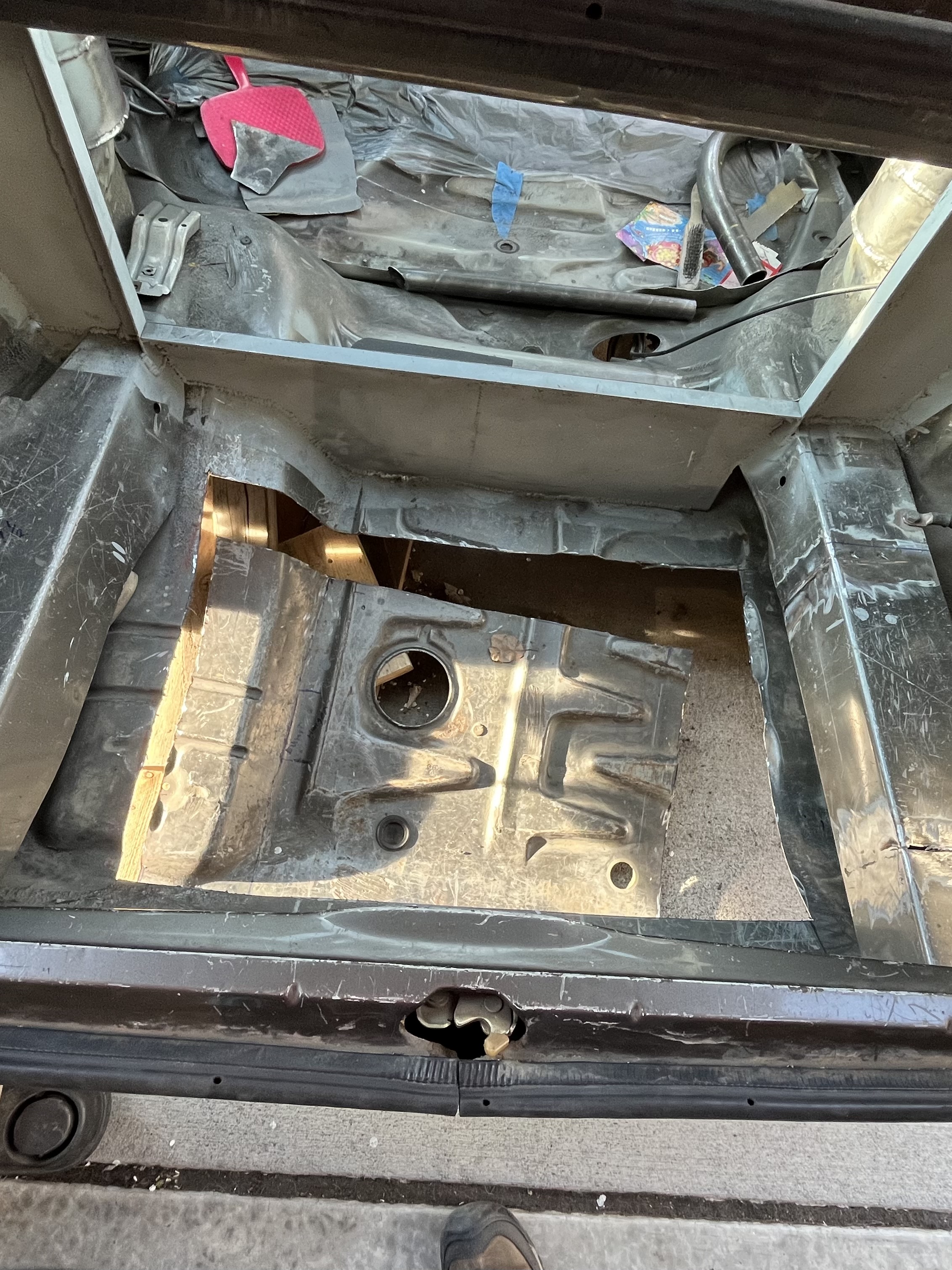

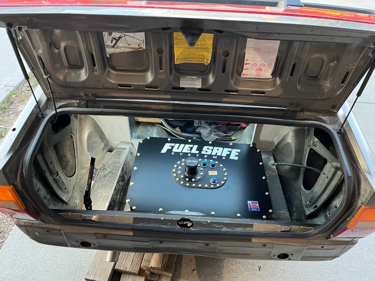

Purchased a 15 gallon fuel cell. Trying to mount it as low as possible. The GCR states “It is recommended that fuel cells not be installed any closer to the ground than six (6) inches, unless enclosed with the bodywork”. In order to achieve this I’ll have to cut out a section of the trunk floor, get a different exhaust, fabricate a structure to mount the fuel cell in and relocate the battery tray. Thanks for looking.

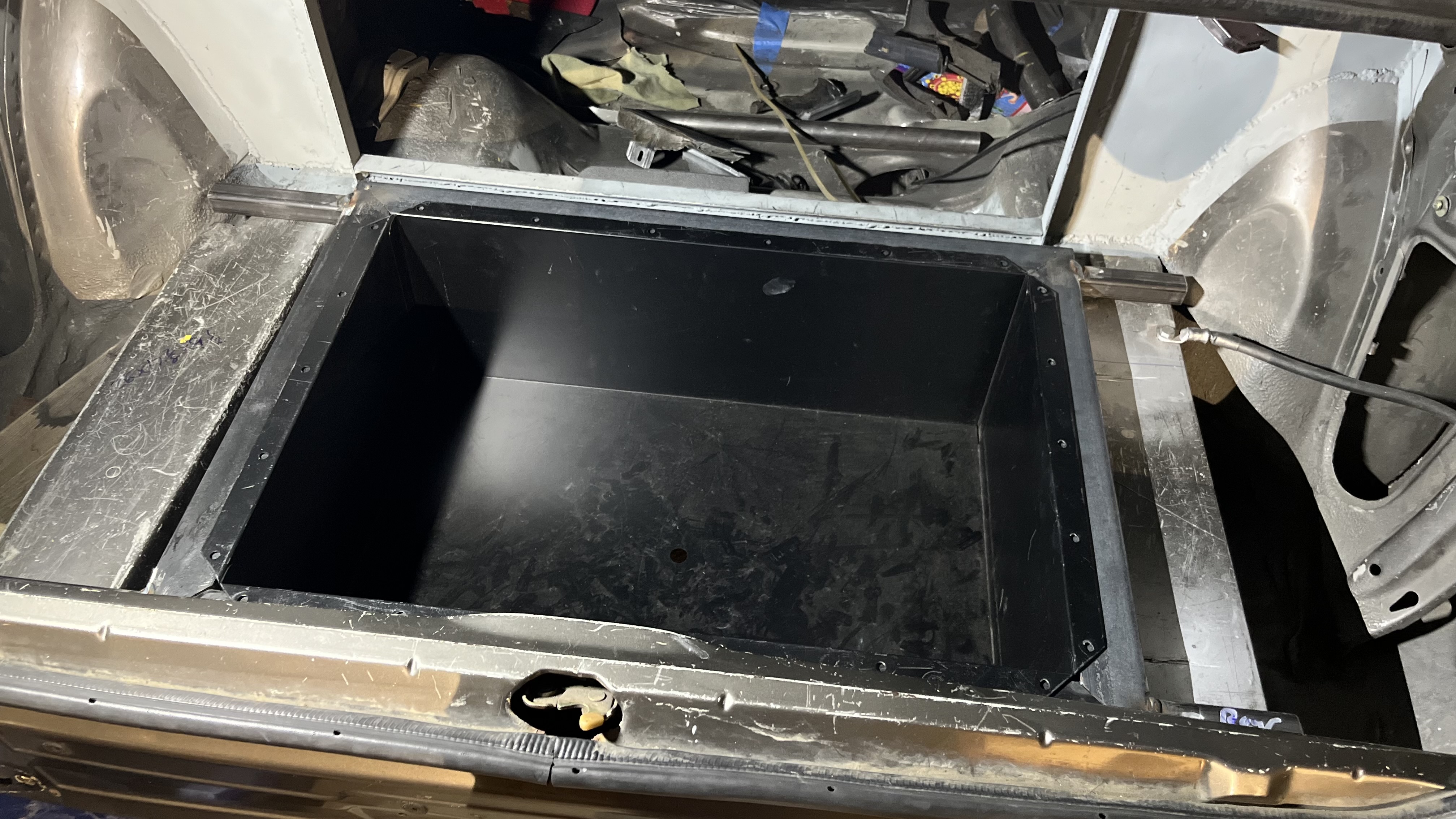

Got the hole cut in the trunk. We can go low or super cool race car fabricator guy low. I’ll stick with low, little more involved with the other route. Thanks for looking!

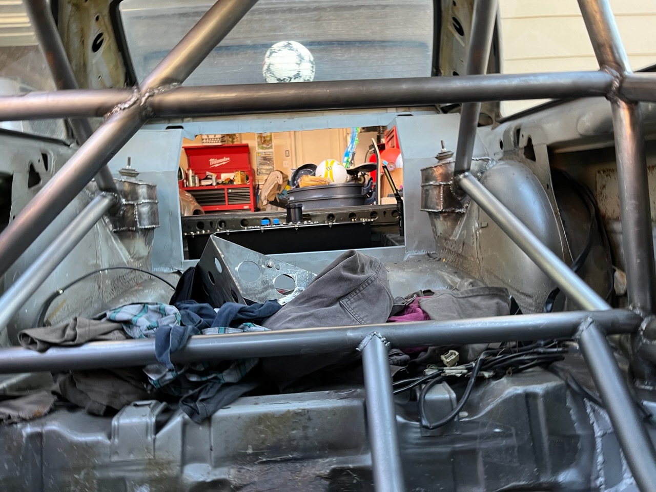

F it!! I give up! I keep getting “the image you tried to attach is invalid” I have to edit some of my pics 15 different ways so the site will except them and then I forget which way works. I’m done.

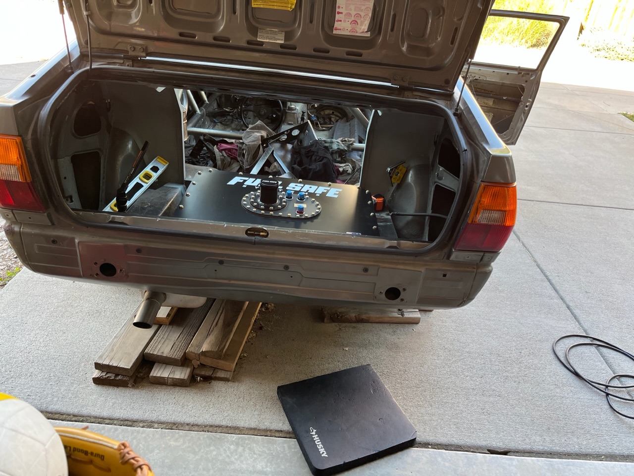

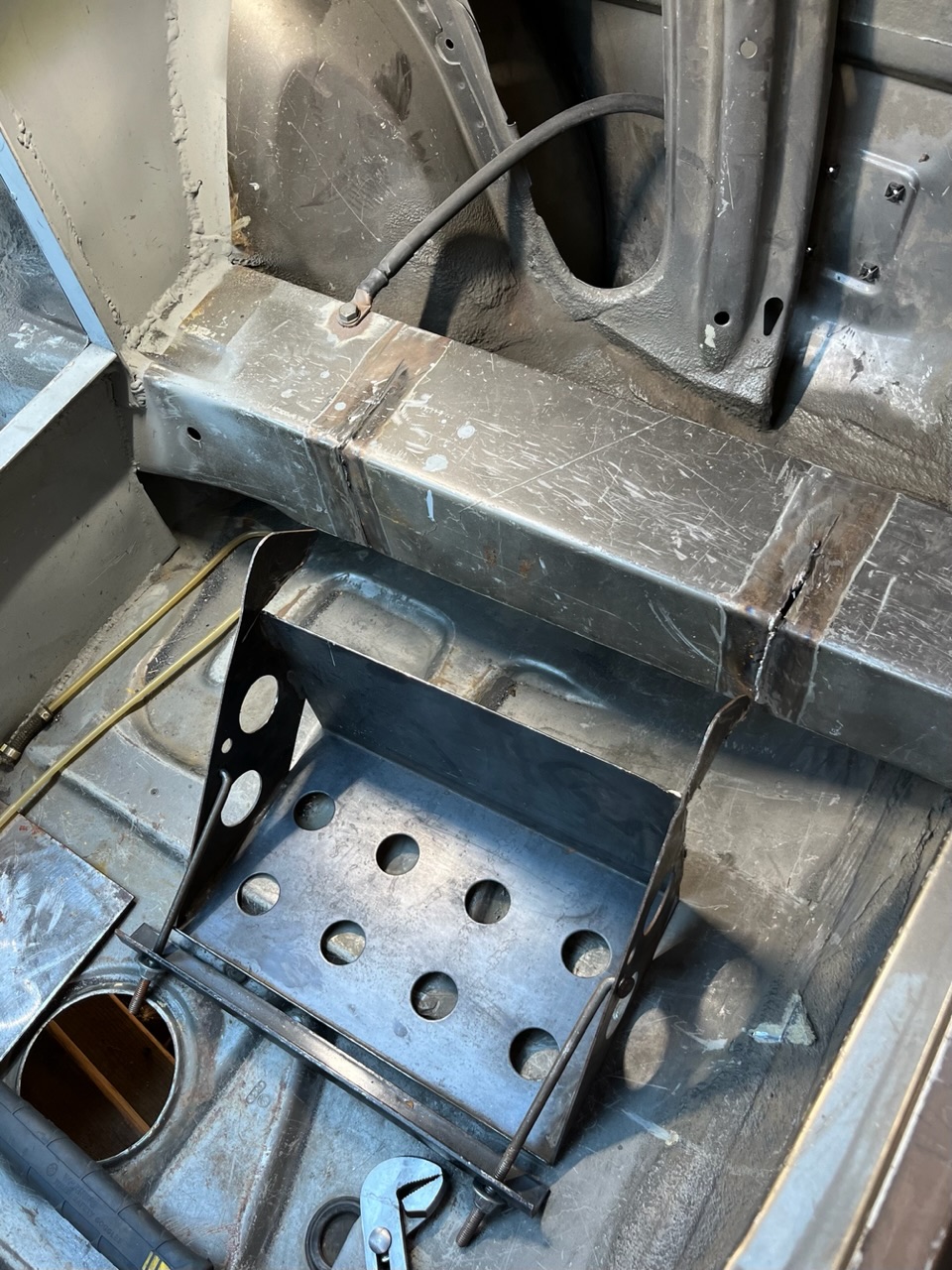

Fuel cell structure is kinda rough but we’re moving forward with it. I closed off all the holes, cut some plates for the structure to mount to the car. I’ll also make the top portion similar to the bottom so the fuel cell is encapsulated in the structure. I don’t think the safety guy likes to see the fuel cell housing flange/lid used to secure the cell in place. Still more to do on the structure, drill some clearance holes on the structure for all the bolts on the fuel cell so it sits flush, finish welding it, paint and then final install. Thanks for looking!

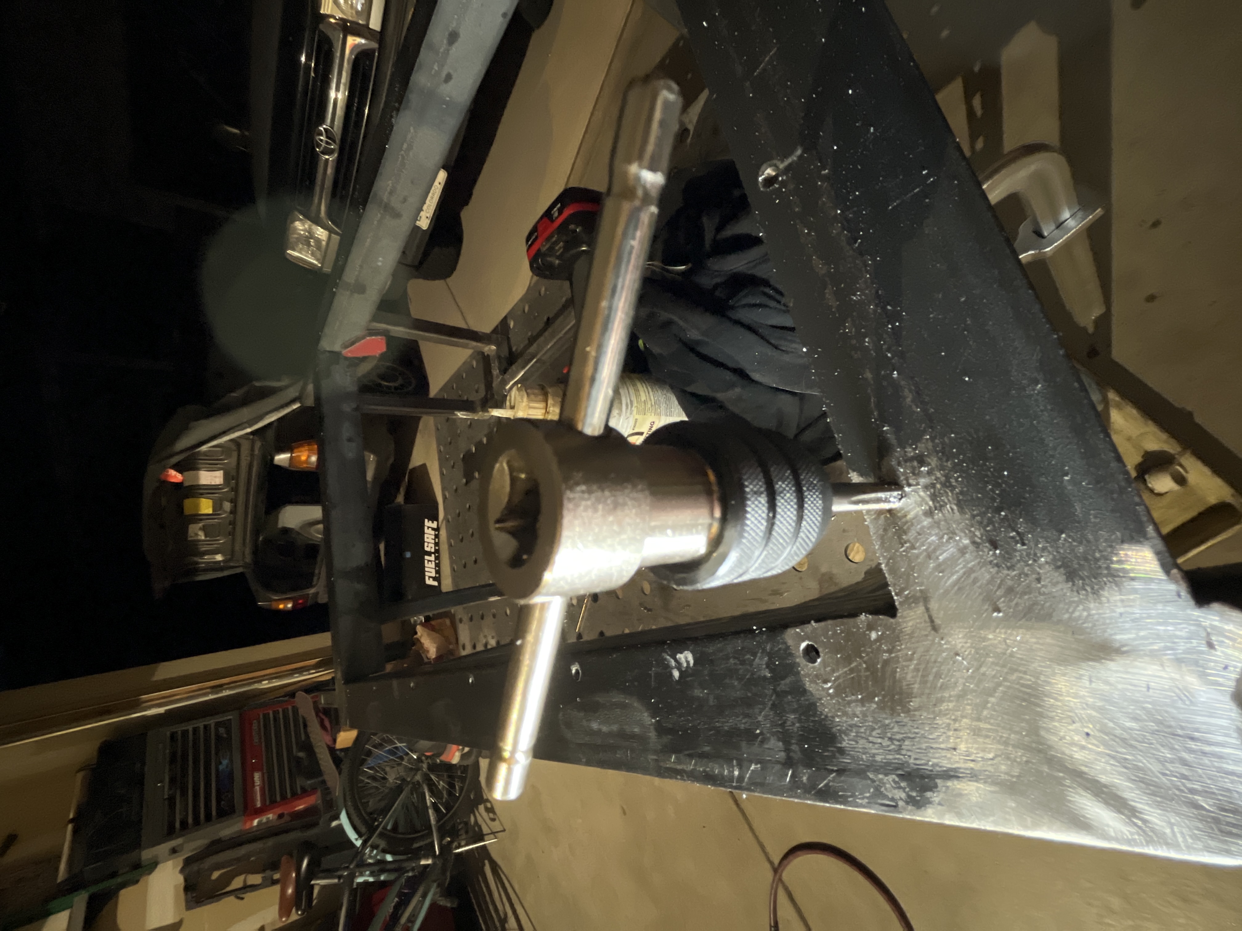

22 holes drilled and tapped for the fuel cell. Thanks for looking.

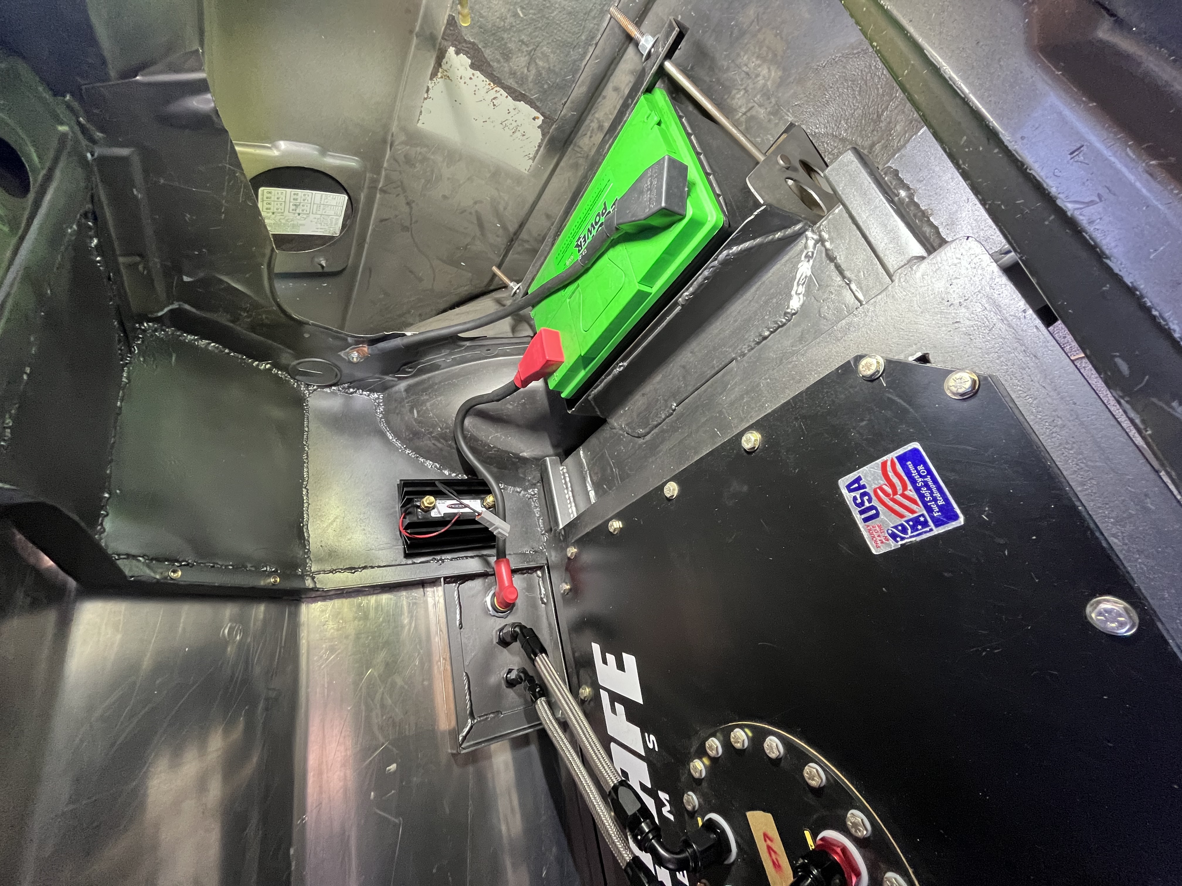

Battery connections are done, still need proper disconnect switches . Fuel delivery is sorted.

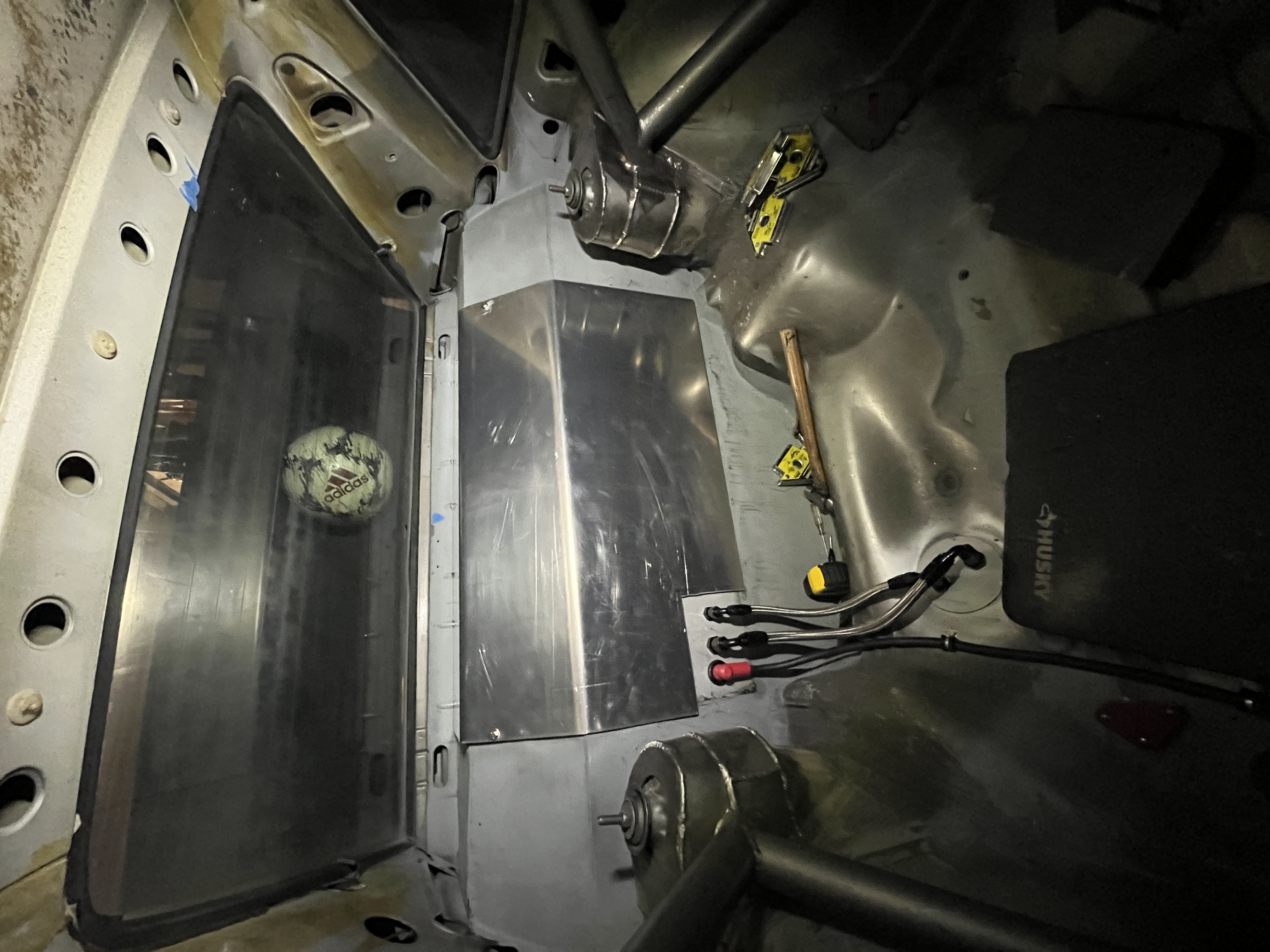

Solid state kill switch from Racewire Solutions and I got the bulkhead wall installed. I used 1/4” aluminum sheet, a little thick but it’s solid.

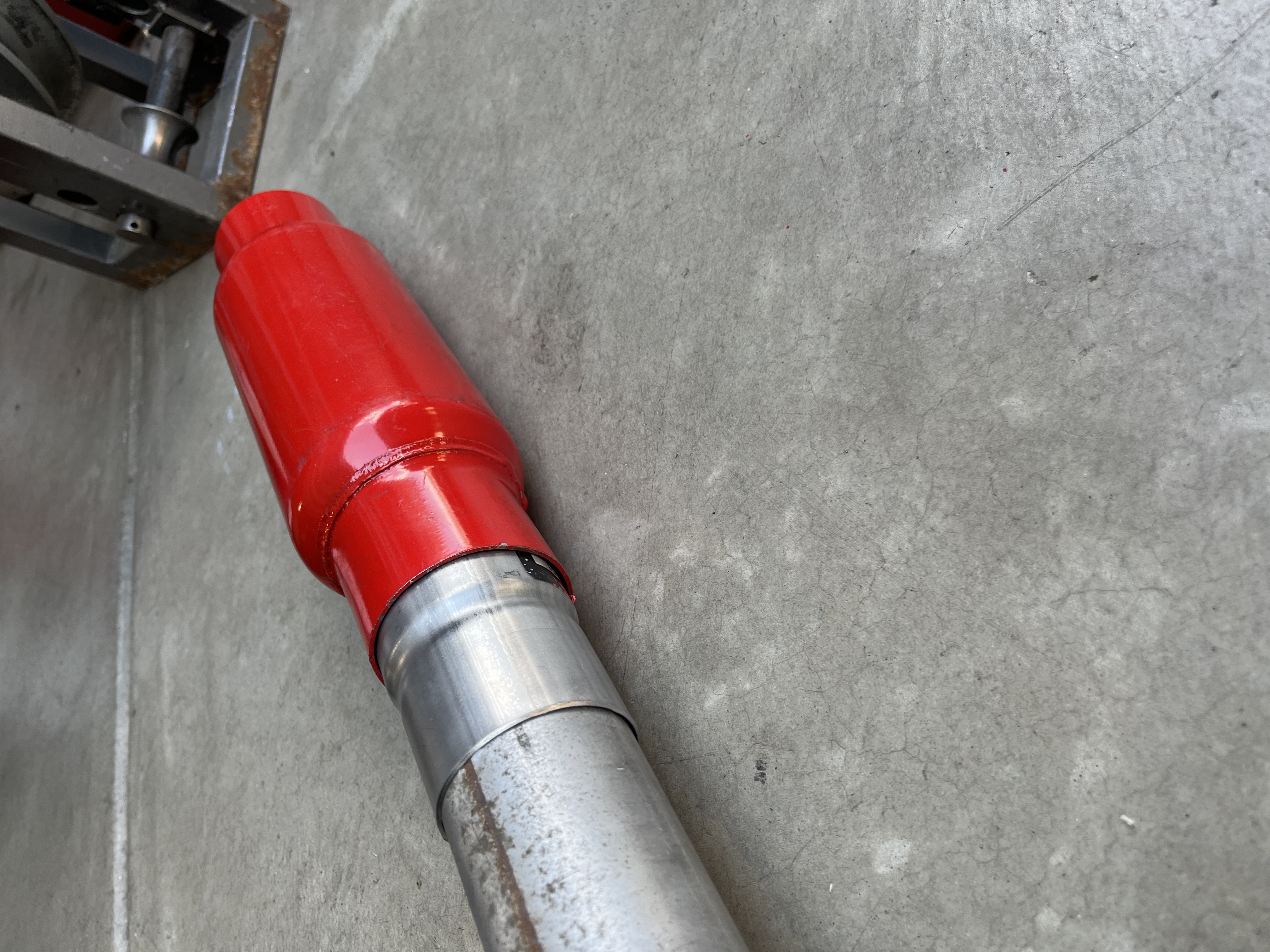

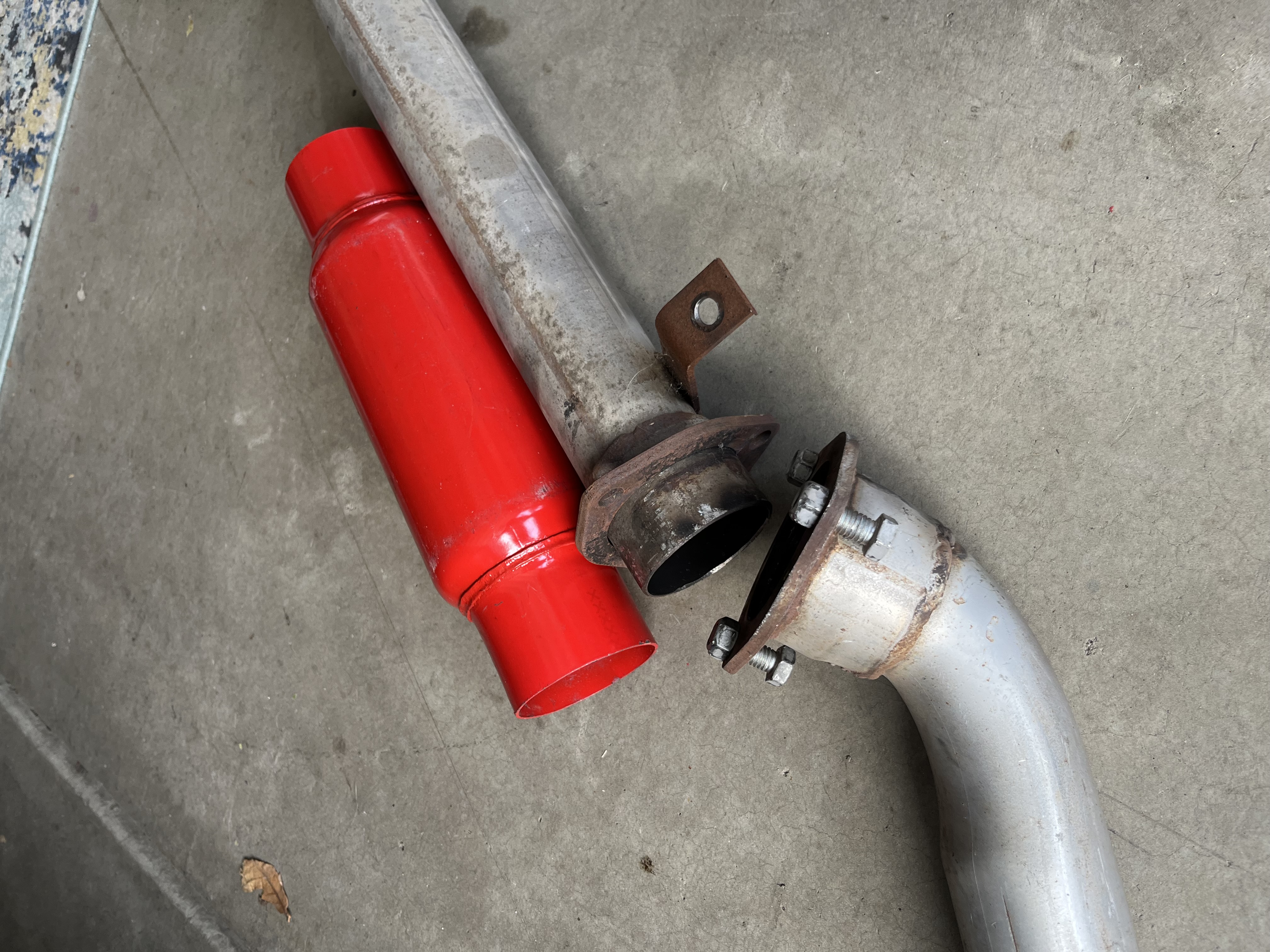

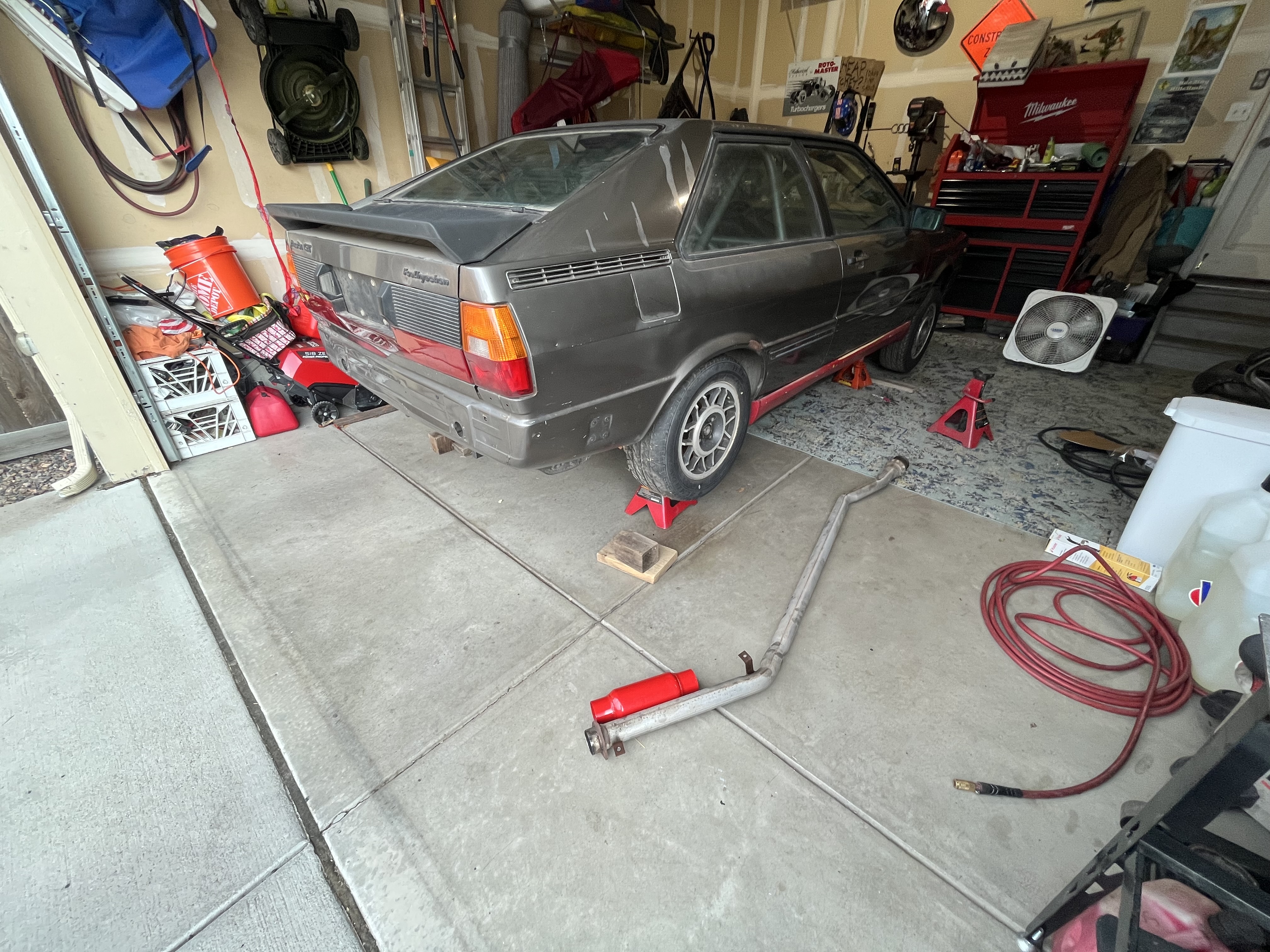

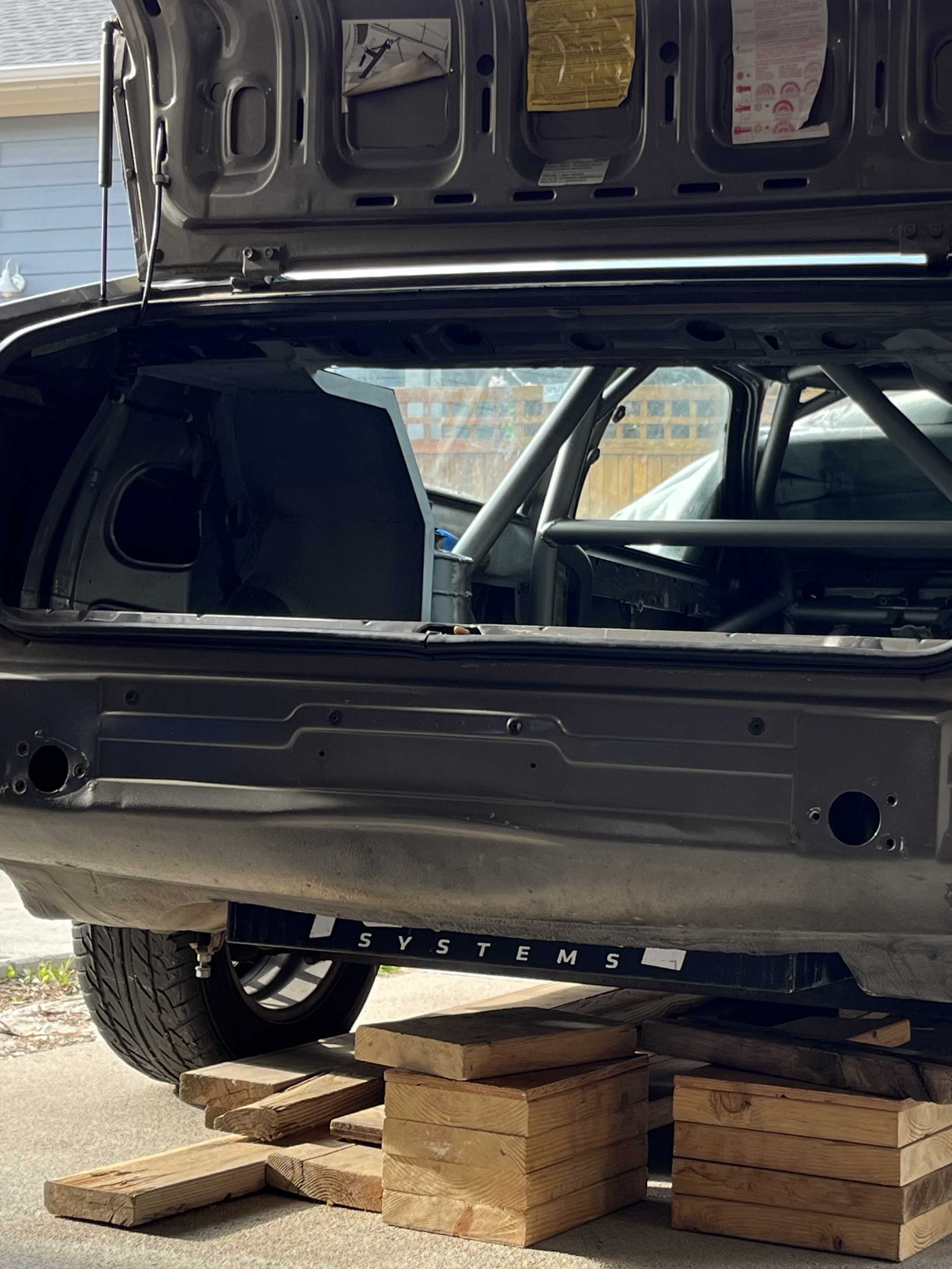

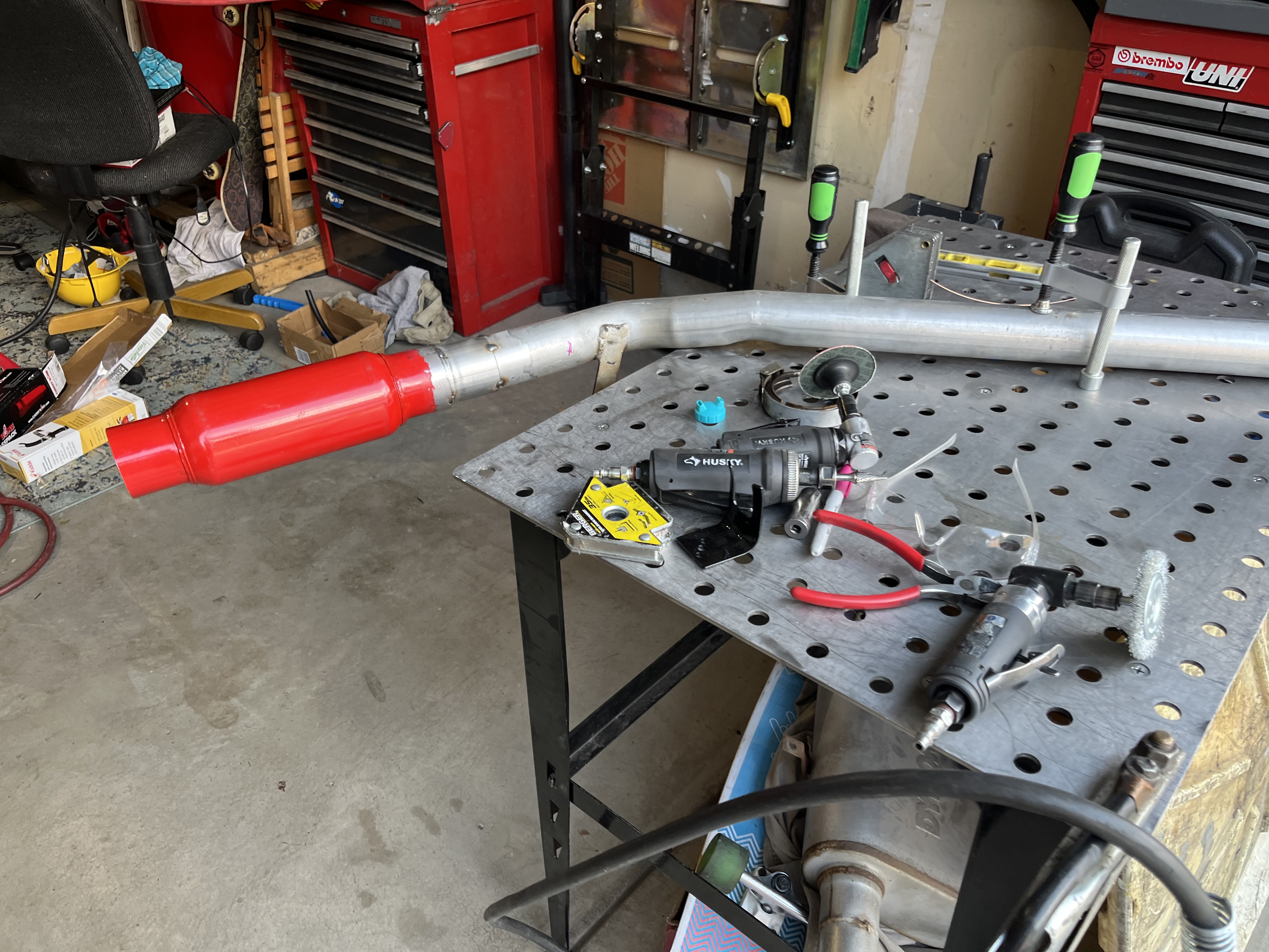

The exhaust set up. It’s just tack welded together. The cherry bomb is kind of loud so we might have to put something different in. We will see. Thanks for looking.

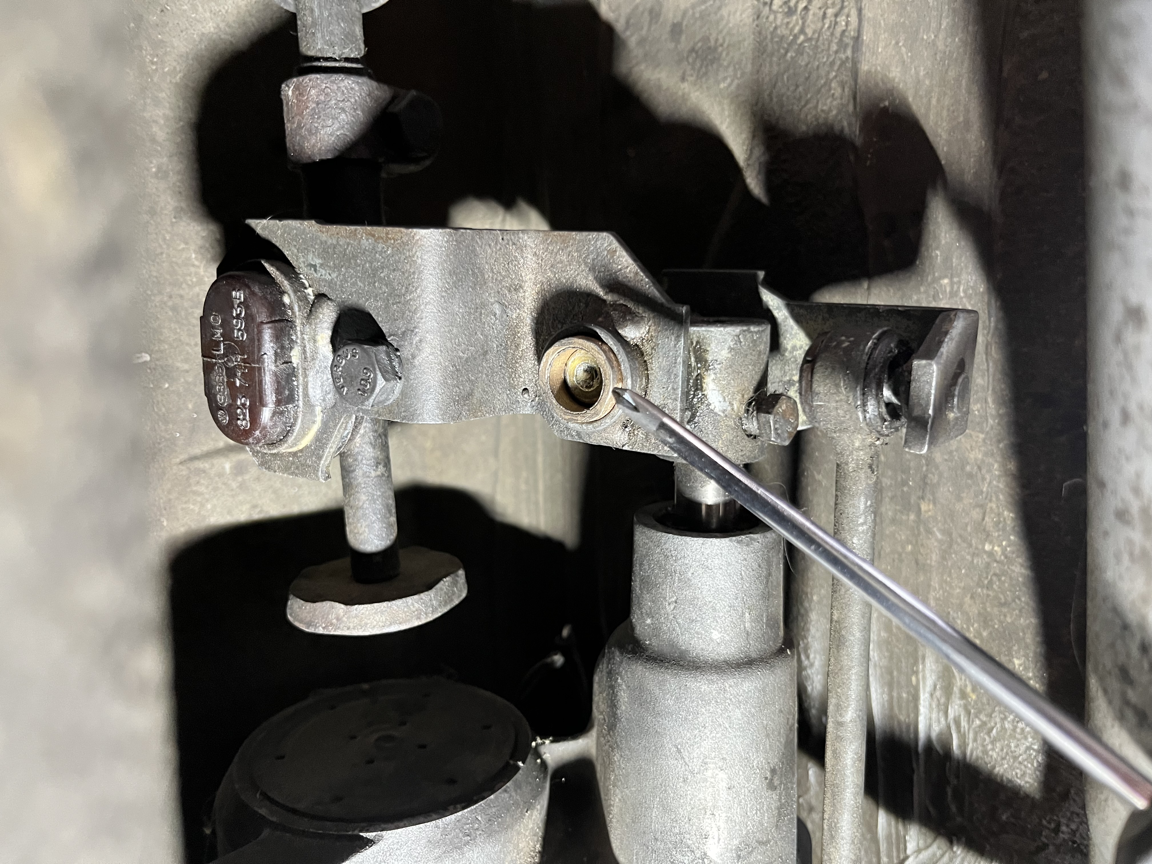

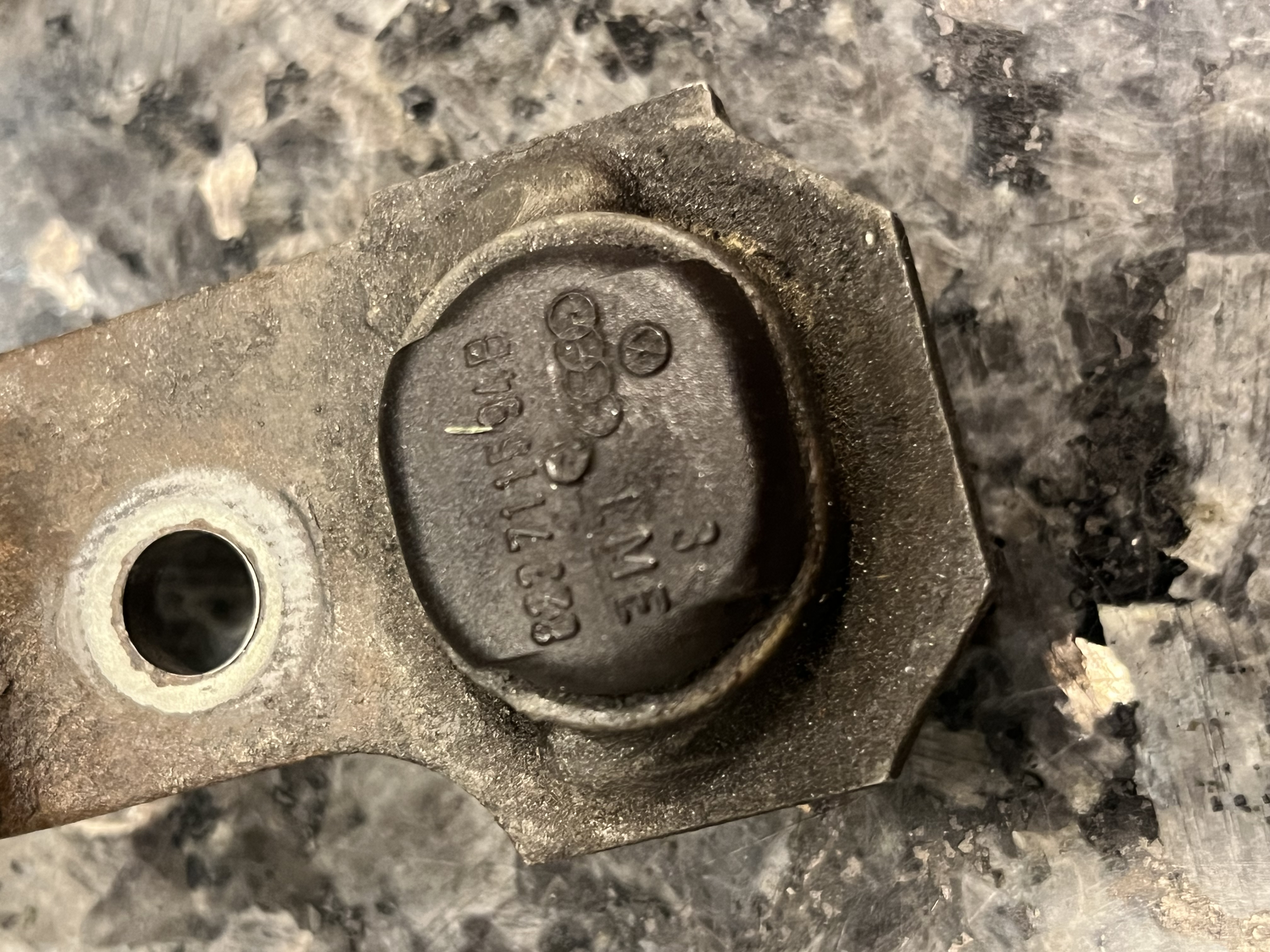

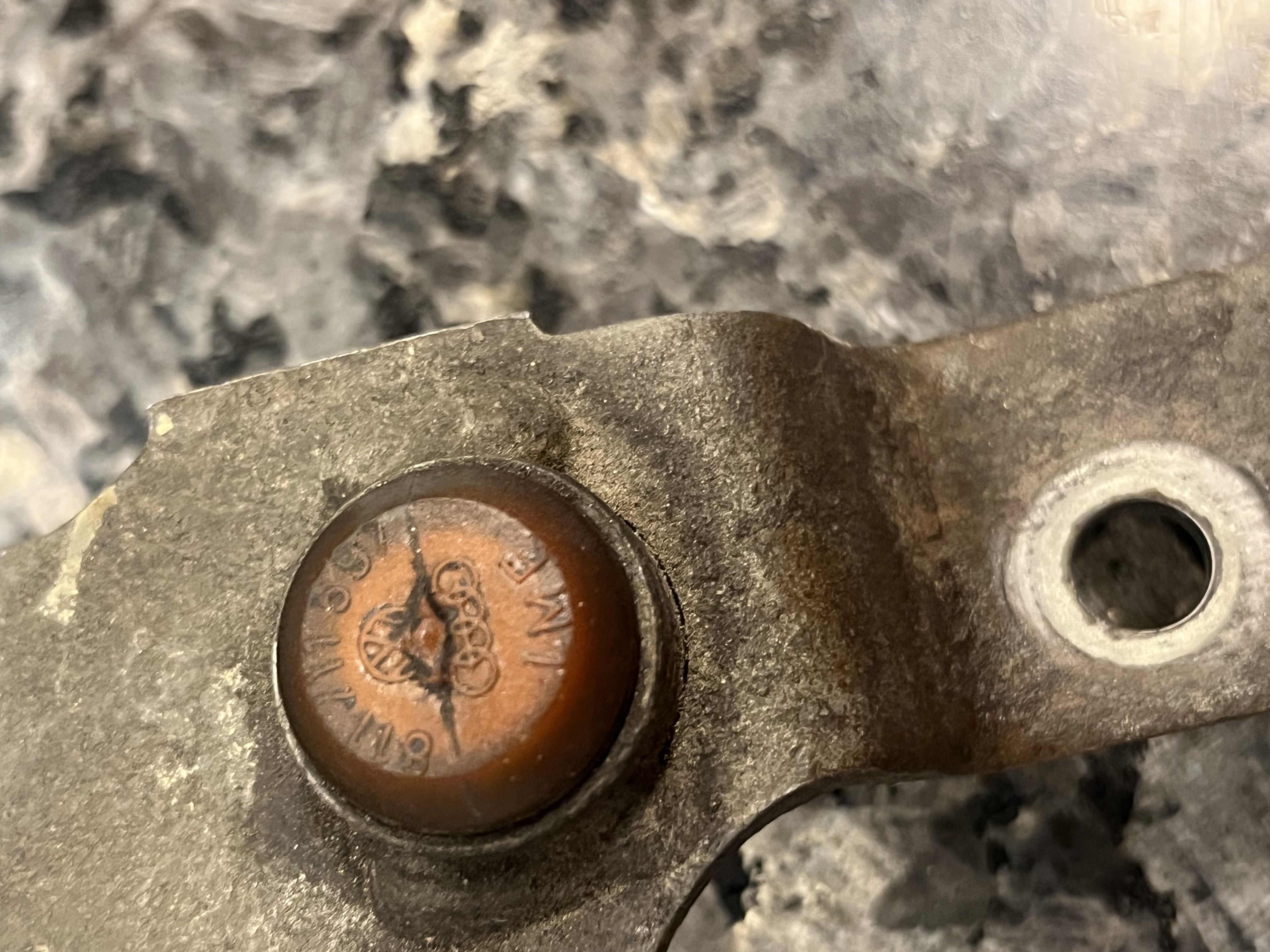

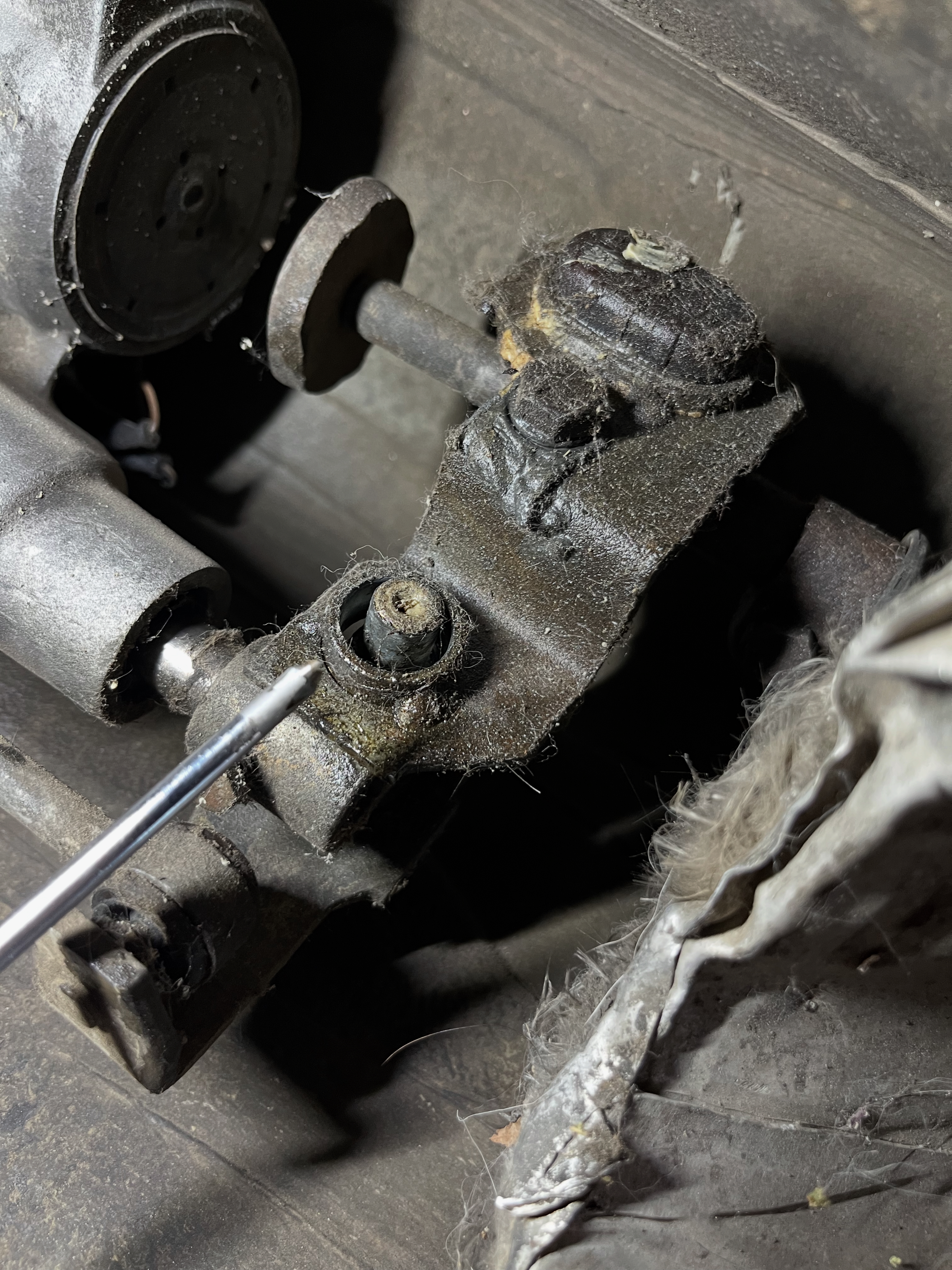

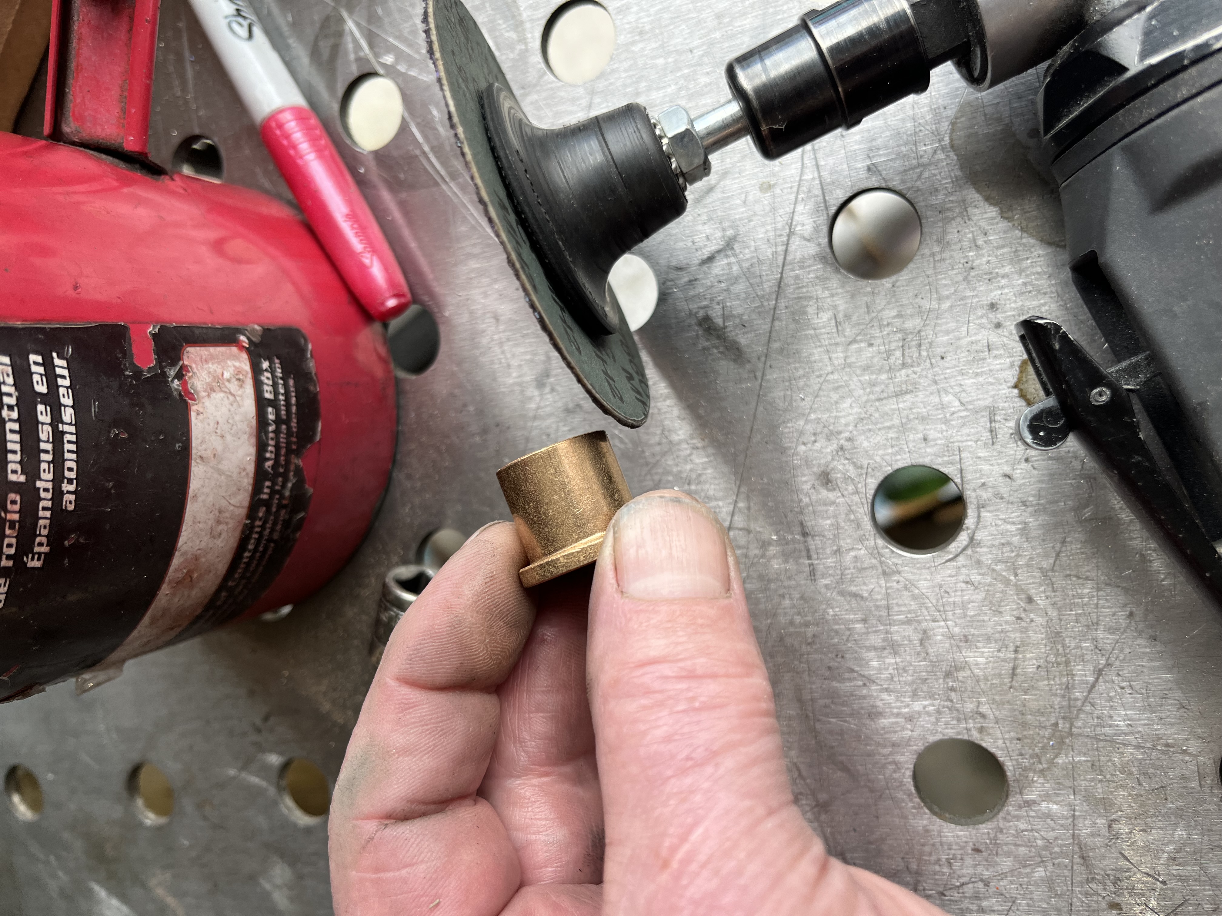

I also had some shift linkage issues to figure out. Some of the parts are unavailable, so I had to improvise with some brass bushings and the precision grinder. The other side is still an OE bushing. Shifts like greased lightning! Thanks for looking.
