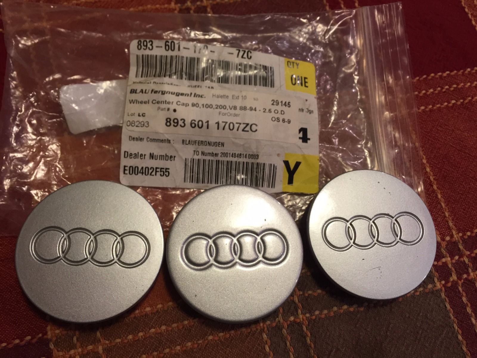

I measure 63.5. The color is not an exact match but really close.

Mcstiff wrote:I measure 63.5. The color is not an exact match but really close.

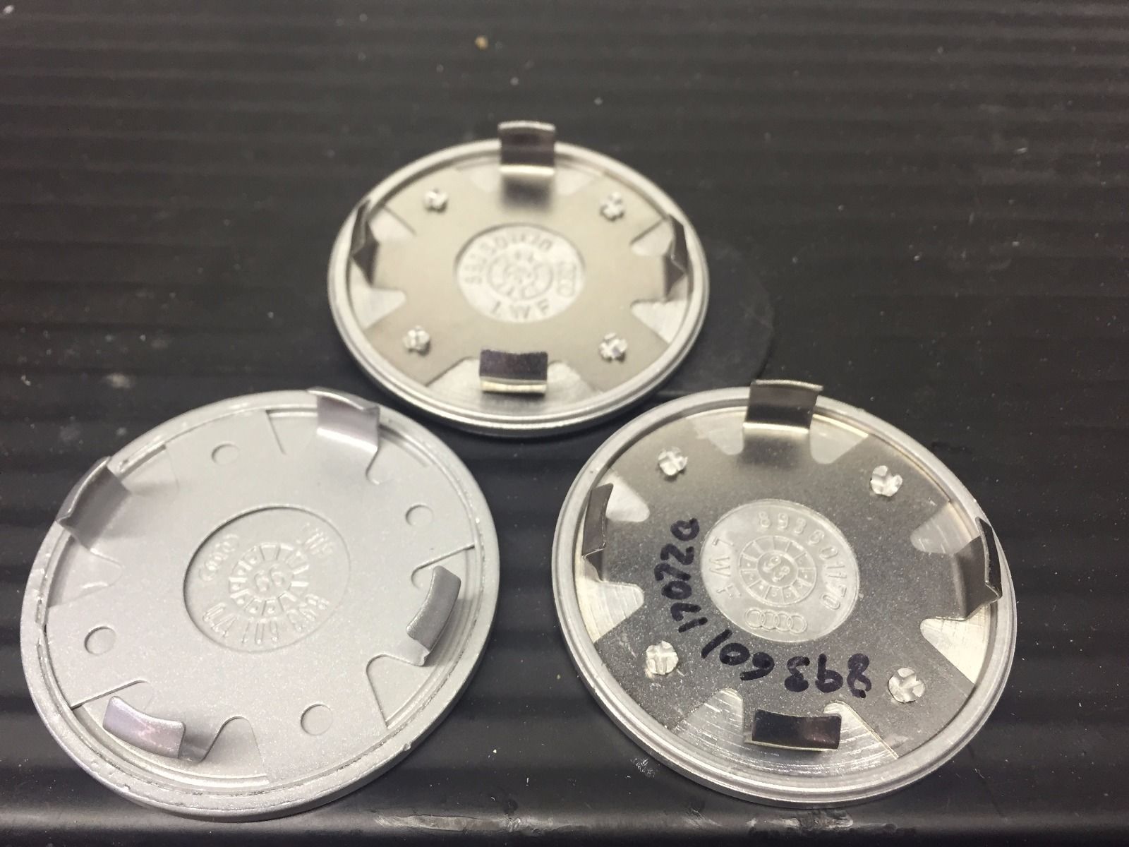

Thanks Ed! That's about what I expected. Now I have to make a decision. To get caps like these and have them machined for customization purposes or go with resin covered "stickers" for Ronal style plastic center caps.
Something marginally interesting, but definitely a concern for me if I go the machined metal cap route is that there seem to be some slight differences between these little caps over the years. Likely due to manufacturing efficiency changes. Check it out... one is not like the others, and none are quite like yours!
CENTER CAPS.JPG (264.12 KiB) Viewed 30831 times
CENTER CAPS 2.JPG (180.78 KiB) Viewed 30831 times
The differences are slight, but they will bother me! I like the smooth edges of the middle one (and yours), but if I have something engraved into it, the tool will leave a more square edge around the lettering like in the two caps to either side. Bah! So stupid lol

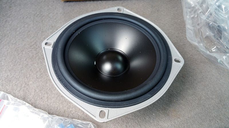

In the meantime, I ordered a bunch of stuff. The first piece in solving the audio puzzle is a pair of JL Audio 5 1/4" midwoofers to fit in the rear doors.
c5525cw (1).jpg (84.33 KiB) Viewed 30484 times
They are the only decent 5 1/4" midwoofers I could find which don't need an enclosure, but based on what paradox11235 did, it looks like I could have saved myself a lot of time and just gotten a 6" or 6.5" woofer to fit in the rear doors. This is what he did:
I guess I'll take a look next time I'm with the car and see what I can come up with. These should sound fairly good though and I'll have them crossed over actively at some point so that they only produce midbass. I may even build a little enclosure for the door there if there is enough space! Otherwise, I'll try to seal and deaden the rear doors.

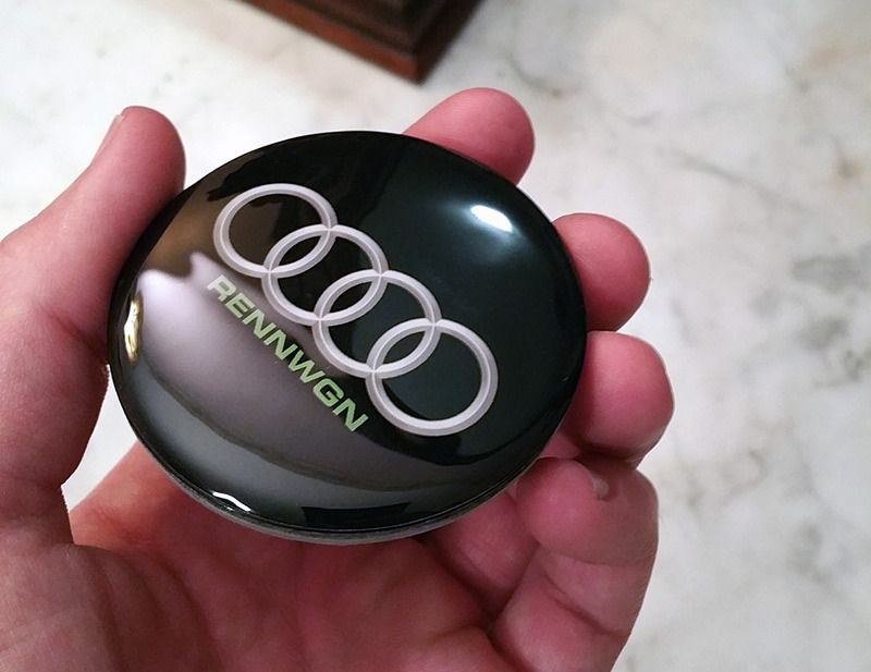

Custom center cap decals in 64 mm from 3Dcarstickers.com / 3DTechlogies (sic?) in Ukraine!
I liked their little letter. The shipping was actually fast!
Here it is mounted on an Audi/Ronal center cap. The size is perfect. I think they look pretty good. The only way they could look better would be with actual metallic Audi rings like the OEM Audi ones. I figured it wasn't worth it this go around though. No pics on the car yet because I need to order three more center caps (this was a trial) and clean the wheels!

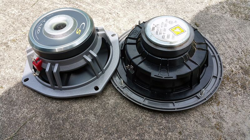

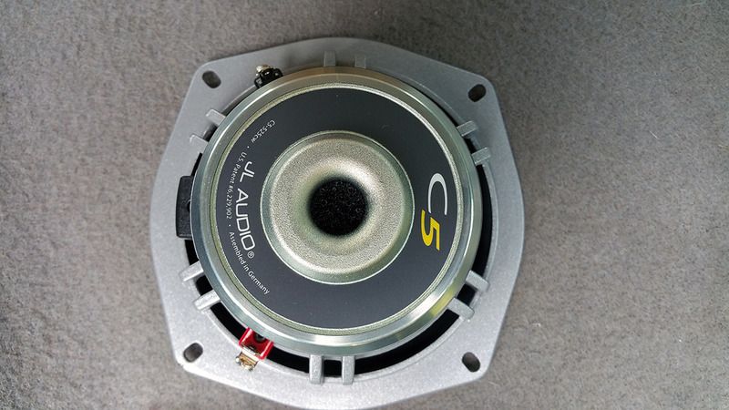

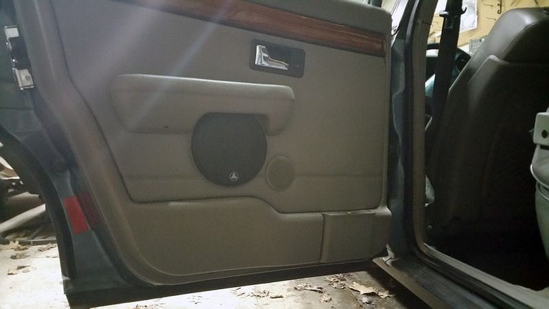

Next was the speaker installation. I wanted at least a little midbass to hold me over until I do the front doors (if ever). I decided against the Focal Utopia 13ws because they need a sealed enclosure, and I didn't want to get into that just yet. Maybe I'll change my mind and try it later, but for now I decided on using some JL Audio C5-525cw woofers for rear midbass. Here are some pictures of them before installation. They are definitely nice and Made in Germany as a bonus!
Compared to the stock speakers... look at the difference in magnet size!
They drop right into the doors easily. There is practically a cavern back there. The focals would definitely fit right in there, but again, custom boxes would have to be made. Maybe later!
I have elected not to run tweeters in the rear as I don't feel it is necessary. I intend to run an 8 channel digital signal/sound processor to best integrate the speakers in the car and bring the soundstage front and center where it should be. Having tweets in the rear probably wont help with this, but I could experiment later. What works for a car without active processing is much different than one without and I've read that having rear fill is actually not detrimental when using one.
Anyway, for now the rear tweets are just disconnected. I kinda wish the grills were gray. Maybe I'll paint them! They don't look too bad though.
After I finished tuning everything with the relatively limited DSP in my head unit, the sound improved a LOT. However, I wouldn't say it improved too much over the stock speakers with the same tweaks in the DSP. Having them crossed over properly (with the DSP) has allowed me to maximize the upper midbass they are able to put out at volume without distortion. I compared when I had one JL installed and one stock still there. They seemed fairly comparable except I think the JL was able to handle a little more power and extend a little lower.
With both JLs installed, it seemed like the improvement was more apparent. The levels of midbass (especially upper) are acceptable now. It actually has a little bump to it if you go in with mediocre expectations! :hide:

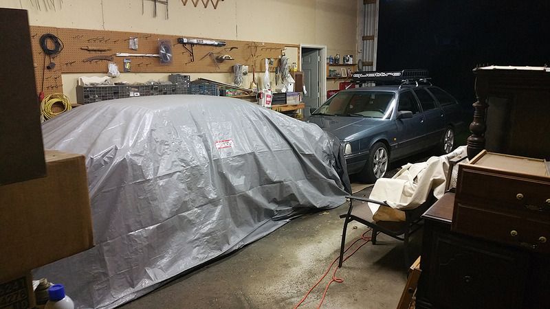

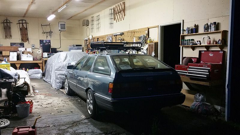

By this time it was getting pretty dark, so I decided to see if this car would fit in the barn behind the M5. It barely does, but it fits!
One day I need to get my uncle to clean out his stuff on that side of the barn and let me take it over for more of my cars!

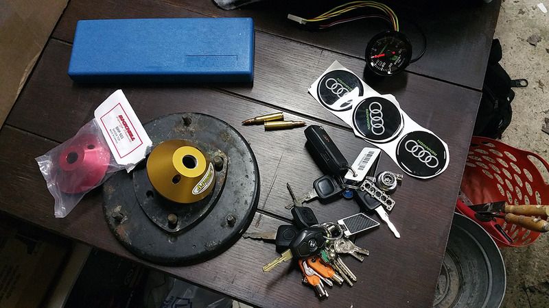

I attempted to measure some strut mount dimensions, but it's pretty hard to do that properly with them installed in the car, so I gave up and decided to stare at the glory that is a stock 3B for a bit :) Oh! You can see the new oil cap I bought too lol. The one on it before was really weird. Good riddance!
Then I remembered that I had parts to use for measuring! I will get on that soon. Here's a picture of that stuff and the contents of my pocket by the end of the day lol
