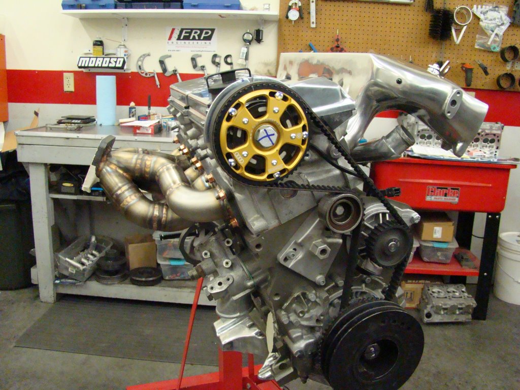

I figured it was about time for an update on the project.

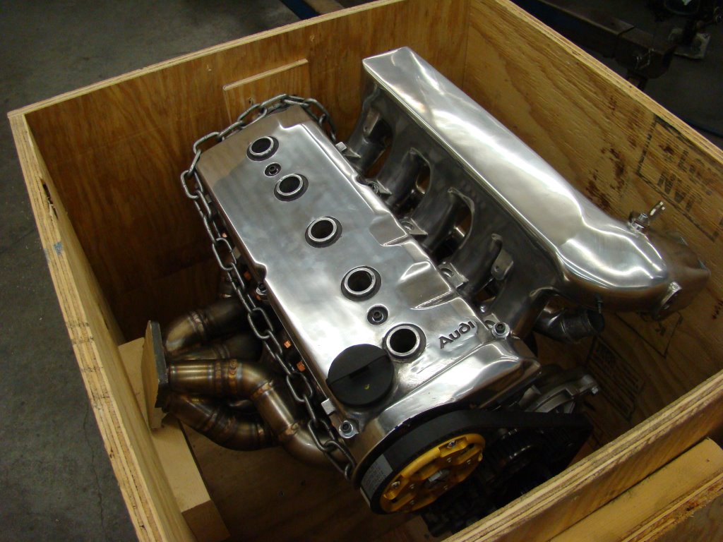

Jeff has completed the motor and has it in a crate ready to shipped To Hank @ Iroz Motorsport in Las Vegas. I spoke with Hank today and I decided he would be the next subject matter expert in my project.
I bought the 6 speed TDI transmission with 3:89's from Hank and since he is making the transmission mounts, why not ship the car and engine to have it all come to life there. I have to put the "K" member back in the car and control arms to get the car rolling again so that I can load it up on a trailer or have a freight company deliver it. I am super excited about getting to this point and have been patiently chipping away at a Bad Ass daily driver that I should have no complaints about power or drivability.
- Looks pretty clean!
- Finished Motor.jpg (176.53 KiB) Viewed 37143 times

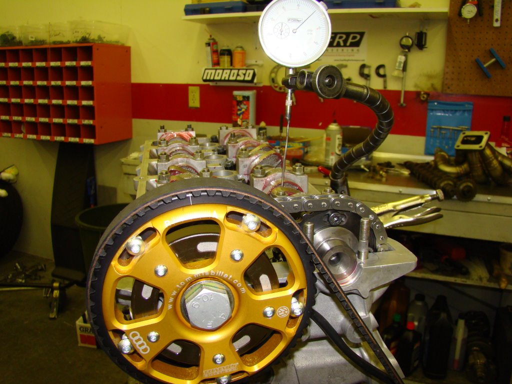

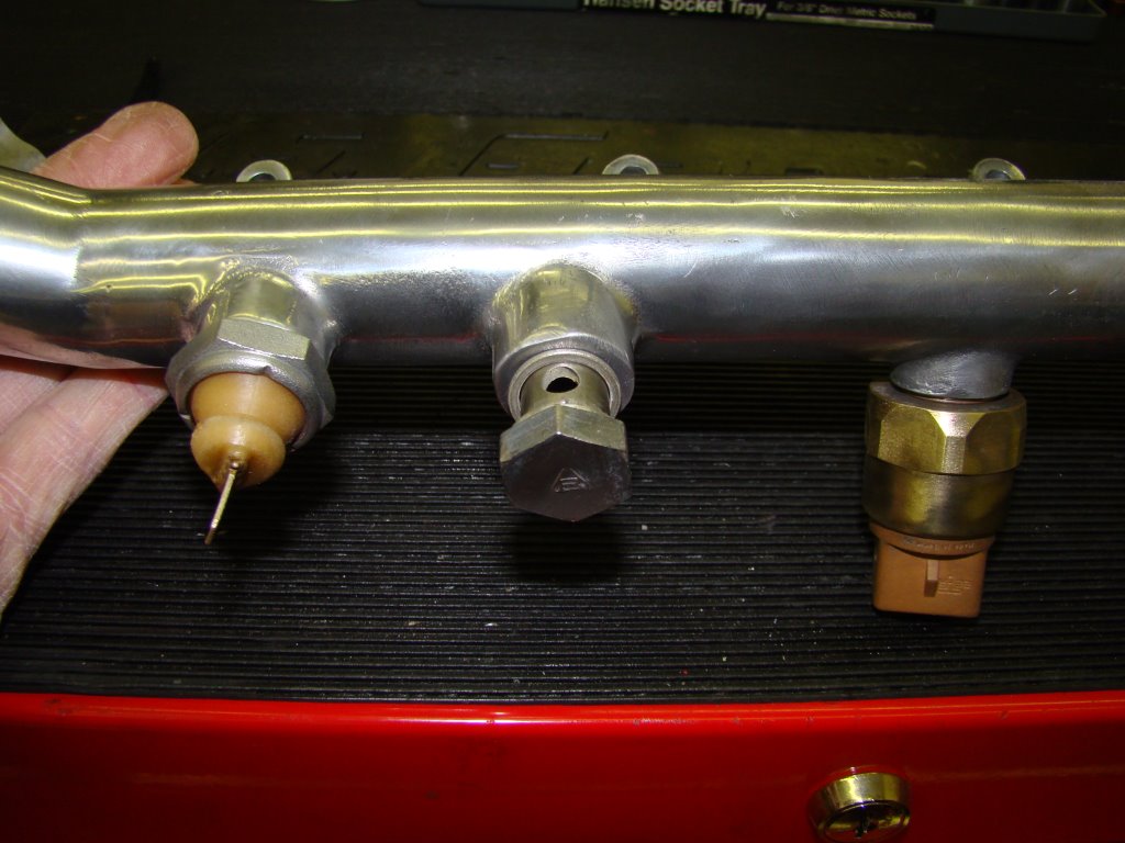

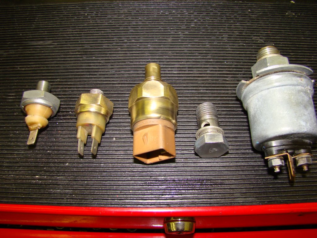

more misc. pics.
- Water Manifold with sensors.jpg (112.34 KiB) Viewed 37141 times
- Various Sensors.jpg (210.33 KiB) Viewed 37141 times
- Degreeing in the cams.jpg (144.61 KiB) Viewed 37141 times

Very nice! Someone's going all out
A little side note, and they look like they're just in there for display purposes, but the MFTS and banjo bolt on the water manifold are switched from how they should be. The MFTS and banjo placement wouldn't make a difference except that the banjo would be way off axis from how the soft line wants to sit. Also, the after-run switch should be the 2 pin unit. That single pin sensor appears to be your .3bar oil pressure switch. Sorry if I'm telling you things you already know...
Oh, and I have extra lengths of the turbo return high temp soft line if you need some. I bought an expensive meter from Audi (only way I could get it), and used about 8-10".

Yes thanks, They were in there for an example. I have a mixture of the original 20 valve sensors mixed with some AAN sensors. And hank knows he will have to modify the water manifold outlet. At the end of the day, Hank will have to see what he can use/not use and then Marc might prefer something else brand/location/type when tuning Vems.

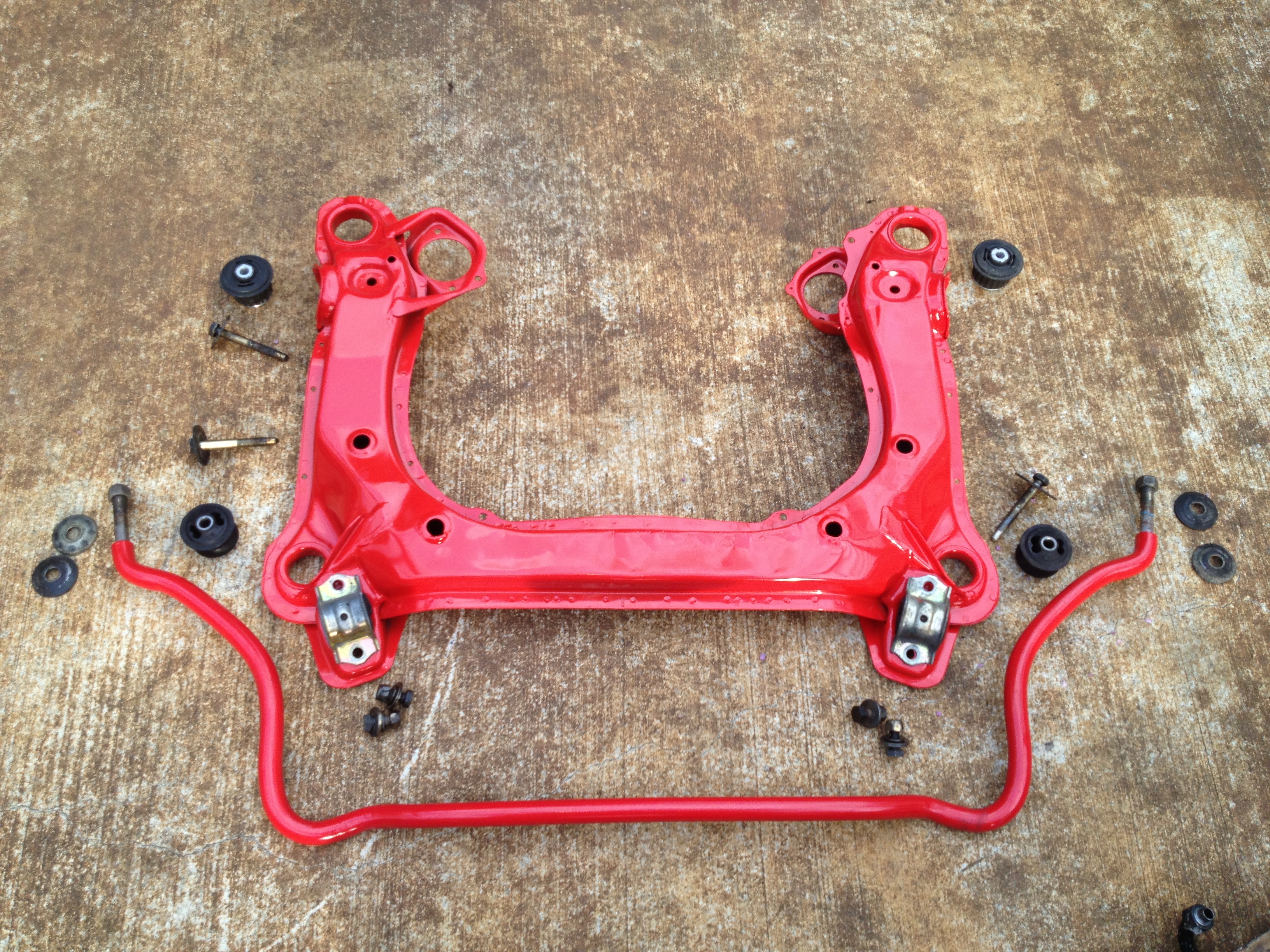

some more pics of progress. I like the way the powder coating turned out. I have to figure out the correct way of pressing in the new bushings without screwing them up. I have a Bentley manual and need to read up. I saw online that they have to be orientated or spun the right direction before pressing into the subframe. It is even recommended that I replace all of the nuts and bolts. Seems like a little overkill to me but i'm sure the whole ''stretch'' calculation is important. Just wish these nuts and bolts were good for more than a one time use. I also ordered new control arms for it today. I should have the car rolling again by this weekend as long as control arms come in.
- powder coated subframe & swaybar.jpg (3.89 MiB) Viewed 37098 times

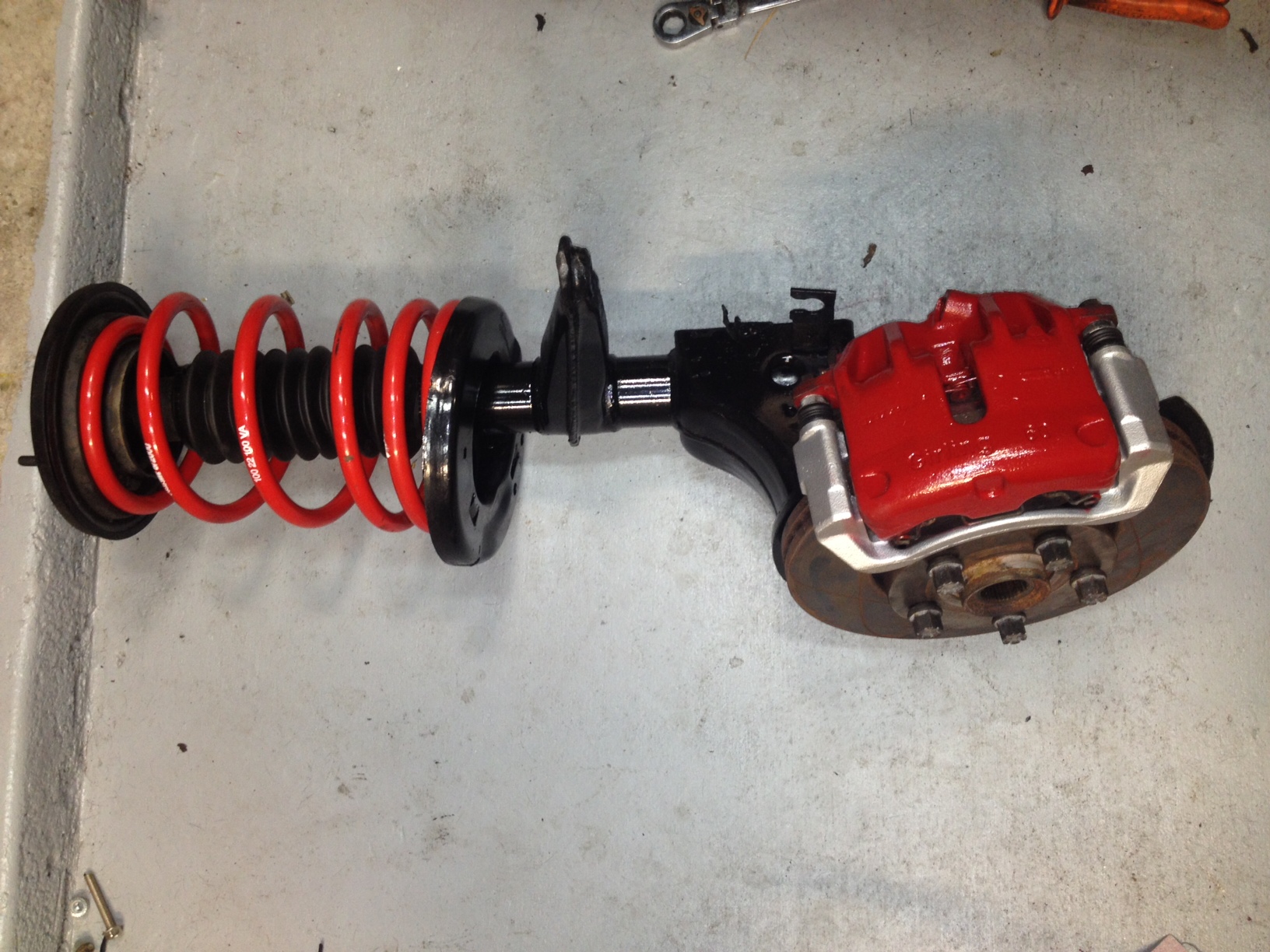

finally got the parts to start putting the car back together. I quickly realized that a car that is 25 years old pretty much needs every item you touch to be replaced or rebuilt. So I got new...
HR Lowering springs
struts
strut bearings
strut bellows
strut mounts
strut bump stops
control arms w/ new bushings and u-joints
sway bar bushings
brake pads
brake caliper guide pine boots
tie rod ends
sub frame bushings (front and rear)
some paint to make it all look worthy of going back in the car
and a rack and pinion
and new stretch bolts for the sub frame which I am leaving to Hank to torque to spec and I am using my old bolts for the time being.

- front suspension.jpg (942.99 KiB) Viewed 36993 times

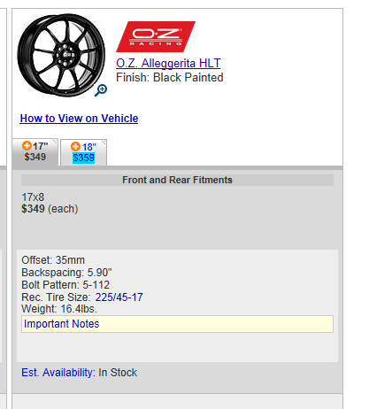

My main concern right now is ordering wheels and tires. I have decided to run 17's and when looking at the wheels, I noticed the wheels that I want that aren't a million bucks, are pretty damn heavy... at least I think so. The range of wheels I am looking at is 16.5 pounds through 23 pounds. And of course, the wheels that I want are 23 pounds. I am worried about the extra weight robbing power. I have spent all of this time and money planning and building for a high horsepower car and I would hate to undo it all by using a wheel that is too heavy. I have no engineering skills or prior experience with rotational mass, parasitic loss, or whatever terminology is used. I do know that I need to ask someone that knows or has been down that road before. I am posting the two wheels that are on the opposite side of the spectrum. Anyone have any advise? I prefer the looks of the ASA AR1 (Black with Machined lip) I just think it is dumb to dump thousands of dollars into a motor to squeeze as much horsepower out of the car as possible if I am just going to knock 50 horsepower off or lose torque by adding 6 extra pounds to each wheel. (just throwing numbers out there, I have no idea)

- lightweight wheel.PNG (28.46 KiB) Viewed 36963 times
- heavy wheel.PNG (27.89 KiB) Viewed 36963 times

I'm not doing any calculations to prove it (though I have done them before and they aren't too terribly difficult to do), but with the kind of power you should be making with this engine, my experience is that these kinds of power losses are negligible. You wont tell the difference. On a 2500 lb car you might notice a little, but I have yet to feel it on a car the size of a t44 with decent power.
That kind of worry is for small displacement, NA applications (like NA Hondas)

Not in my experience... I can make my wheels slip during launch much easier on my 17's than on my 18's...loxxrider wrote:I'm not doing any calculations to prove it (though I have done them before and they aren't too terribly difficult to do), but with the kind of power you should be making with this engine, my experience is that these kinds of power losses are negligible. You wont tell the difference. On a 2500 lb car you might notice a little, but I have yet to feel it on a car the size of a t44 with decent power.
Re: Josh's 2.5 200QT
Wheels slipping might not be a bad thing. It might prevent some broken mounts or cv axles. I definitely will not run 18's due to the unique fender design and lack of flaring. I want to keep as much sidewall rubber to absorb as much of the road as possible. I can honestly say that I have never driven anything with this much horsepower as this car will have and I will just have to see how the car acts. Worse case scenario, I might be forced to convert to V8 front and rear fenders to put wider tires.

There are so many factors involved there though... are your 17s really lighter than your 18s? Are tire compounds, tread patterns, conditions, widths, etc. identical? If not, then I don't think there is a comparison to be made. Even sidewall height differences can make a change there. The only real way to tell how weight change affects the hp that gets to the ground is through a calculation or measurement. Transient situations are where you'd notice the most difference though (launching is the perfect example).mushasho wrote:Not in my experience... I can make my wheels slip during launch much easier on my 17's than on my 18's...loxxrider wrote:I'm not doing any calculations to prove it (though I have done them before and they aren't too terribly difficult to do), but with the kind of power you should be making with this engine, my experience is that these kinds of power losses are negligible. You wont tell the difference. On a 2500 lb car you might notice a little, but I have yet to feel it on a car the size of a t44 with decent power.
