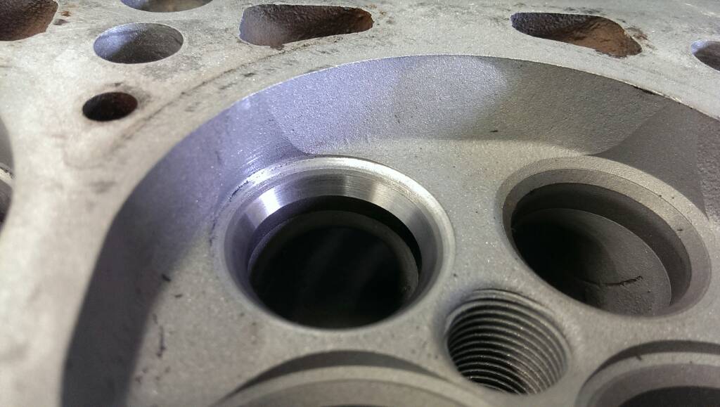

Well, as usual with any build, a hurdle has risen... The machine shop cutting the seats calls me in to have a visual inspection of what he's encountered with the head.
I prescribed cutting the OE valve seats to accommodate larger valves. They go ahead with one exhaust seat and finds that our seats are the same size as the valves and when cut the valve itself doesn't rest on the seat but protrudes into the aluminum portion around the seat as well.
Is this normal? Usually seats are larger than valves and allow for cutting but it doesn't seem like the case on our AAN heads... If I need to reseat the head, I'll just slap my old head on it and run a stock port as I'm not about to spend another grand on that...
Left has aluminum blurring the seat line, Right shows where that line should be

Posted: Sat May 18, 2013 10:15 am
by DuBistS4
.5mm oversized? My valves went in with no issues like that, but they were only .5mm oversized.
Re: A tale of Rubí...PTE5862 .64 a/r Received, Head Rebuild
Posted: Sat May 18, 2013 10:25 am
by mushasho
Yeah +.5mm
Yours went in without a recut?
Posted: Sat May 18, 2013 11:24 am
by DuBistS4
No they were recut but everything fit correctly.

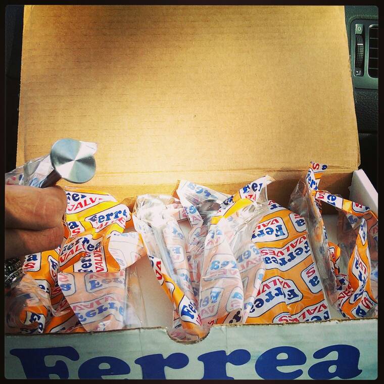

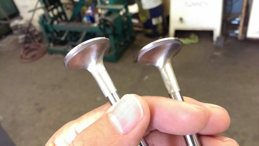

OB, I probably missed it, but where are these valves from?
Posted: Sat May 18, 2013 12:24 pm
by mushasho
S4Pirate wrote:OB, I probably missed it, but where are these valves from?
Posted: Sat May 18, 2013 12:56 pm
by mushasho
Intake valves (10) F6030
- stainless steel dish face
- 32.5mm head diameter
- 6.96mm stem diameter
- 2.6mm tip length
- 95.5mm overall length
- 15? Super Flo. Radius Groove +0.5mm oversize
Exhaust valves (10) F6028
- 28.6mm head diameter
- 6.93mm stem diameter
- 2.8mm tip length
- 98.3mm overall length
- 22? Flo. radius groove +0.5mm oversize special alloy

Posted: Sat May 18, 2013 2:56 pm
by mushasho
Popped these in...
