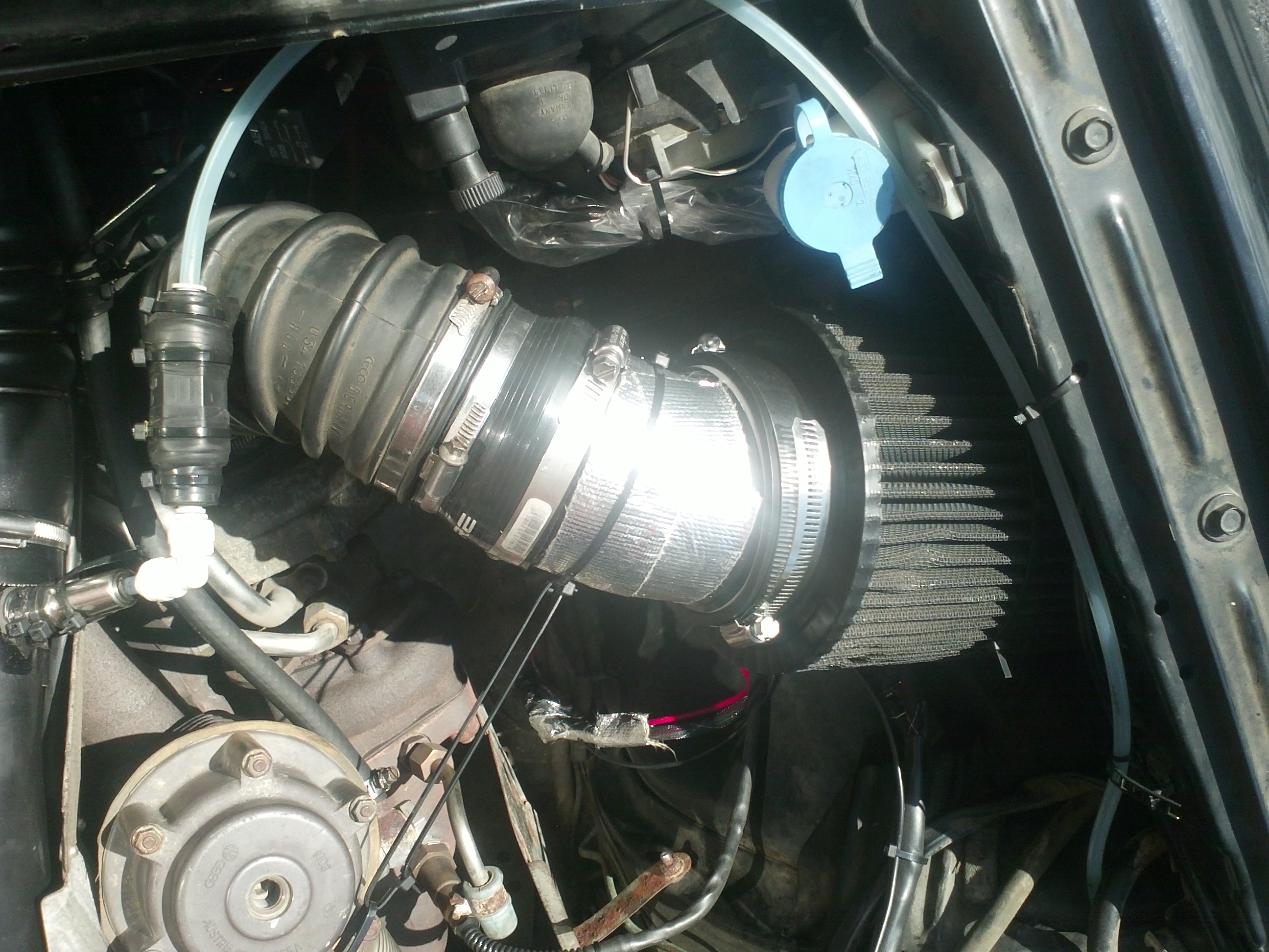

A new development.... I am now back to the drawing board concerning the cold air intake and refDC N75 table. I had to ditch the restrictive K&N Apollo filter system as it was choking the car big time. I threw something together using the massive chevy Tahoe K&N filter I used to run on the 5K and it doesn't really look any better but its gonna make the engine feel like it recovered from black lung over night. I hope it fixes the high RPM choking and when I ran just the old MAF with its mesh screens without the Apollo the car boosted WAAY high above the 25 PSI my gauge reads. That's a good indicator me thinks. Gotta redo the tables now :)

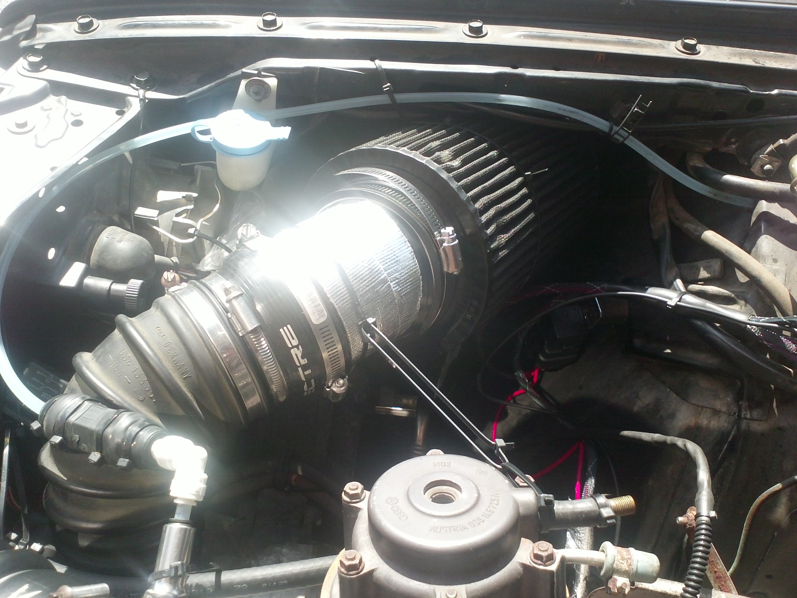

Glad to hear that your car is up and running! Interesting that that Apollo intake is so restrictive. Just out of curiosity how did you run the big chevy Tahoe air filter on the 5K? Was that with the stock airbox somehow?

Hah yeah it was quite unnatural looking on the 5k!! I bought the cheaper air filter I could find and cut the surrounding seal off and put it in the air box. Next I cut the box's cover with a hole saw where the OEM snorkel was and cold welded a 3" pvc piece in it so I could run some more piping from there to a remote location just forward of the passenger front wheel. I then attached the filter there but it was too close to the ground so I put the K&N drop-in filter back in the box and left the remote piping in.. The car came with the oils cooler bypassed and that's the ONLY reason I I had room in that area for the filter. I was able to put the old filter in the 200 with $8 in clamps and tubing. Thanks for the support guys. Anyone need a low cfm Apollo? Lol.

I suppose these deserve the time of day on the net. The new filter setup: the filter is three times as long as is visible.

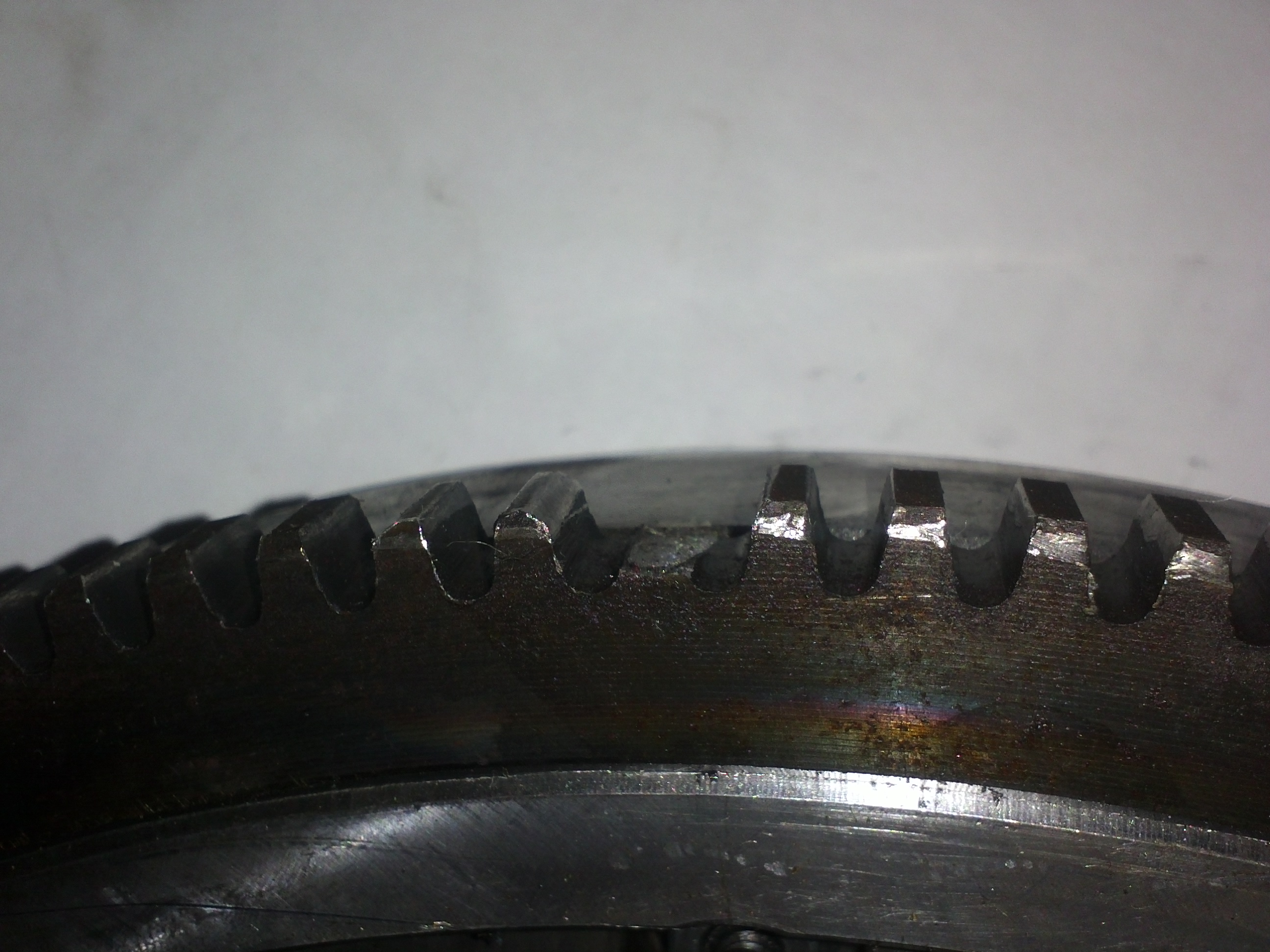

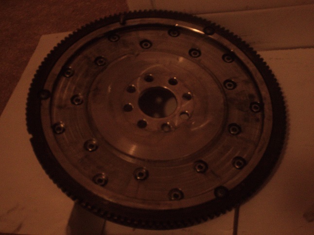

Poor flywheel :(

Definitely Matt! Its my massively expensive memento now :)

your anger is still focused in the wrong direction Julian. if you sneeze wrong those flywheels will strip teeth of the ring gears. ask Hank how he feels about the material they use.
