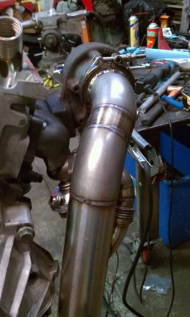

Post by quattro87 »
It looks good. I like how the turbo outlet is now v-band. It makes it sooooo much nicer to work on.
Re: Ed's 1991 CQ
It has a nice clean look that way. It would be cool to take to bolt bosses off but that is not making anything faster. Bullseye makes a v-band HX35 housing.
Re: Ed's 1991 CQ
Honestly, the bolts are not htat visible from the top. Put one of htose blankets over the holset uglyness, and leave the oversized compressor housings holsets are famous for!!! The blanket would likely hide everything but the beautiful vband connection on!

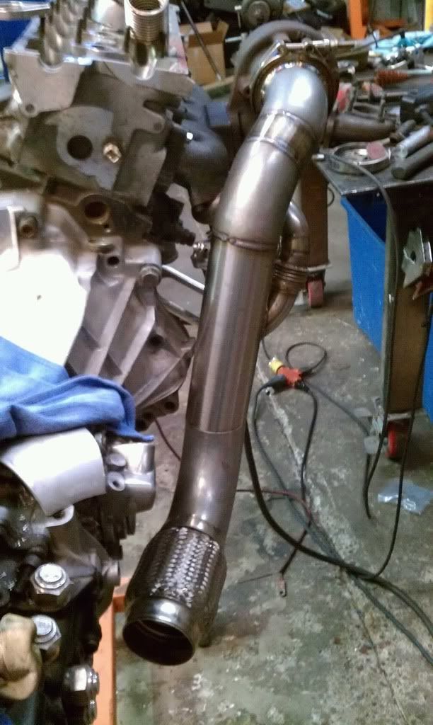

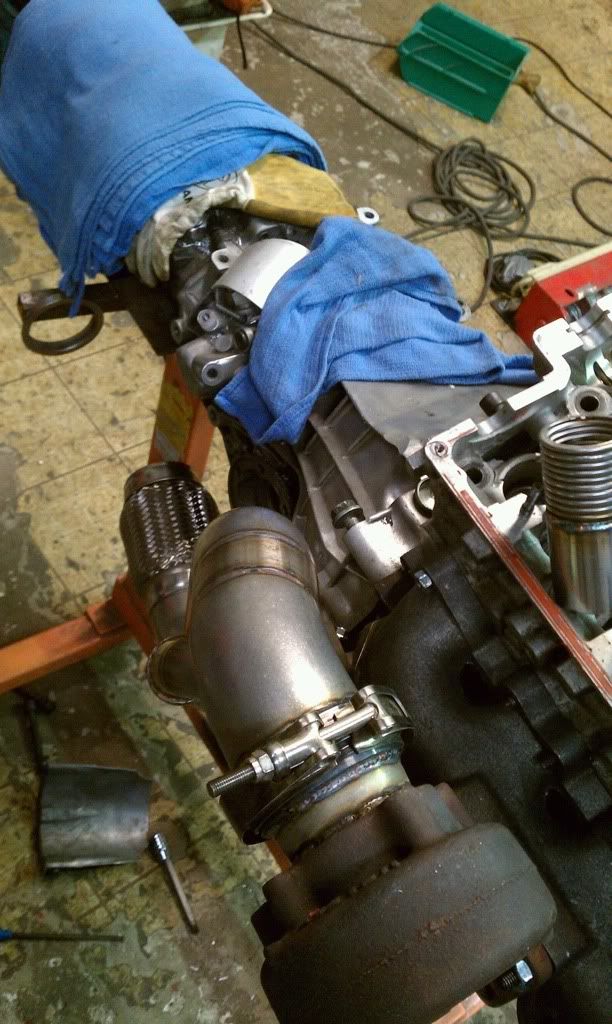

More pics of the WG setup please. That modified flex pipe is great! I wonder if Hank would be willing to make another small flex like that out of leftovers from the original...
Ed's 1991 CQ, H1C, SEMS, work work work!
VWAudi4Life wrote:More pics of the WG setup please. That modified flex pipe is great! I wonder if Hank would be willing to make another small flex like that out of leftovers from the original...
I'll take more when I have it mocked up.
Re: Ed's 1991 CQ, H1C, SEMS, work work work!
I make the flex couplers from scratch, so the length can be custom.
