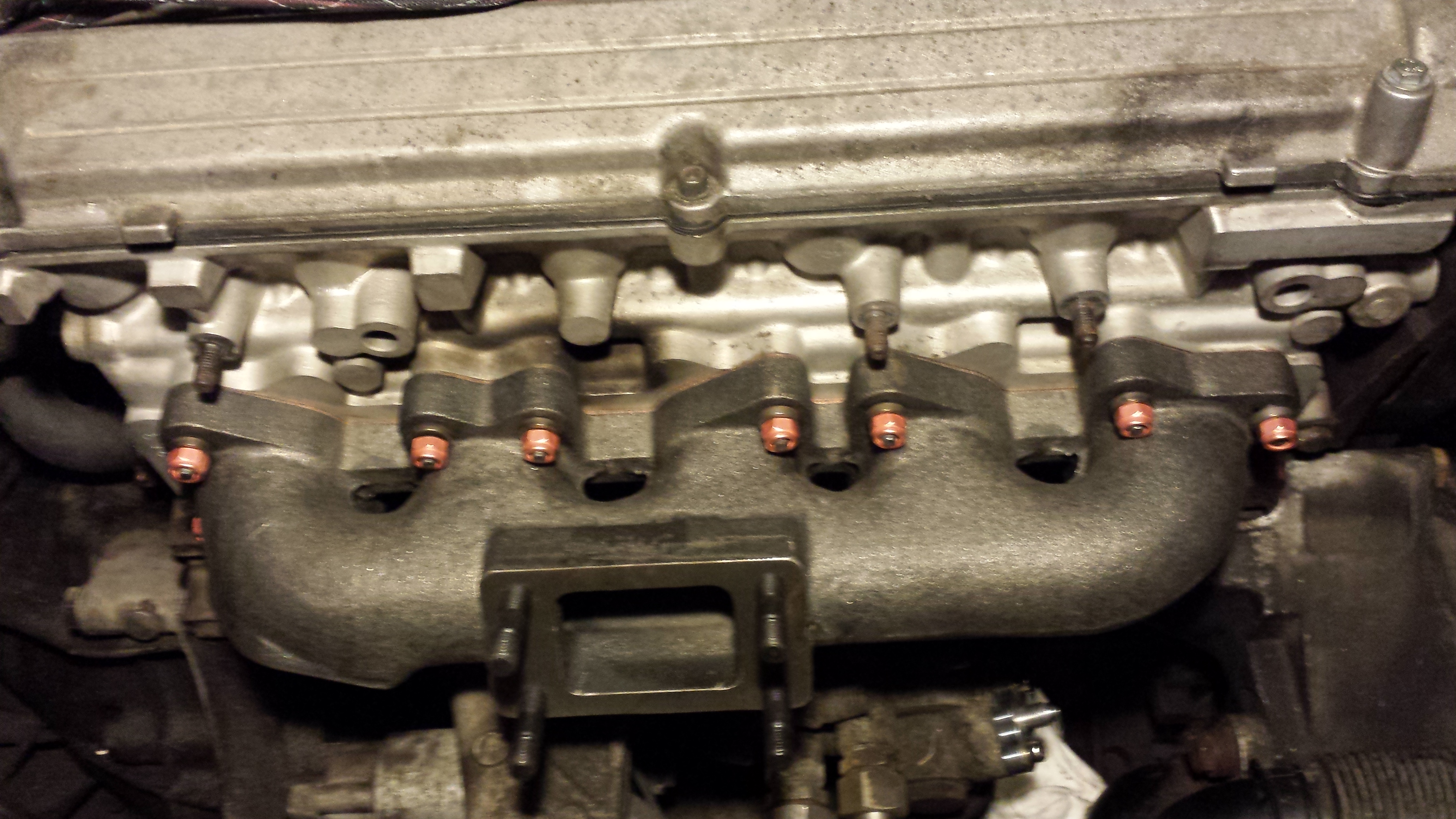

Love showing off my nuts
Being held up by the vibrant fittings and a 90° oil feed line elbow for the 034 flange. Pretty much all the F*ingUSPS's fault. Can't stand them. They never fail to disappoint out here in PA. Hope none of you work for them.

The manifold going on was just something to take my mind off things. Torquing it on right now actually :) Needed some progress to show for the weekend after the usps upsets

I must say it's been much easier on this manifold. Removal of the stock and ebay ones made me thing the studs were a cruel german joke on enthusiasts ;) they're going on well this time tho. Still slow but less shame involved hah

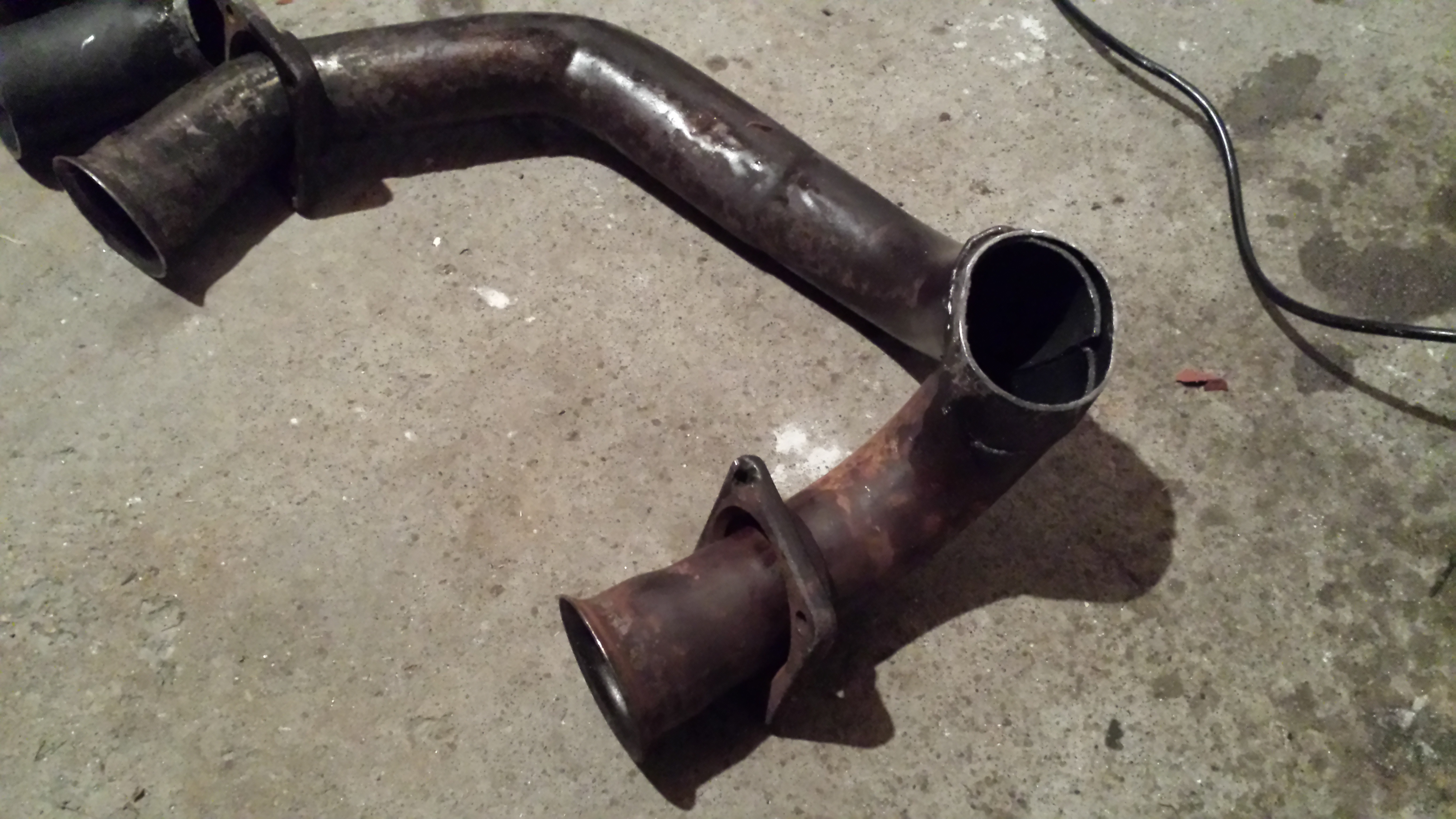

Some bitching scored me a free elbow via priority mail. Still getting boned by the welder tho. This OD is about 3.1" by taking C/Pi. Measure 9.75" around right above the weld so I'm going to take a shot at welding a 3" pipe to this for the DP. 3" v banded DP to stock dual 2.5" should be fiine.. Besides I love my exhaust from that point back lol. No more bottle-necked upper DP :wtf:
My "plan" is to crimp the 3" pipe around that area at the welds or butt weld it I guess.
