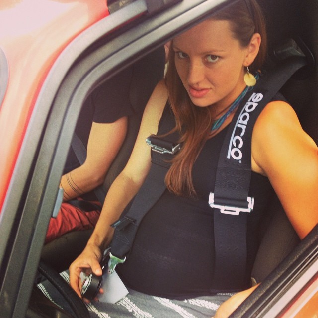

Won my hub off ebay, have the wheel, just waiting for shipping now :) Anyone need a hub for an 80/90/S2 etc?
I drilled/mounted/welded nuts for the eyelets onto my seat frame yesterday for the harness (well, dad did the welding). I love it. 39 week pregnant Sarah, notsomuch

Sorry, cant really help with the 01E swap, but, um... damn she does not look happy sitting in that seat... :lol:

Does not look happy…. LOL
