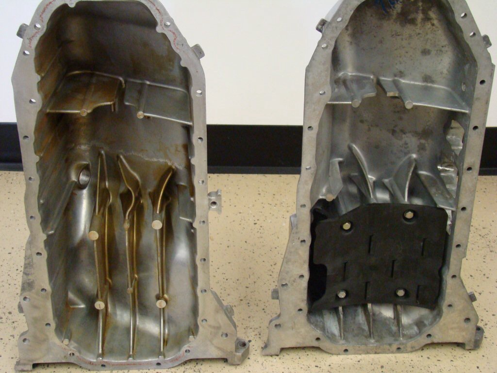

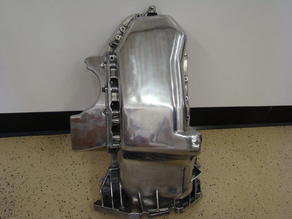

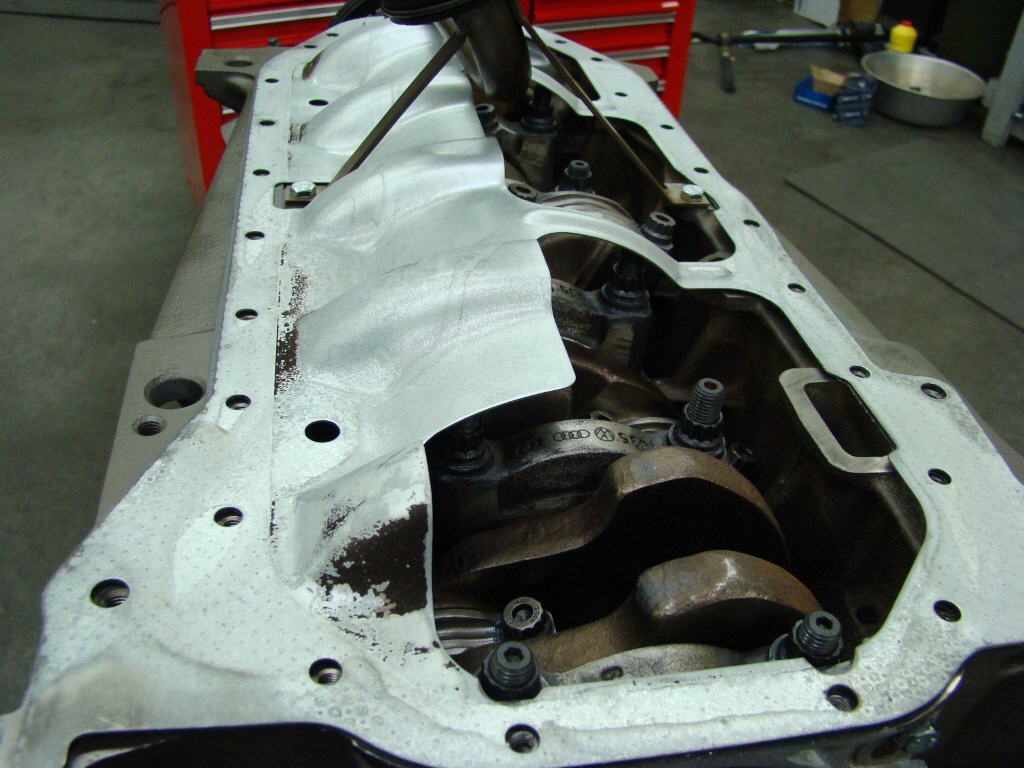

Here is a combination that I did to try to help the sloshing of oil into the block breather. I used a 7A oil pan and combined it with an AAN windage tray. notice the extra "slosh baffle" that the 7A has in it compared to the AAN. Plus, you get a little more oil capacity with that pan.

There is no difference between the AAN and the 7A/3B oil pan capacity.2.5TYPE44 wrote: Plus, you get a little more oil capacity with that pan.
Re: Casey's 200 20v: Compression Test
Wut. Yes there is, it has the extra side extension cavity thingy. Or does it only fill up to that point anyway? Iuno, I always thoght mine took more oil
