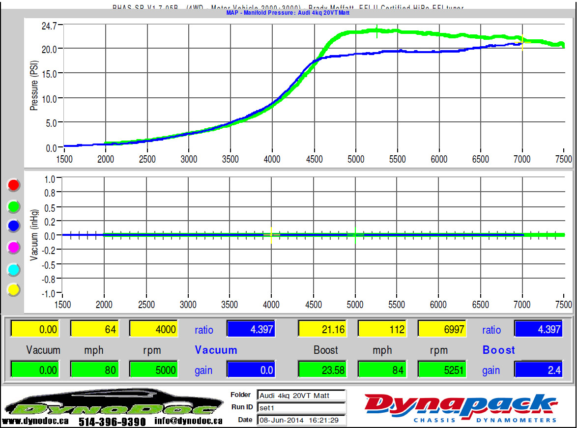

Okay so here's a full write up. I'll try to be quick :)
I arrived at Brady's at 4 on Saturday, thinking I might have enough time to give the car a quick tune before dinner at 8. Well, he was balls deep in a RWD Skyline that had several hiccups and were finally starting to "turn up da boost!" as the very french owner, Max, put it. The car ended up making 460whp and 400wtq on a cast 3071, I'm not sure what boost. Very quick car... "TABERNAC!"
So I stayed over at Brady's instead of Don Smith's place (of QW fame). Dad met us at the shop in the morning and we had the car on the dyno at about 11. But then the keys were locked in the trunk... damn it! So I need a new trunk locking mechanism now. Once that was done, we found out the center diff had to be locked, and of course my vacuum doesn't work. So we jacked the car up and pulled it into lock manually, and then zip tied it.
Did I mention dad and I were supposed to go to the race at 2? When we finally had the car working right on the dyno, it was 2:00. Ugh. So we skipped the race, which we thankfully didn't already have tickets for.
The car made hilariously crap power on the first pull. The timing pull was absolutely killing it. 10 degrees is not enough to make any decent amount of power with. So we started to investigate with a temp gun and found that the IC outlet was only hitting about 45, and the intake manifold was only around 45*C as well. So we pulled the MAT sensor, and in a 30*C room it was reading a minimum of 39 after putting a cold wet paper towel on it. Then it went back up to about 41. So at least at 30-40*C my MAT sensor is 10* out. We shifted all the cells in my MAT timing pull table one to the left, then deleted the -40 cell because WTF and added a 100* cell. There were no signs of det at 85*C intake temps with about 19* of timing up top (two degrees removed I believe). That's when the car made 360whp. BUT, on the street, I wasn't able to get the intake temps above about 55*C, I believe the added spark probably helped bring them down if anything.
So that's timing... fuel was good, only minor changes which I then had to change a bit later on the road. A little here, a little less there, etc... no biggie.
Boost. Well, as you can see from the graphs, the car made way more power with timing at the same boost than with less timing. Obviously. But just for comparison, below are my wastegate pressure pull, which creeps (I then took 3 turns out of the WG and we enabled boost control), and the final power pull. Power/tq and boost. We were out of time and had to call it quits at 23psi. We had a 7+ hour drive ahead of us and it was 6 by the time we left Brady's. We tried upping the duty cycle a little, and it yielded no power gains, but also almost no boost gains if I recall. At that point as well, the IAT table was pulling a little more timing so I think that negated the MOAR BOOST. BUT, I think now, out on the street if I add some boost it WILL be faster. I think I'll go back to the 285kpa I was running before, it's just too bad I couldn't see it on the dyno. The only thing that makes me doubt it would make more power is that it didn't on that one pull, but I think that was a MAT/Timing thing more than a more boost not doing anything thing...

SO, am I happy? Yes... the car feels SO good now, at places I gained 90WHP!!! On the highway is where I really notice it is FAST, in 1, 2 and 3rd gears the torque is enough to make the car feel fast. But now it really picks up and goes, speedo says so too... :) Of course I wished for more power, I think 375whp is a really easy target. But I am very confident with another 2psi and leaving everything else as is, it should be very near that figure. Also, my car was pulling timing on the 360whp pull which it doesn't do on the street because of better IATs. Brady is the man, I HIGHLY recommend hitting him up if you are looking at making some real power. Street tuning is great but there is nothing like timing on a dyno.
