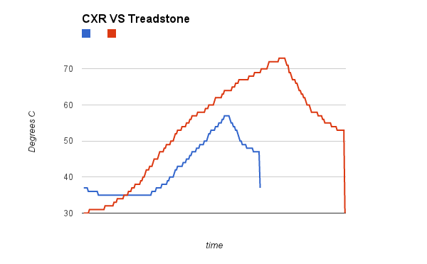

Happy to report that with despite a 7 degree rise in ambient temps, between the new IC and dropping my air filter down low, I've dropped my intake temps by 18 degrees. From 73 to 56. That was with a slightly heatsoaked IC, I didn't get them that high again. Just a simple 3rd gear pull. Graph coming soon.

Okay, unfortunately not an apples to apples comparison as the CXRacing run appears to be in 4th. But it also goes from 4k to 6500 rpm, whereas the treadstone is 3k to 7500rpm. You'll also notice the lower initial temp with the cxracing. First up is the log I just took - boost vs MAT

Next up we have the "comparo". The other thing you can't see is the huge increase in timing, and the extra fuel I had to give it because intake temps were so much lower. It went from being a solid .72 lambda to .81, just from MAT decrease. Holy balls. I just added a little to make it a sweet .79-.8. I'd say with the extra 6 degrees + of timing and cooler charge air I had to pick up a few ponies...
cxracing RED, treadstone BLUE
Edit: I'll have to get a 4th gear log. And sorry about the graphs, on the netbook and tried using google sheets. Pretty hilarious but decent I guess...
