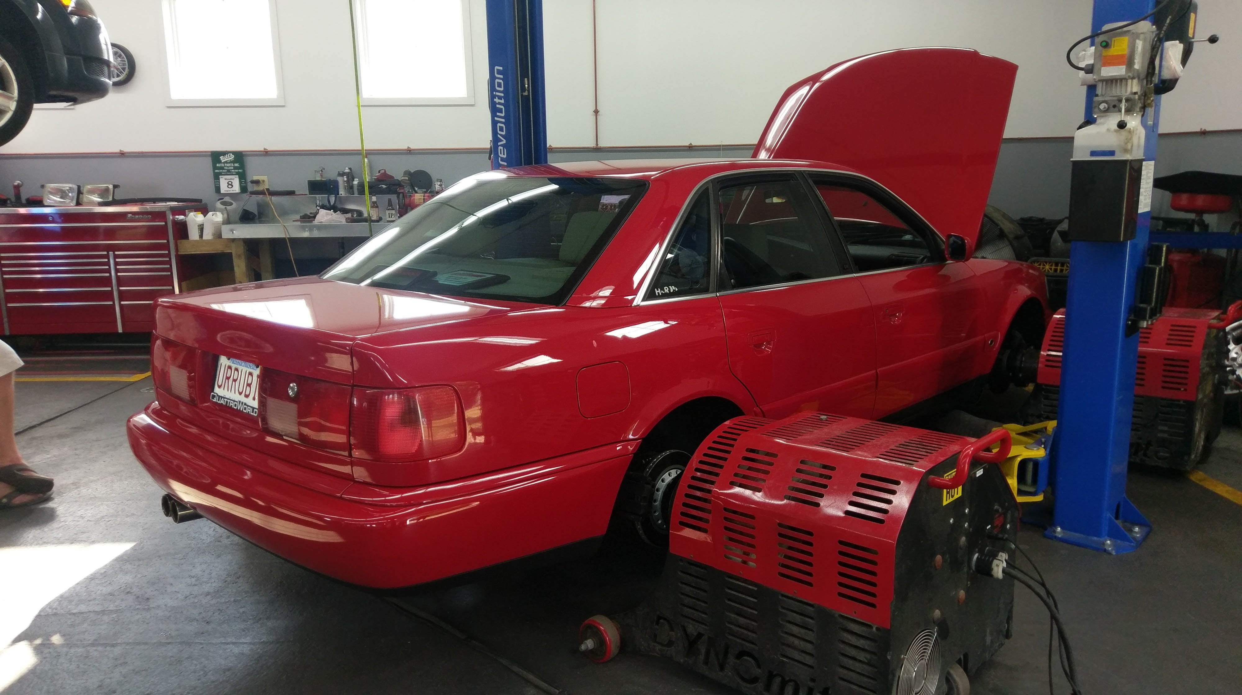

Dyno! Vids! Kills!
Re: Rubi Beta v3.0 - Finally Assembled
:metoo:
Best I can do is show that is makes a paltry 20psi at 4300rpm, 4th gear... on pump 93, no spool valve, v-Band open scroll .82 housing, stock port head, laggy PTE turbo...
I'll verify in VEMS later on...
I bet it's pulling hard right there
