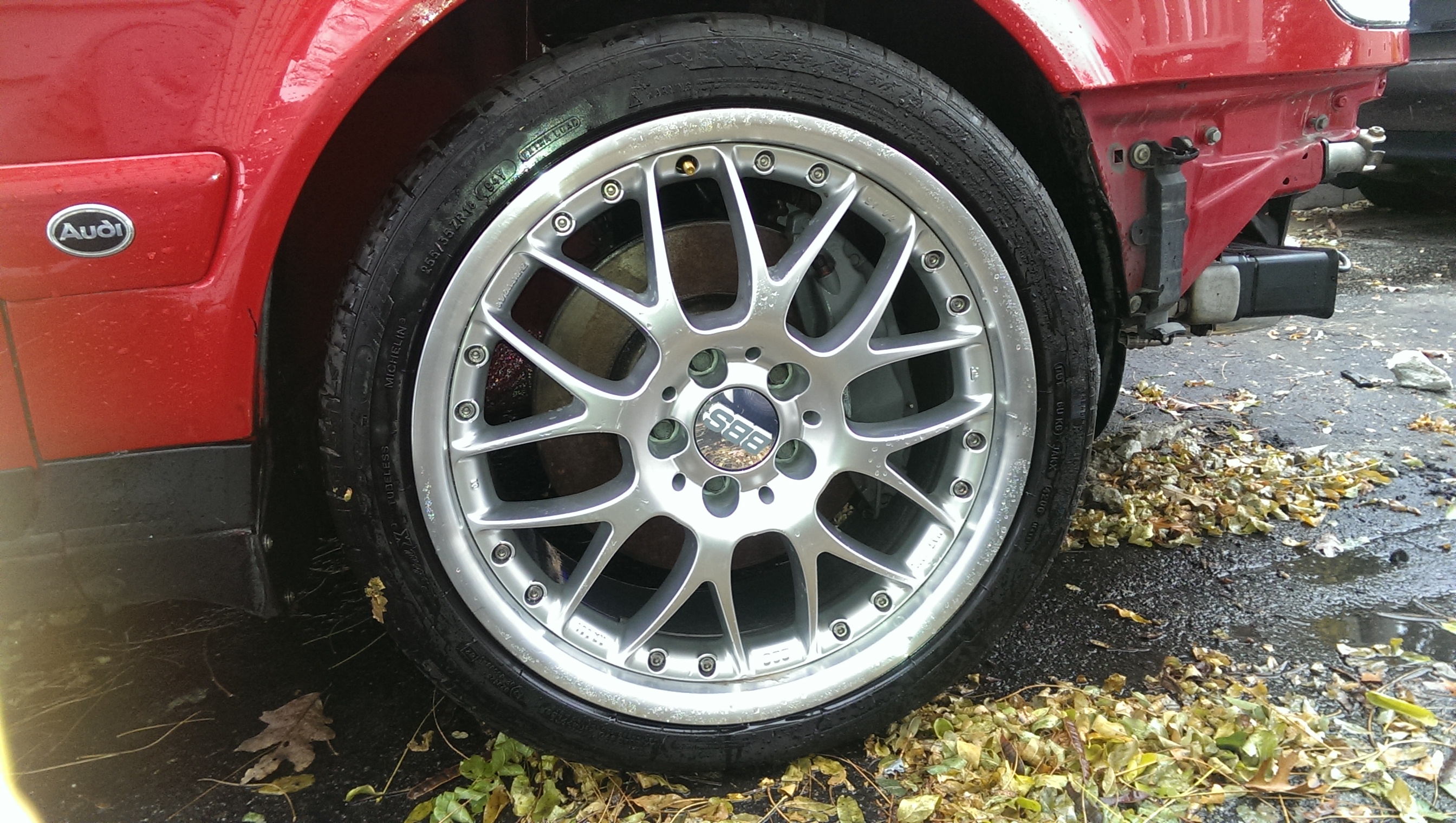

Hmm, interested in the full side view with those wheels... and of course VIDS
Re: Rubi Beta v3.0 - The Assemble Phase...
loxxrider wrote:Hmm, interested in the full side view with those wheels... and of course VIDS
I'd love to get the coilovers on to get the full effect of the "stance"...
but in the meantime...
Something like this?
