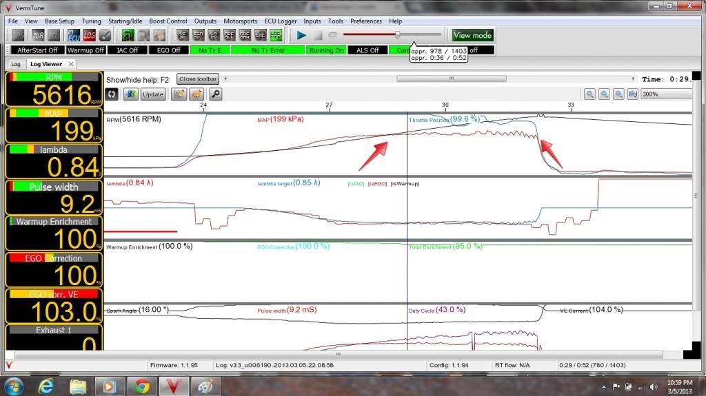

So, the past couple days Hank and I have been working on getting Oceanic all tuned up. We are running into a problem though, we are getting maaad boost oscillation after 6000rpms and we are at a loss as to why. You can see it pretty clear in this log...
(This log was taken with the vac line disconnected from the BOV and the BC was bypassed to rule out those two things)
SO we are thinking either the WG or the turbo is freaking out after 6300rpms. Actual boost levels don't seem to make a difference, it is most definitely rpm based. Do you guys have any BTDT for us? Could having the FPR, WG and BOV on the same vacuum circuit be causing this? Any thoughts guys? I am fully open to any ideas.

Re: Ben's Oceanic H1C/K26 AAN 4kq - Boost oscillation help
Can you send me the actual log?

Re: Ben's Oceanic H1C/K26 AAN 4kq -Boost oscillation help ne
Does the same oscillation occur with closed loop boost control turned OFF?
That screen shot is just with spring pressure and plenum referene to the bottom port. So about 220kpa with a 2.2 bar spring. Can go much lower with it withouth swapping springs. NO bost controller whatsoever, so no software settings. But since you asked, you have it with it in closedo r open looop, and it doesn't appeak to care if there is more boost either, it will occilate the same amount

I am going to try rerouting some vacuum lines today and see if that makes any kind of difference. It doesn't look to be software related at all. Something on the mechanical side is happening, I'm just not sure what it is yet.

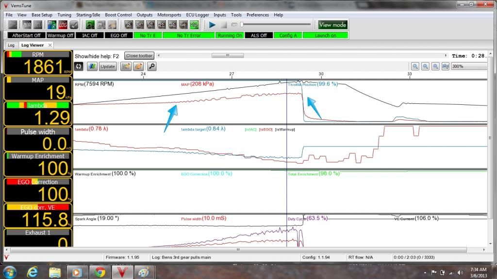

Here is another Log with the stock WG spring, as you can see it did it with the stock spring as well...

Hank wrote:That screen shot is just with spring pressure and plenum referene to the bottom port. So about 220kpa with a 2.2 bar spring. Can go much lower with it withouth swapping springs. NO bost controller whatsoever, so no software settings. But since you asked, you have it with it in closedo r open looop, and it doesn't appeak to care if there is more boost either, it will occilate the same amount
Little early to start drinking eh Hank?
Good - just wanted to make sure software/tuning (specifically PID settings) had been ruled out.
So on the mechanical side, that pretty much leaves the turbo itself, WG it self and/or Vacuum lines. SO just out of curiosity (correct me if I am wrong) is there where a ported cold side housing comes into play if this turns out to be some form of compressor surge happening?
