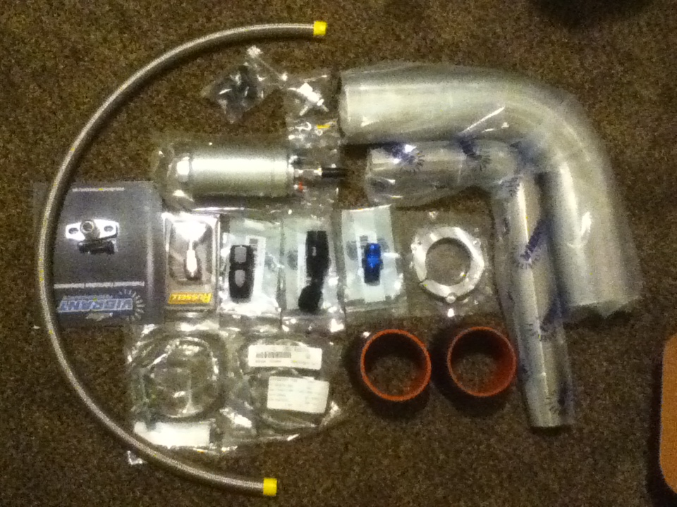

Ok finally back from fighting fires all summer. Gone almost two months straight. I got a little time to open up all my boxes of ordered parts. Got to get the house ready for winter so I haven't had any time to work on the car. I do believe I have everything except the injectors for the car which I am still waiting on Hank for those. :bangshead:
Got the 034 Motorsports fuel pump bracket for the 044 motorsport fuel pump various an fittings and steel braided hoses, got my Ecu back from Marc with the 4 bar map sensor installed and chipped for Methanol, 600BHP here we come, and also modified for the RS4 Maf which I still have to rewire. Also not show in the pick is the Aqua mist methanol injection system that I will be installing and running about 15%. I still have to fabricate a stainless steel container for that and mount it in the boot of the car. Still have to fabricate the waste gate down pipe, and exhaust down pipe from the turbo. The intercooler pipes have to be fabricated as well. Lots left to do so I can't possibly make it to BBQ which is a real bummer. I was so looking forward to that this year. :mad:
