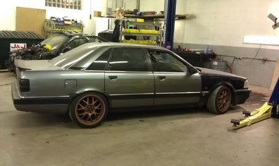

Post by 2.5TYPE44 »
spoiler 2.jpg (20.9 KiB) Viewed 46093 times
amd is the best
Posts: 1431
Location: Schenectady, NY
Re: Josh's 2.5 200QT
Post by amd is the best »
Just so you know, mine is straight from eBay and cost me like $25. It's a universal "M3" style lip that is 50.5" in length.
Nick
'00 A4 1.8t
'91 200 20v
'91 200 20v Avant
2.5TYPE44
Posts: 461
Post by 2.5TYPE44 »
I like it! Very clean look.
