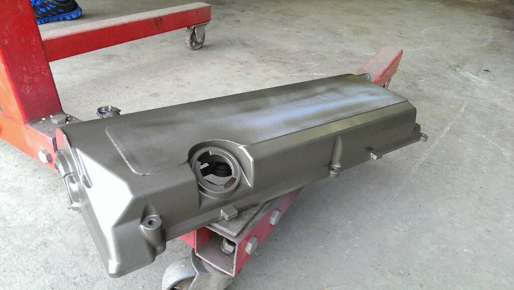

Re: A tale of Rubí...PTE5862 .64 a/r Experiment aka Simple B
Just shot the 1st layer of paint.... I'm not 100% on the color after it's been sprayed on the block.... It's more bronze than dark metallic gray...
Looks good. I don't see any bronze
Thanks.... then it's just my eyes and the florescent lighting playing tricks on me...
I'll shoot 2-3 more coats and save the rest for perhaps some other smaller under-hood items...

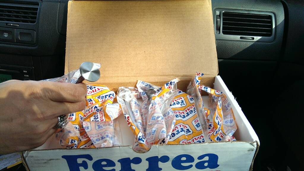

Why the Ferrea valves? Most people opt for Supertech, I'm curious as to your purpose.
My 6 Years in Audi's I haven't really heard of many complain of Supertech but in other applications the failure rate is far more than Ferrea. Though any valve can fail (think tight valve lash ect...), I've heard way more SuperTech stuff break at the retainer meeting point.
The Ferrea 5000 is equivalent to the ST stuff in quality in my opinion and lucky for us they only carry Audi parts in Series 6000 & above...
The gravy on top is that they can be had for less money too...
And now that I think of it I can possibly name 2-3 +600hp Audi users off hand that prefer Ferrea over ST eyes shut any day too, but it's probably a mute point to name them...
The down side to going full Ferrea is ultimately the cost as there springs and retainers are a bit more than ST and need to be used in conjunction with each other.
In the end, I'm just going with what I'm comfortable with...
HTH

Ok... Let me put this behind us once and for all... I got a full +.5mm oversized intake and exhaust set for $300 shipped...
How ya doing now?

I prefer Ferrea as well and will be using their parts I think. I like that they are in FL and they have a very good rep with lots of engine builders.
A quick chat with one of my shops revealed that the general consensus is that while the inconel Supertech valves are technically stronger in theory they have a tendency to snap rather than slightly bend as the "special alloy" Ferrea 6000's have been normally found once inspected. In life this usually equals a saved engine.

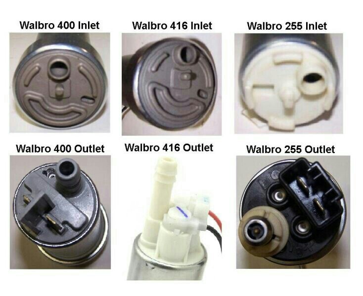

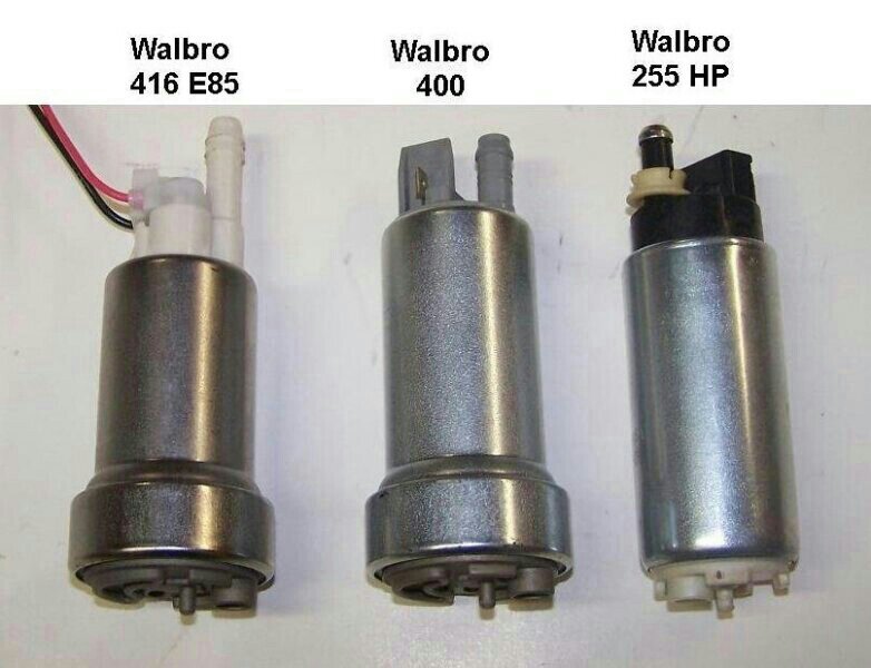

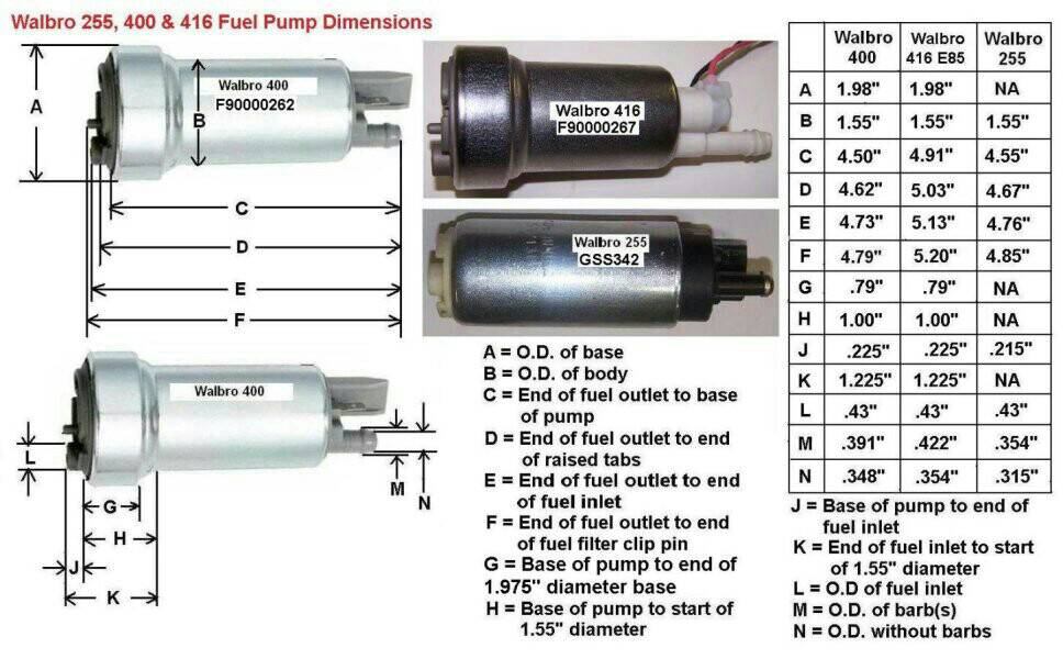

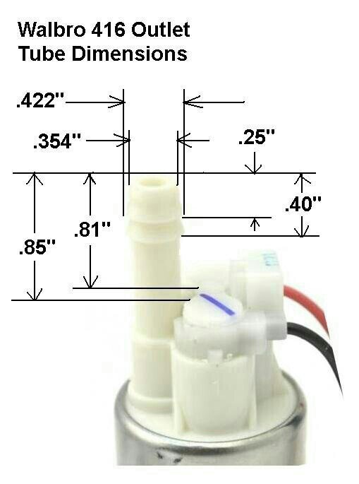

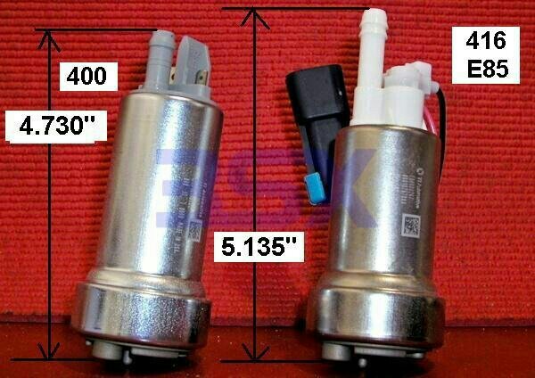

Thinking of running the new line of Walbro (Part #F90000267) as I'm running a stock pump at above rs2 levels...
Seems like there is a packaging constraint I may encounter...
Quoted from Walbro:
"Due to the specifications of this fuel pump, please take note of the following:
The larger diameter at the base of the fuel pump will prevent this from being an OEM drop-in replacement on most applications. Modifications to the mounting bracket, wiring, and connector may be required for proper fitment. We recommend 14 AWG wiring to account for the current draw this pump has.
Technical Pump Specifications:
Overall pump length: 121mm
Main Housing Diameter: 39mm
Lower Housing Diameter: 50mm
Fuel Inlet Diameter: 11mm OD
Fuel Outlet Diameter: 11mm OD
Flow rate: 400LPH @ 40PSI
Test Voltage: 13.5 Volts"
The stock pump is about 43mm, so the top part of this pump should slide right in. The base, however, is where I can't remember if there was enough room down there from when I did an 044 in my previous car.

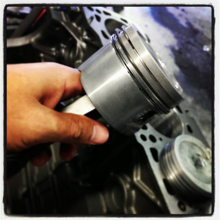

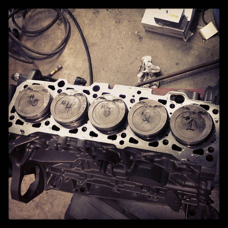

Anyhow, some assembly got done today on the block... I wanna emphasize on "some" because it would've been done had the oil squirters had been picked up with the block... I had sort of rushed in and out when I picked it up...
Oh well here are some pics
DM Forged Assembled
DM Forged Assembled
Pistons Resting on Block

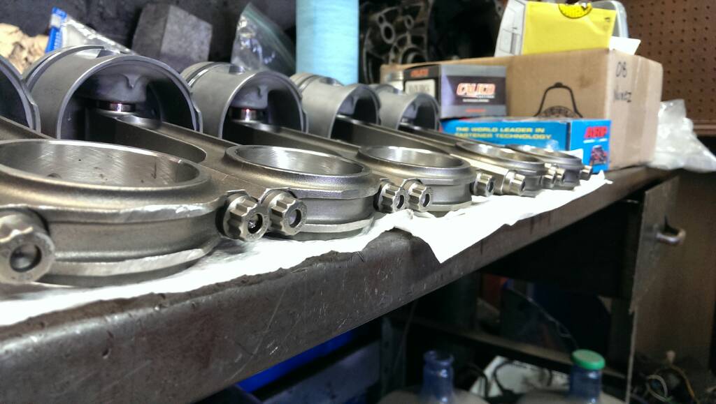

With Rings ON
With Rings ON
Some balance correction marks on the rods...
BigEnd Corrections
BigEnd Corrections
