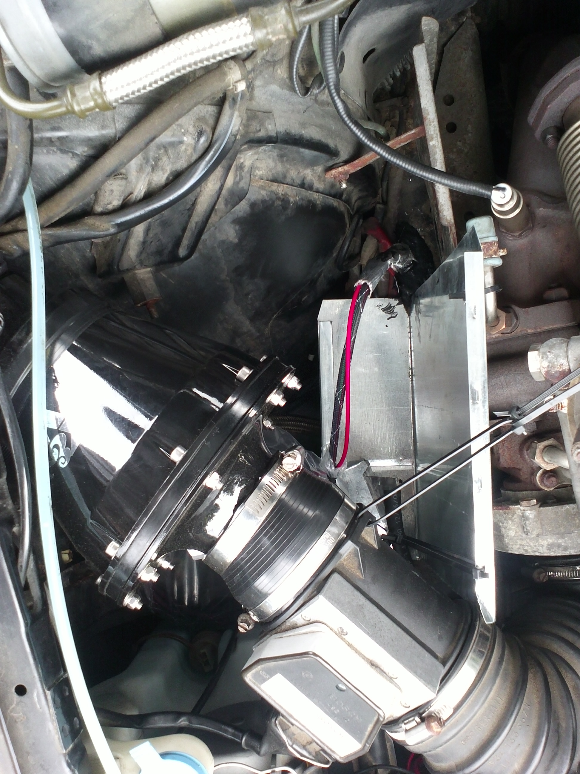

Here's the filter in question, its about 3/4" smaller diameter than stock turbo inlet hose. Its HP restricting on turbo cars somewhere below 400. If anyone else out there has VEMS tuned for the k24 please let me know! I since removed the crappy heat shield I made so that's not rattling. I really need help on my ignition table too. Thanks all
- IMG_20140719_115128.jpg (1.22 MiB) Viewed 46082 times
Easiest way to find out of its being a restriction is to just take it off! You wont hurt anything doing that. As ricer as it looks, I dont really believe it is restricting anything.
