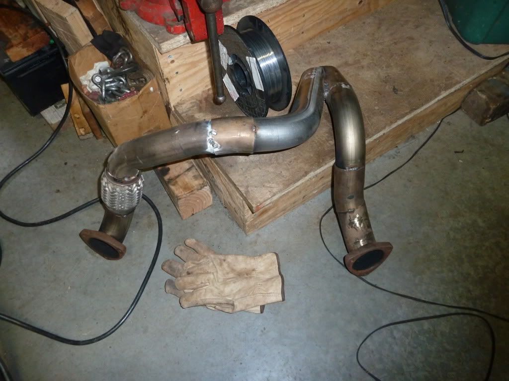

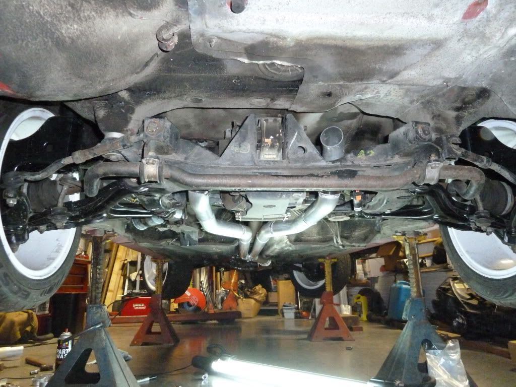

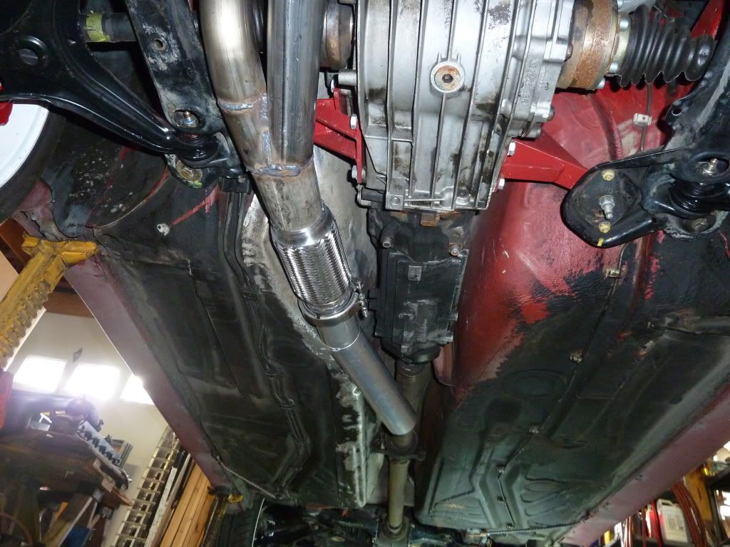

On friday Derek brought over his skillz and some tools along with some materials and started makin the exhaust for my car. Up until now the exhaust only consisted of manifolds (DUH!) and tacked together downpipes just to keep things from catching fire while we tried to get this beast to run.
While having a nice loud V8 is really awesome, it needs to be a little quieter and have a full exhaust. The plan we started with is to have the down pipes merge into one pipe witha flex pipe and then go from there out to the back. I'm intentially being vague right now because it's not done yet and I want the final product to be a semi-suprise.

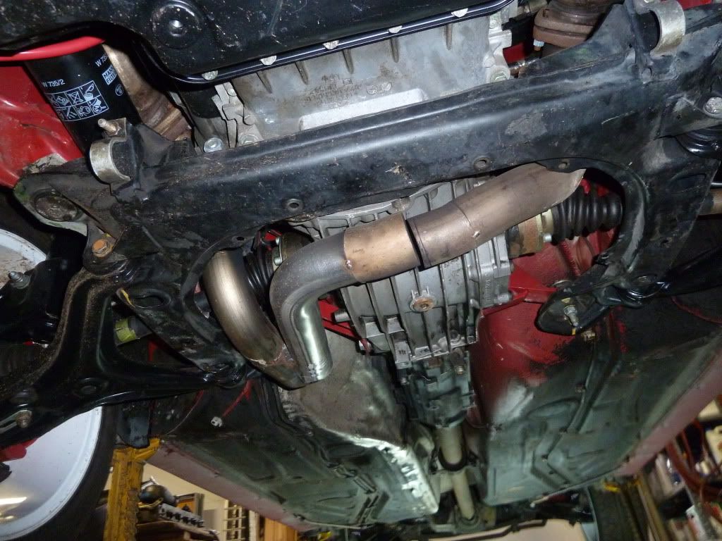

Started off with finishing the downpipes (for now) by welding them up, installing the o2 sensor bung, and welding on the flex pipe with a v-band on the end. The driver side down pipe has a flex pipe in it so the down pipes can be one peice(think removal/installation). This is made from peices of the original down pipes and down pipes from a 2.7T. Pre cat delete.

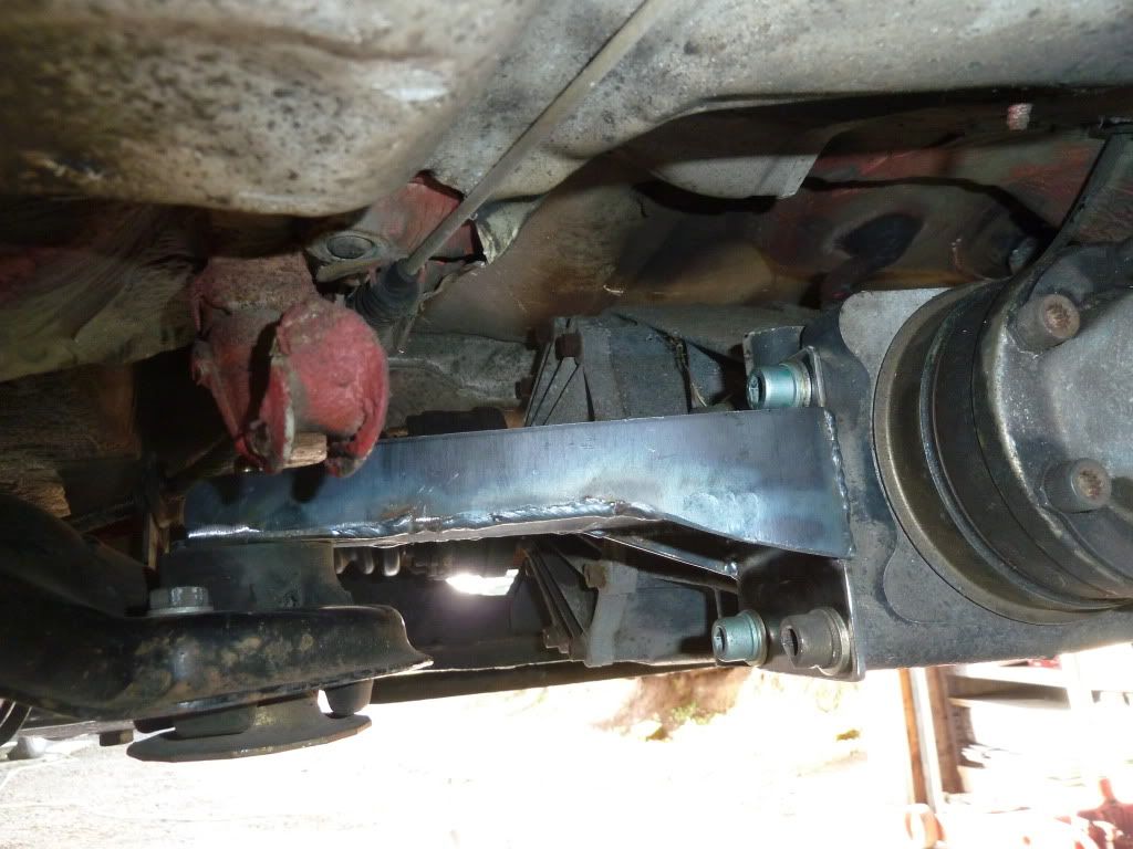

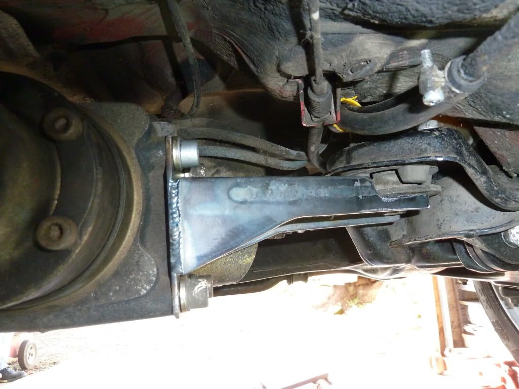

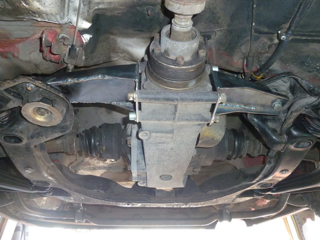

To complete the rest of the exhaust the bulky cast alluminum rear diff mount brackets had to go. So they were ditched and replaced by some streamlined steel plate peices for much needed clearance.
I'll let you guys guess for now where this exhaust is going until it's done in a couple days and then I"ll post up pics of the finished thing. Uploading video to youtube now... i'll post it in the mornin.

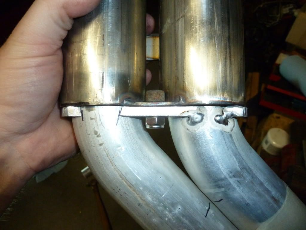

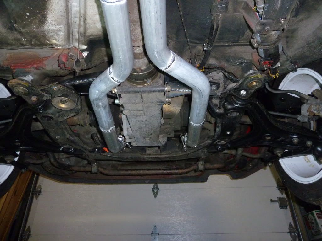

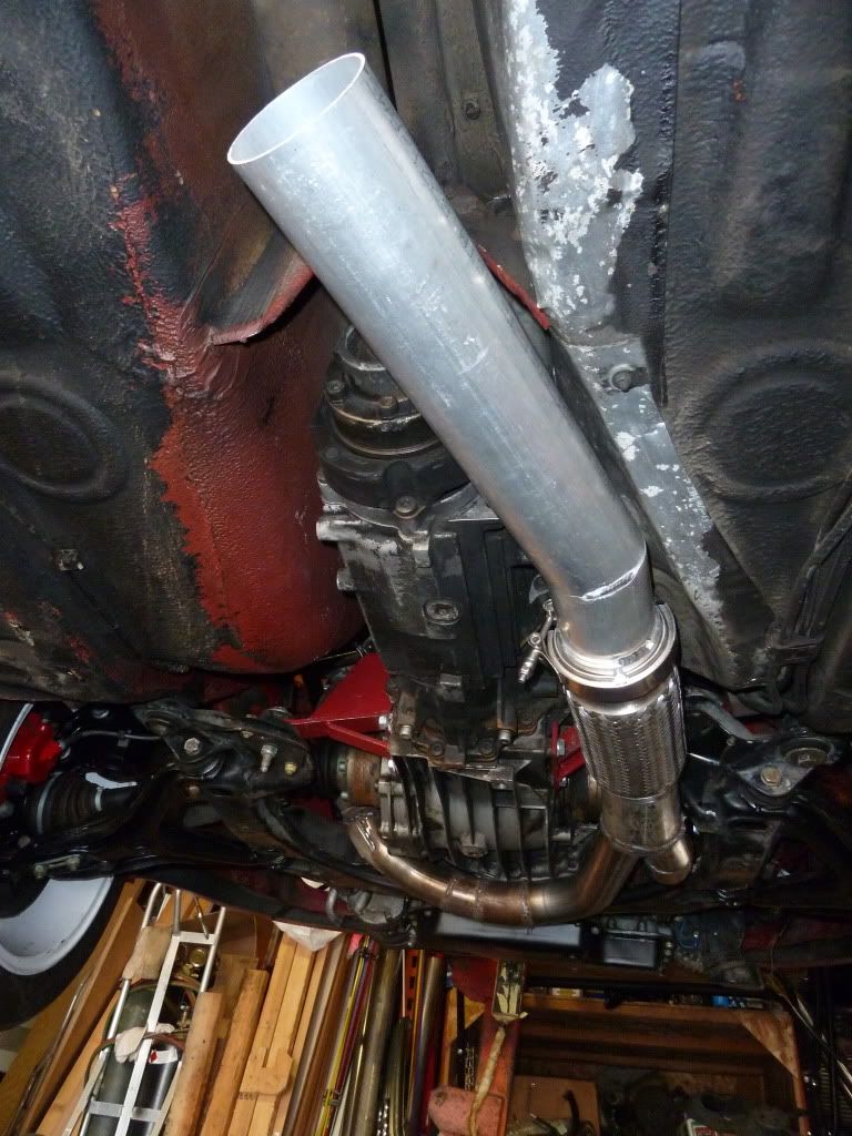

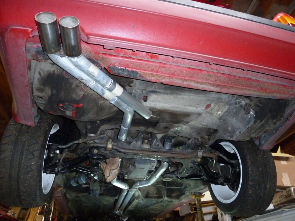

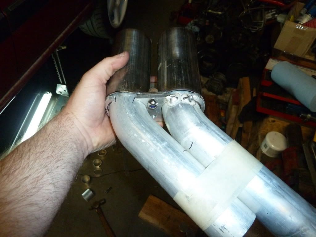

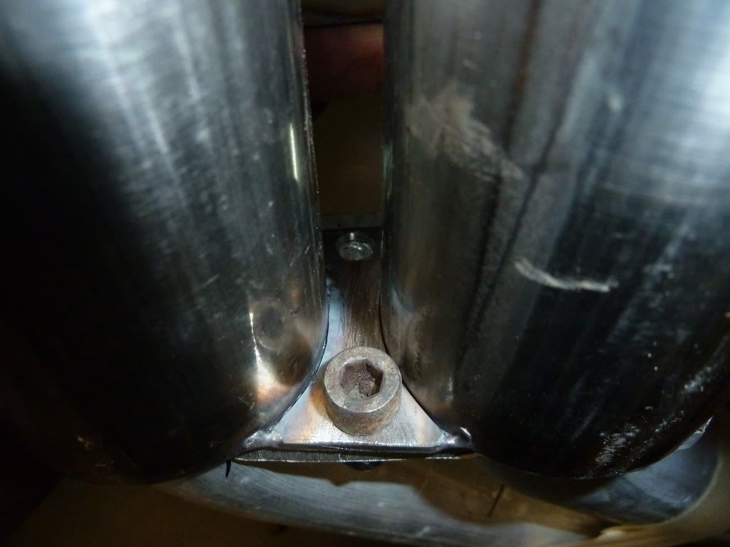

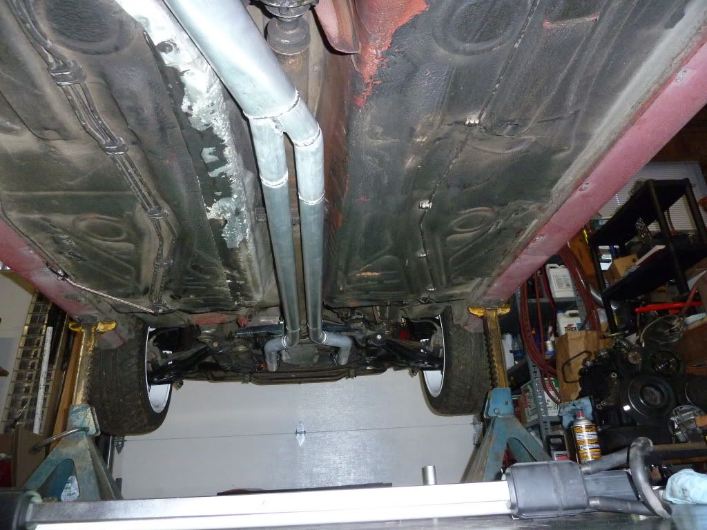

Well, this exhaust has taken longer than expected to finish so getting it done over the weekend didn't happen as we had planned. The center section is done, and the rear section the goes from just behind the axles over the subframe to the tip is half done. Just need to complete the right side, add some braces between the center section pipes, throw on a couple hangers, and that should be the end of it for now.
This will get finished later today when D comes by to weld up the last few parts. Sure is nice to have such a good friend with with his type abilities and a TIG welder :D
Later on the down pipe will be pulled off and get a little grinding to smoothe it out just a little and then either wrapped or ceramic coated. I'm on the fence right now but leaning towards coated. I just need to look into the cost of coating first.
